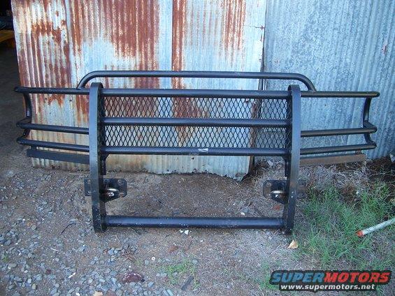

so today this guy gave me a cool idea on how to mount the brush guard on the truck
i know it looks rusty, once i get a chance ill clean everything and paint it black
first this is how i raised the front bumper. a relocation plate welded on top of the oem mounting tabs
now since the brush guard didnt fit at all with the body lift, we decided to run a couple 2x2 pieces from under the frame to the front of the truck, mount a thick diameter tube so it will work as push bar. i might add a tow hook, but the structure itself is pretty tough, so i can just tie a rope there and get the truck pulled.
2x2's tacked to the frame
push bar
i hope it will protect the radiator area in case of an impact.
mounting the brushguard
we still need to tweak it a bit to get it 100% leveled. but its deff stronger than the old mickey moused brackets it had.
i want to add an extra tube on top of it like this:
on top of the head light protectors
and a 1 1/2 inch plate/strip on the main steel plates to cover the edges
