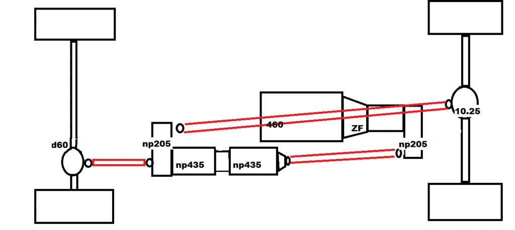

ok, so after reading through this beast of a thread two time :headbang: I wanted to ask to be sure, is the first t-case is flipped with no shaft coming out for 4wd? (did you leave a stub in there or did u make a block off plate for the old axle seal?
Also, could you go into more detail with the machine press and weld of the driveshaft to input for the transmissions? I am working on a similar project (though not a doubler underneath just a single in the bed to a single underneath with 2 transfer cases) and wanted to see what additional light you could shed on that topic for me (I was gunna do the short way of taking the clutch input and welding that )
One last thing.. lol. I read earlier that you said that the truck is RWD until you go into 4x4, but since the FRONT shaft drives the double tranny, and the front most 205 is flipped, wouldn't it be a FWD truck until you put the second 205 into 4x4?
on the first t-case,the rear output was left on.both cases are twin-sticked,so the front and rear outputs can be controlled independently.when in 2wd,the second case has what used to be the front output-now the rear,engaged and the other in neutral.the first case the rear output just stays in neutral all the time.
