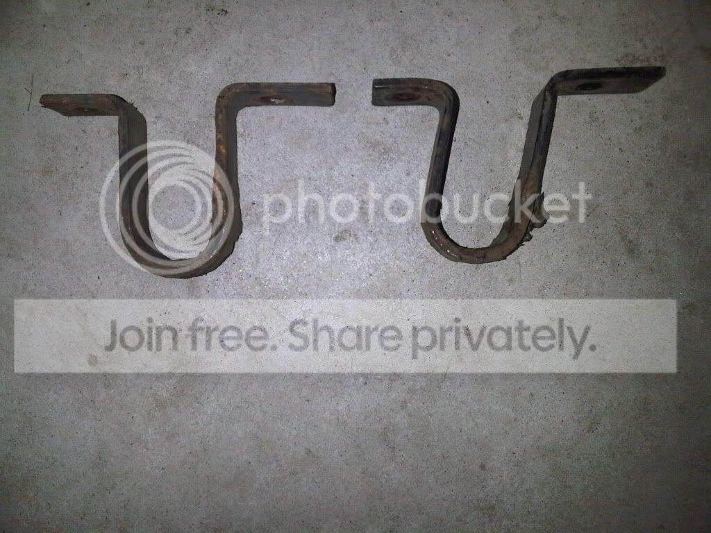

I went to install the front sway bar when I noticed this difference between my front two sway bar brackets:
Ranger lean revisited
So thats it, there you have it, the whole reason for my lean! It was the sway bar bracket that is all bent to hell. Makes perfect sense if you think about it; this bent bracket would put one of the front sway bar links at a higher angle than the other which would force the truck to lean.
I'll bolt in my front sway bar for the winter in a few months (with a new bracket) and it should straighten out that last 1/2" of difference (which really isn't noticeable to me anymore)

jk. glad you got it figured out. hadn't seen the sway bars as the culprit before so it's a new place for folks to check when their lean is excessive like yours or when they start to get tippy in the turns. :icon_thumby:
