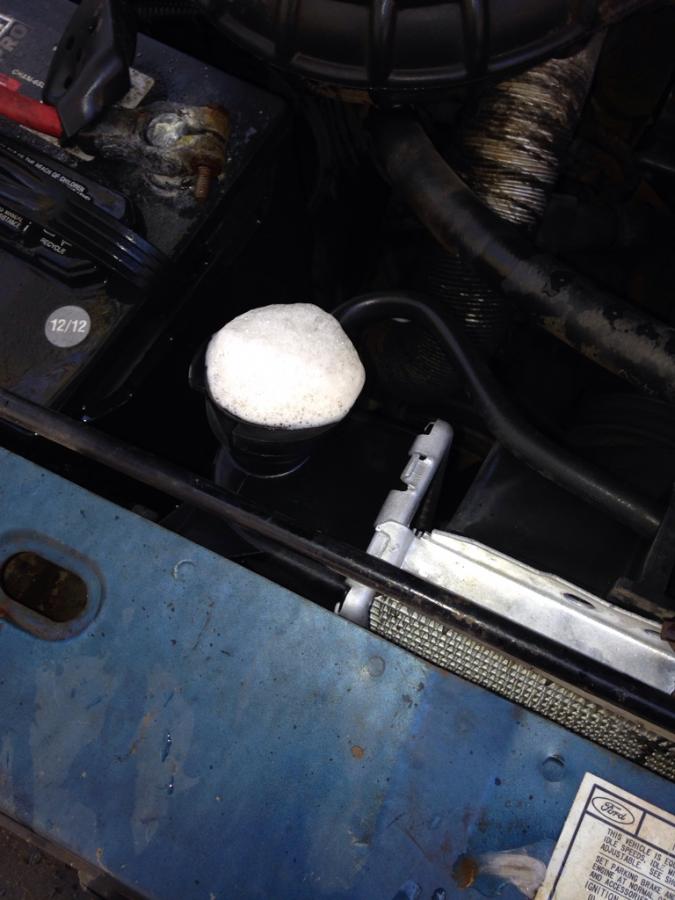

ImageUploadedByTapatalk1414352504.146214.jpgi got ui up to temp put water in it and this is what it looks like

View attachment 16926i got ui up to temp put water in it and this is what it looks like
looks like head needs to be done but still do glove test
