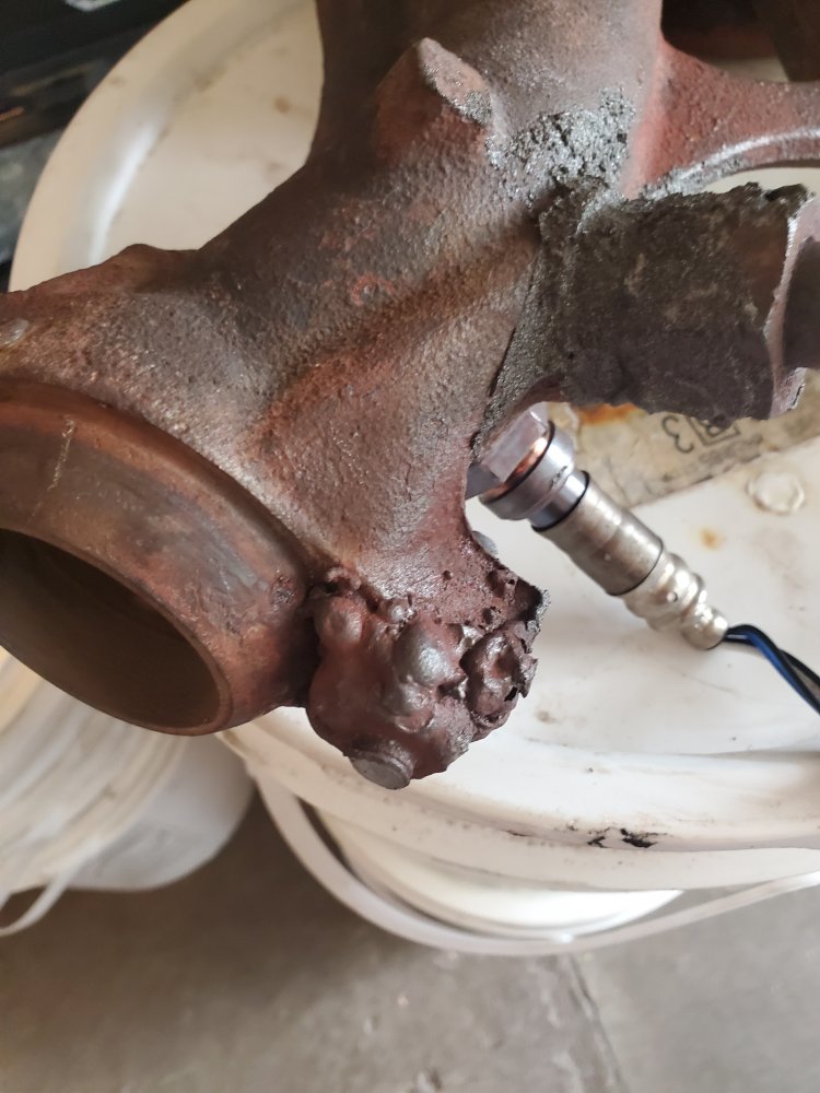

Im not home but i Think its called quick max or something like that, essentially a liquid weld i packed into the crack and than layered a 1/4 in thick Over it and shaped it to conform to the manifold. Says it can be sanded drilled tapped Yada Yada after curing, designed for cracks on manifolds and other items. The crack was literally like a hairline fracture, I spread the weld a 1/2 inch out each side of crack and the full circumference of the section where the crack is incase it tries to recrack or spread.

By bolts you mean the two that connect to the rest of the exhaust? And by two, I now mean one since one just snapped off halfway tight 🤣🤣 looks like someone did a very poor job but welded the bolts on to the manifold, and by weld, I mean a massive tumor on each one 🤣 i forgot i have another manifold sitting with my other engine as a backup, gonna see if it matches up, its for the 2.3 I rebuilt. I'd assume it would since the only difference head wise between the two is 2.5 is slightly taller, atleast thats what im seeing.

Today's welding lesson: Don't do whatever that is....
