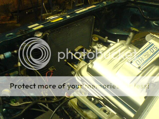

Here's how much I trimmed my core support. Very minimal, you can't even see it now. The extra part on the left is for the cap, and it's easy to reach and remove. Stock 4.0 rad, I removed the AC condenser and rad sits right against the core support. (rubber mounted)

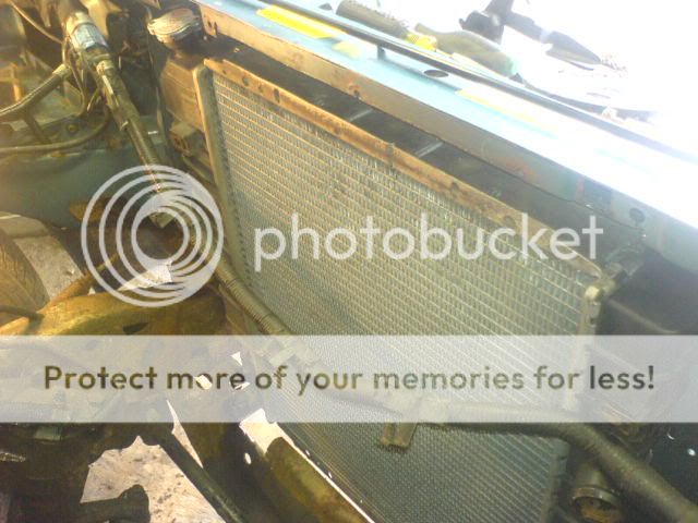

For my year of Ranger (other may vary, not sure) the rad had two small wings on the side, lets say 6" from the bottom. These sat in a rad-mount channel in the core support.
My rad is tucked under the top of the core support, and the little wings sit on the frame rails now. So far, so good.
It's not a new idea, I obviously read it somewhere else.

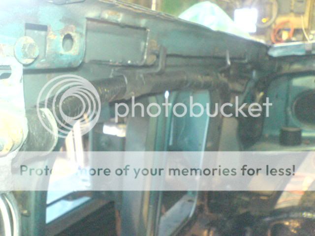

You can see the original rad mount on the driver side frame rail in this shot, the rad now sits in fornt, and below it:
You can also see both in the shot, the original mount and the little "wing" coming off the rad (now sitting directly on the frame):
