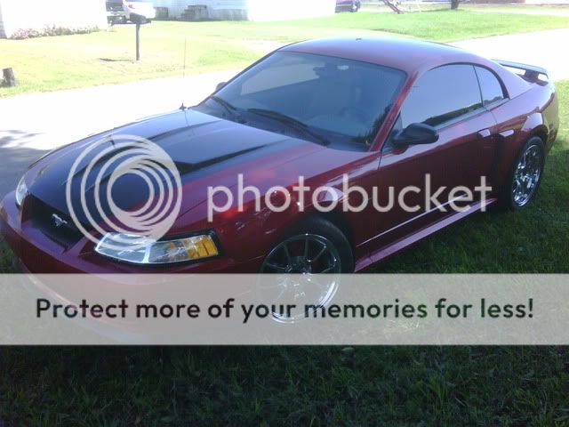

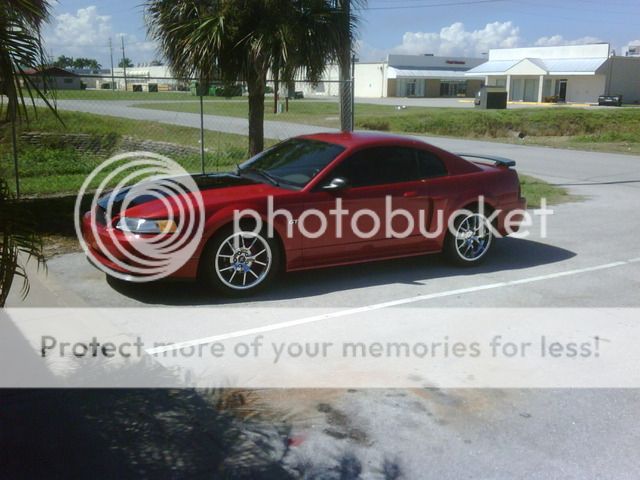

here are a few pics of my baby...have had her for 2 months now...i have the 17" mustang gt's on at the moment...will get 1" spacers all around so i can put the center caps on...i already have the 3" belltech springs but nothing for the front...still looking at the best way and cheapest way to do the rear...
the plans right now are the drop, the window tint, and best of all the 4.6 swap...first i gotta find a nice 5.4 to put in the stang...
and the other car...
