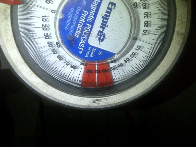

Now before assembling the axle back under the rig again to test my camber correction, I needed to address the middle u joint and slip section. The 2 halves are assymetrical, the diff side half (one that goes into diff) is a high angle shaft, and has tons of clearance, and does not bind, as indicated in the picture below.
Rangebe...version 2.0
You can see there is about 38* before bind in the one direction, however this is of no use, as the outer half (portion with slip) is boxy, and is severely limited, to about 20*.

So, I spent some time clearancing the slip half, and gained another 10*, for a total of 30*.
While this still does not match the other half, it is significantly better. This was made very apparent when I re-assembled the axle again, and cycled the suspension while rotating the pinion. I have MUCH more useable travel now.
