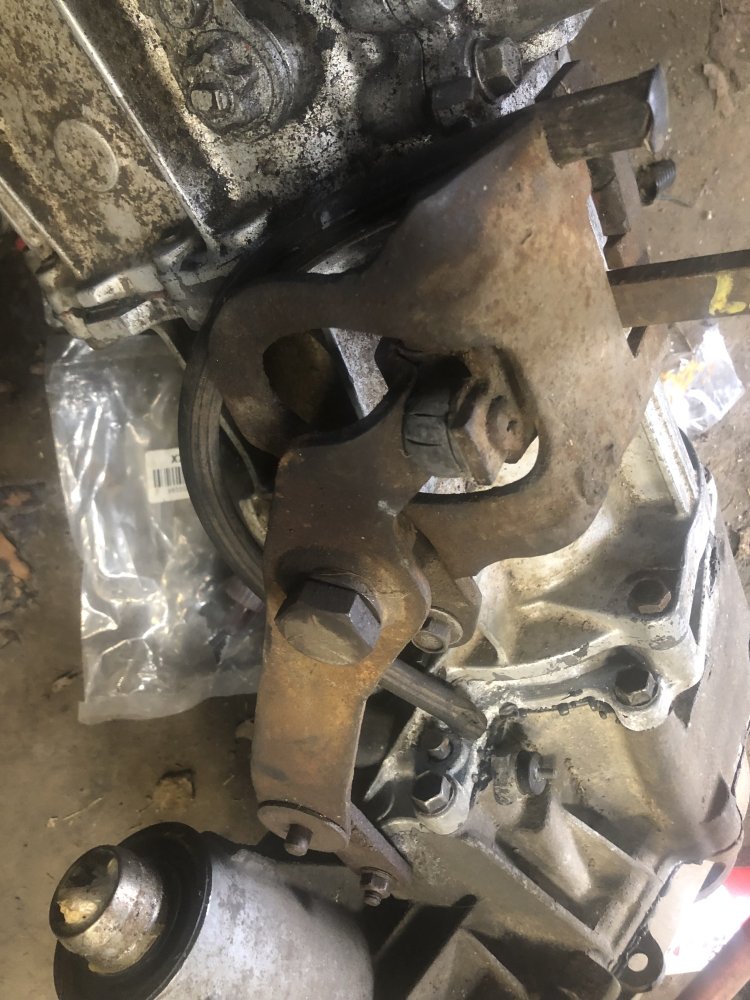

On the 1350 and 1354 manual transfer case it hooks up on the top of shifter bracket . Should be “ U “ shaped
Yes, M5R1 manuals vent at shifter
