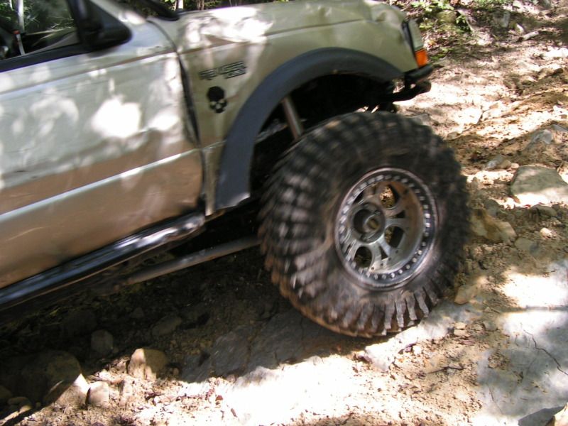

Here's a couple pics of John's truck flexin on SVT so I can measure for shock length..

Good grief man! I leave TRS for like... I dunno, a while, and now you're flexin out on (what look to be) 46" Michies! Loving the truck, buddy! Got some serious rear steer in dem leaves. :headbang:
They're actually 47" xml's, but whose counting :D

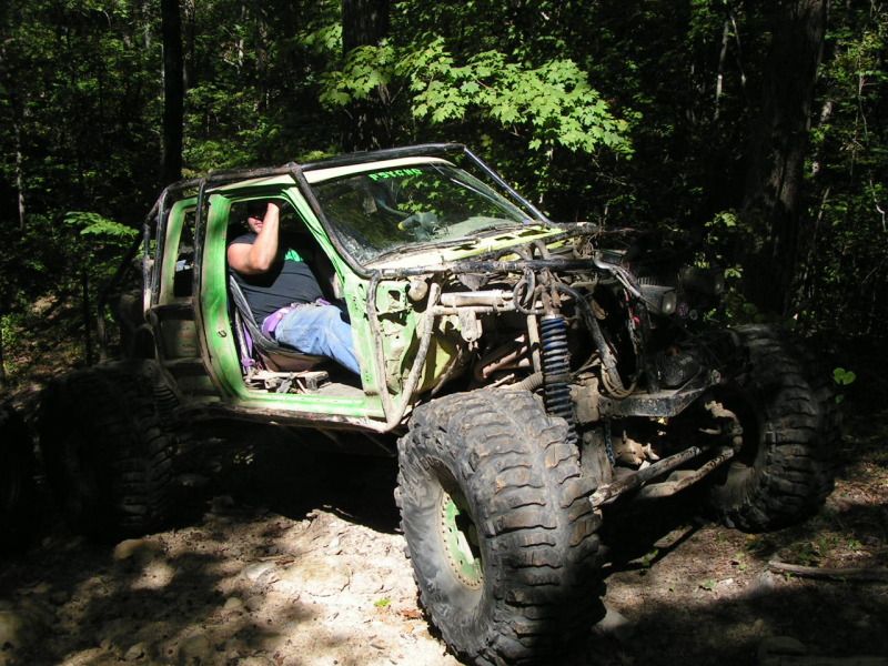

I'm not much of a shutterbug....so I generally don't have many to post...so here are a few of the ones I did take...
we wheeled with some guys from East TN....here are some pics with them...

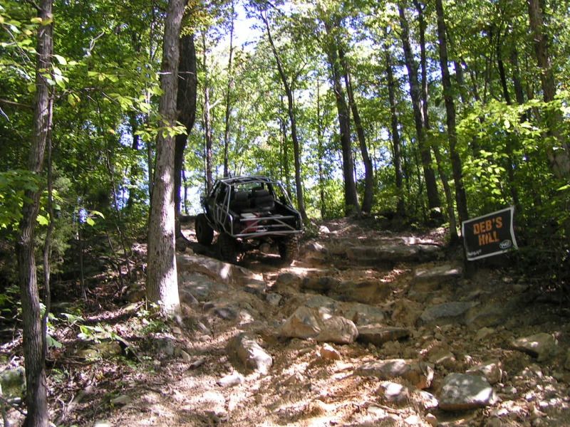

getting ready to go up "Deb's Hill"....

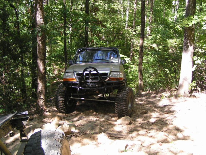

getting ready to attempt "Commitment Hill".....

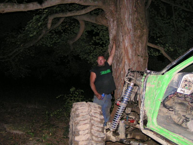

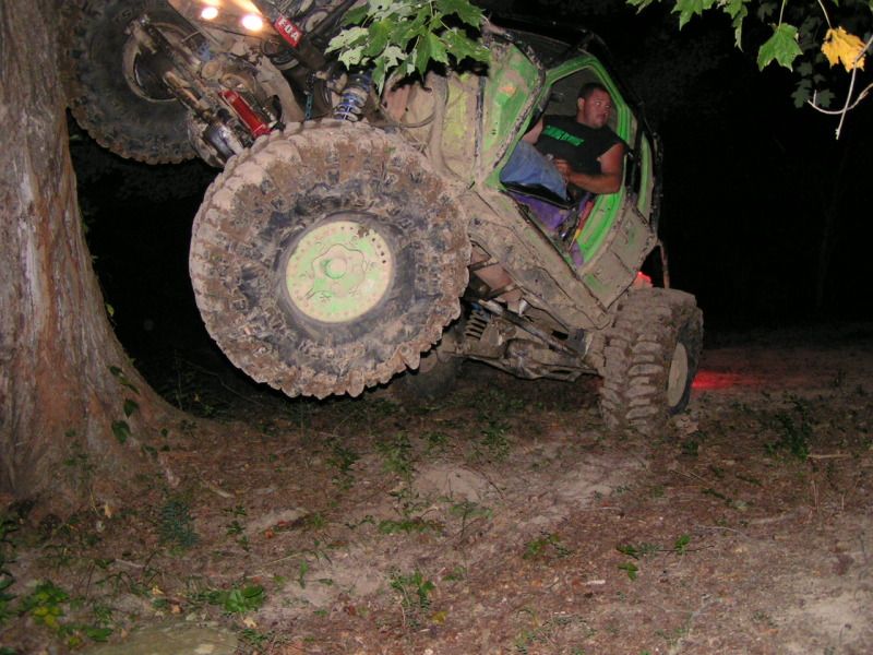

once night fell they decided to try out a new sport....forget rock crawling....try tree climbing :lol: :lol: ........of course this was done with the park owner's approval...
