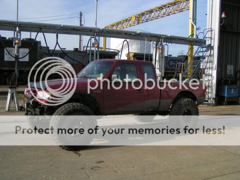

yup....Ex rear leaf pack.....
so far so good.....still measuring 3" from bumpstop to the plate....but, if it starts to sag more than I want I will make a basterd pack with AAL's or cut Ranger/Ex leaves....

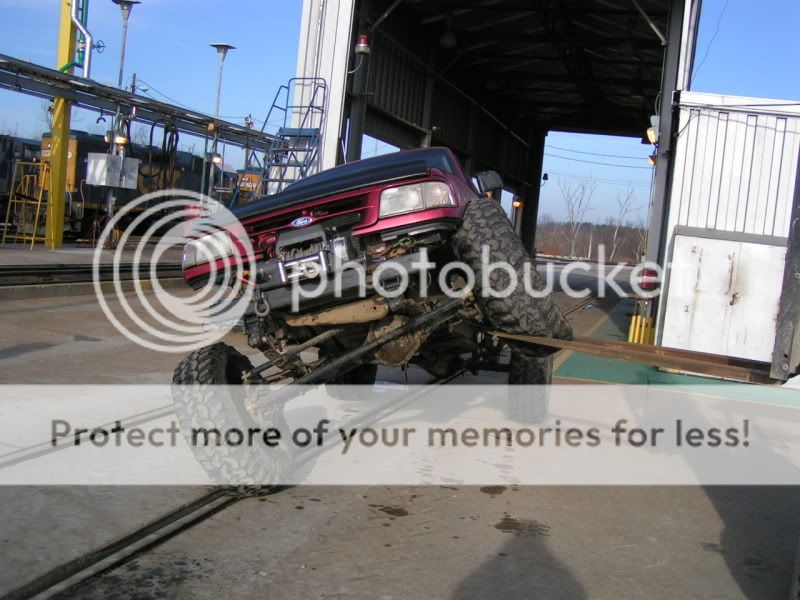

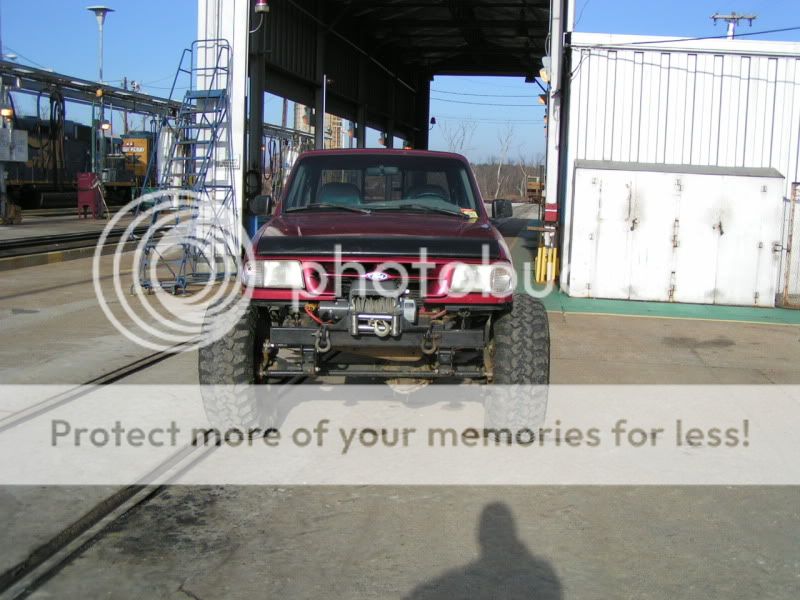

took her by work to get a little flex so I could measure for shocks.....
was actually limited by the tires hitting the fenders:icon_twisted:

so it looks like I need to trim some more fender......

she flexes like a boss dude.. i'm using ranger rear leafs so im guessing it should be around the same flex as yours.
Looks like the driver leaf was getting close to neg. arch. I'd make sure to bump stop it to make the springs last.
I told ya to run limit straps you crazy seaman! :thefinger:

I do have a limit strap on the drivers side.....that is because it will droop down further than the D-shaft will articulate....:D:thefinger::thefinger:

looks like you may need one on the passenger side too! :thefinger:
It only because its too BA for those shackles. They can't handle the BA-ness of that which is known as Railman's Ranger
