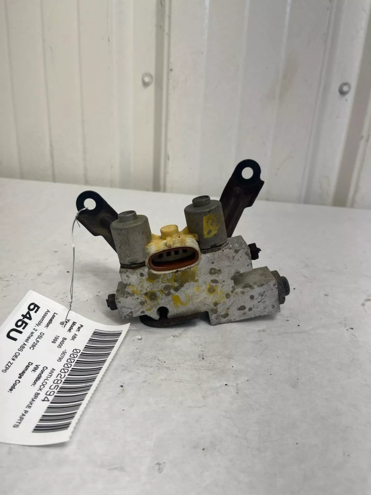

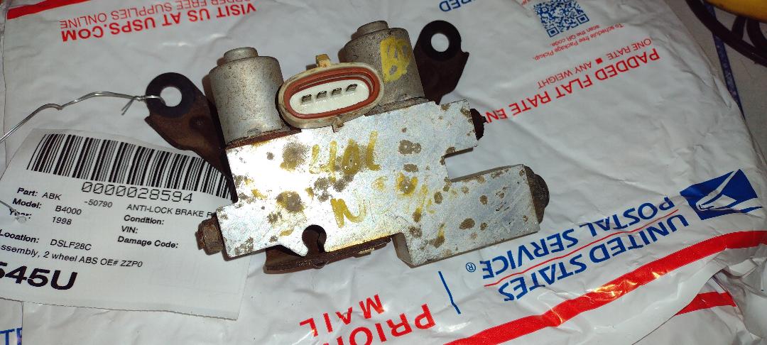

I had seen a use sheet for the RABS valve. When I searched on flea bay they were asking crazy money that was more than dorman.
98-00 MAZDA B4000 PICKUP Anti-lock Brake Parts Assembly 2 Wheel Oe# Zzp0437a0a is what I ordered and it looks to be exactly the same.

Hope this helps with your pick and pull adventures. As simple as this valve is I would suspect that many problems with the ABS light may be improper bleeding. Brake adjustment. Or improper resetting, as was the problem in my case.
This is RABSwhat came in from a yard in S.C. I don't believe the condition. and I don't need it
I wonder if they have other stuff I need.
