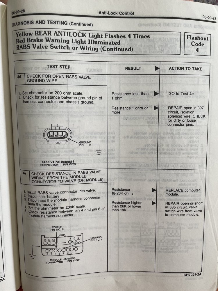

Hey there,
I have a 1990 Bronco II XLT 4x4 that has been edging ever closer to finish.
I've recently replaced the brakes almost in their entirety for the rear and still after bleeding the entire system have both the yellow and red brake lights illuminated and I now have a flashout CODE 4. Regardless of this the brakes feel good but something is amiss.

The red light indicates E-brake is on or switch malfunction / the brake fluid is low in the master cylinder reservoir or that switch is bad / low fluid pressure in the brake lines being either air in the lines or a leak in the system.

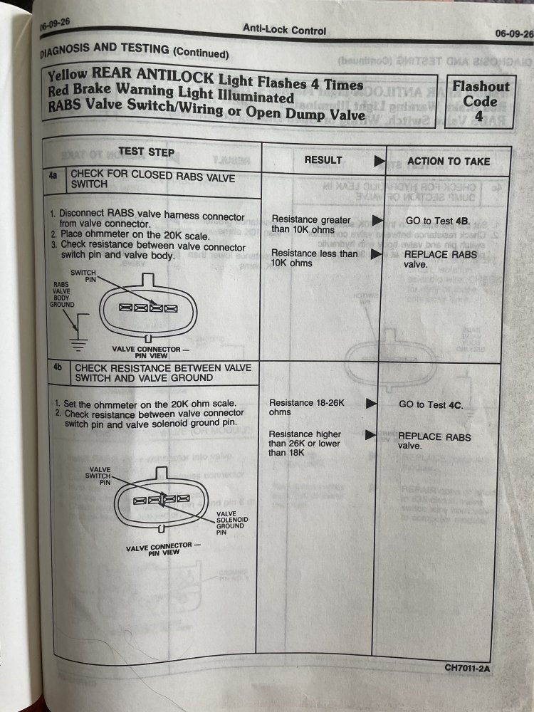

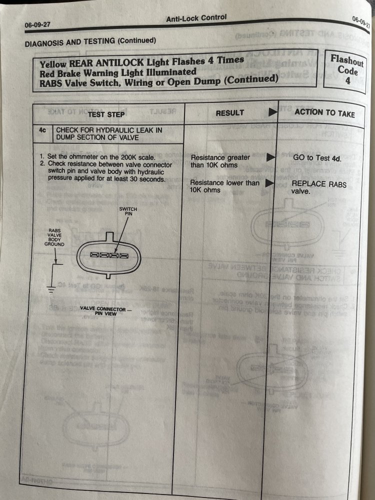

Code 4 for the RABS light indicates that a valve is stuck open/closed or so the book says. This could be the rabs module / wiring / or the valves itself which you mentioned you replaced.
Hope this info helps narrow the possibility's down for you.
Here are the pages for troubleshooting a rabs code 4 from the 89 shop manual.
