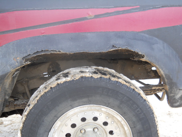

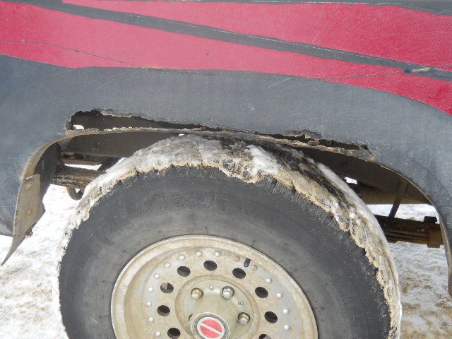

Im going to try and get pictures of the wheel wells and show you. Ther is nothing to screw anything into lol lemme find a camera :P
here ya go. lol see my problem? :/

Flairs will not work unless you put some metal back in to screw it to
I think he is talking abotu getting some of the cut out fenders that are rounded and cut out certain sections. I have been looking too for my truck, they aren't rusted through but are rusting and I was thinking about getting some of those round ones that you put on your fender and cut out the non needed part.

Yes. Basically im wondering if this can be done because as u can see the rust is pretty big. Just seeing if there is an easier alternative to repairing it and then putting on flares later on anyways lol
Well how can i figure out how far up i will need to cut the get all the rust? Would suck if after a year or so the rust showed thru where to flare connected :/
I would say sand it down and see if you can see where the rust stops, and when you cut the fender make sure to clean it and then prime and paint it to prevent it from coming back
You think that the fender flares would be big enough for me to cut out the rust? Anyone know where there are some flares for my situation?
I'm pretty sure they discontinued the cut outs for this style, or maybe it was the first generation not sure. What you want is a set of bushwhacker extend-a-fenders, they don't stick off a lot like cut outs so they won't look goofy. I'll post a pic for you later.
Another option is fill it with expanding foam from the spray can, fill up the holes with that, shape it out to match the rest of the metal, an just polybond that over. I've seen it done I'm ways that you wouldn't even know it was there, others do a shitty job with sanding it. You could also fiberglass it over, that would be stronger probably but not as easy as a bondo job.
