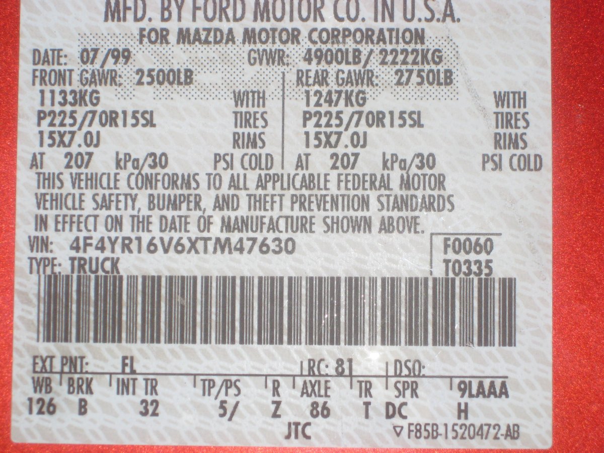

I have 235/75-15 but door sticker says use 225/70-15. At some point I have to get new tires. Is it advised to go to the stock 225/70-15 (I would think so...). Also, any recommends for brand/type? Since it's not 4x4 it's pretty useless in the snow so just a decent tire that is good in dry or rain is fine for me. Thanks.

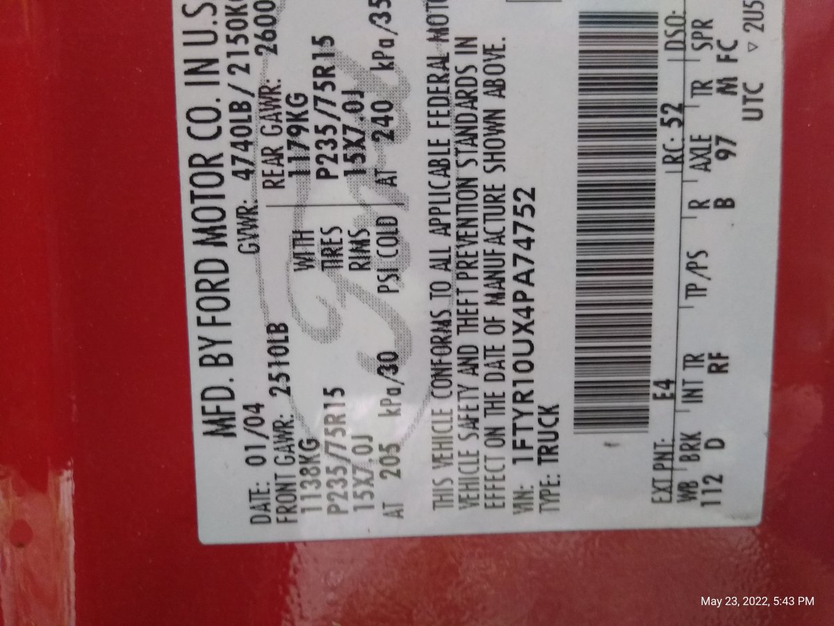

Your says the lower size though? Mine says the 235 on the door sticker

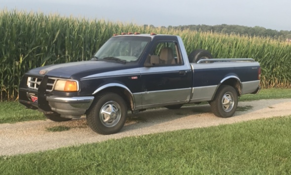

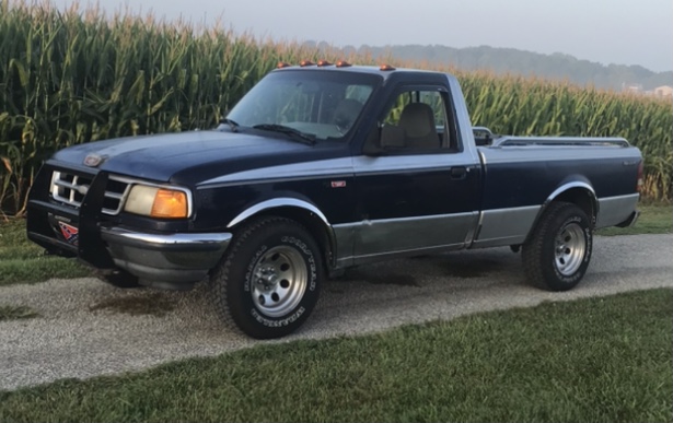

heres mine with 225/70’s & 235/75’s. Overall my performance & fuel milage is a little better with the smaller tires, Im running a 2.3 (lima) , manual transmission & 4.10 open. Originally it came with 225/70/14’s & a 3.45 rear axle. The 235’s do look better but given current gas prices Im running the slightly smaller tires to get a little better fuel economy.

@superj thanks for cool calculator here is pic of my door sticker differences are the year and "make" (Mazda) though it says of course right there made by Ford gross weight a bit diff also mine is extended cab that might be the diff there

Both sizes are factory sizes.
The 225/70 is a 2wd stock size and the 235/75 is a 4wd stock size.
