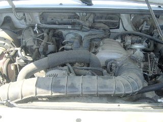

heres a picture of the 4.0 in my '93 ranger, im not sure what the 3.0 looks like in comparison, but maybe this pic will help.

the 3.0 of that era does look similar. Also his truck has auto trans and NO tach.

The 3.0L from 93 looks like that but the intake has kind of a curve to it and it has 6 distinct runners to the lower intake, they are one after another like a washboard.
Also quite obviously the oil filter will be on the left side of the engine and visable from the top and the 4.0L has it in the same location as the 2.8L/2.9L on the right side below the exhaust manifold.
