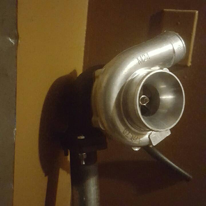

This will be my build thread. This is the turbo ill be using.

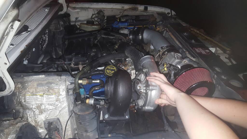

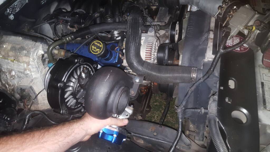

This is about where it will sit
Waiting on my oil feed line and fittings then i will start messing with the trucks exhaust

Mounting it backwards makes things simpler

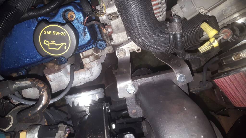

this is the mounting bracket ive made
i will be adding supports between the two pieces and another bar going down into a pocket in the alternator bracket so it wont bend. The turbo is mounted high enough to drain into the valve cover and low enough to clear the hood.

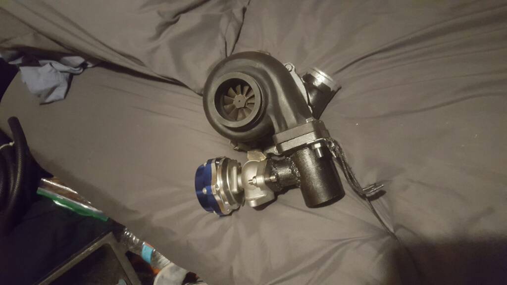

And the wastegate will be directly under the turbo
Sent from my SM-G920P using Tapatalk
Wastegate is welded on, just waiting on my block to feedline fitting, it got backorder twice on summit so i finally called and switched to a different fitting which got shipped out today.

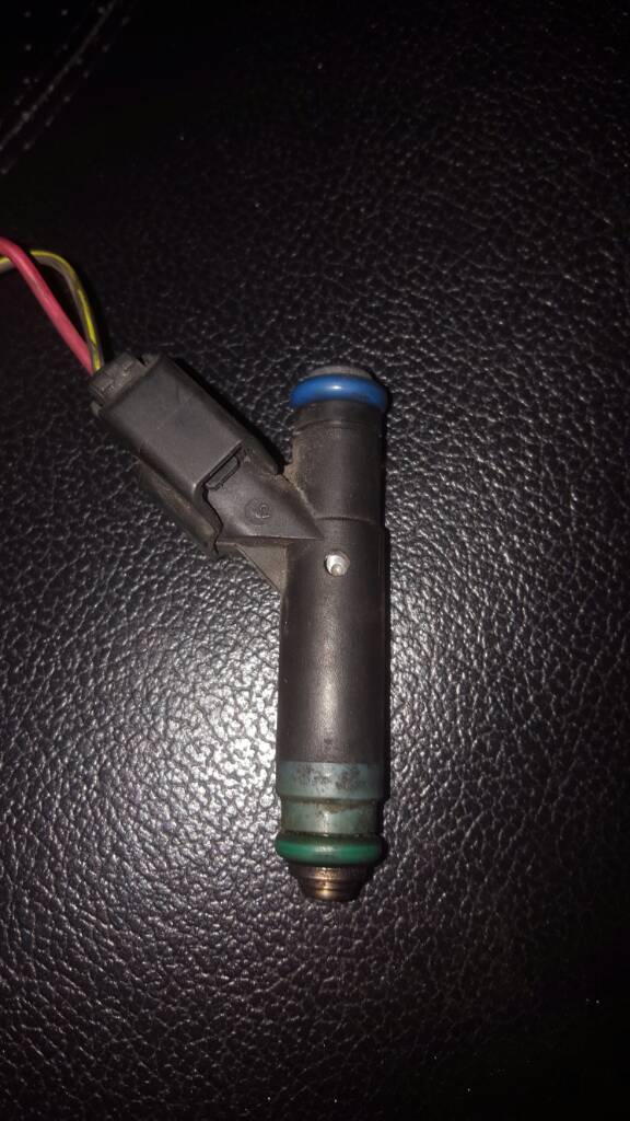

Picked up some 24# injectors the other day

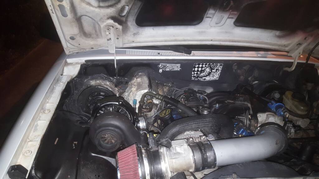

Okay so alot has changed since I started making parts for this build and it's been a really long time, but it is now a bed mounted turbo with it's own oiling system which makes me happy. I am also on going to run 3-4 psi because reading more about people turboing 3.0s has got me scared, and about 30 more hp will make me happy. I've already blown an engine once stock, but it was at 240,000 miles or so. Here is a video of me testing my oiling system and the turbo itself for the first time. It was not hooked to the intake yet, and will not be sitting that high when it's all said and done.
