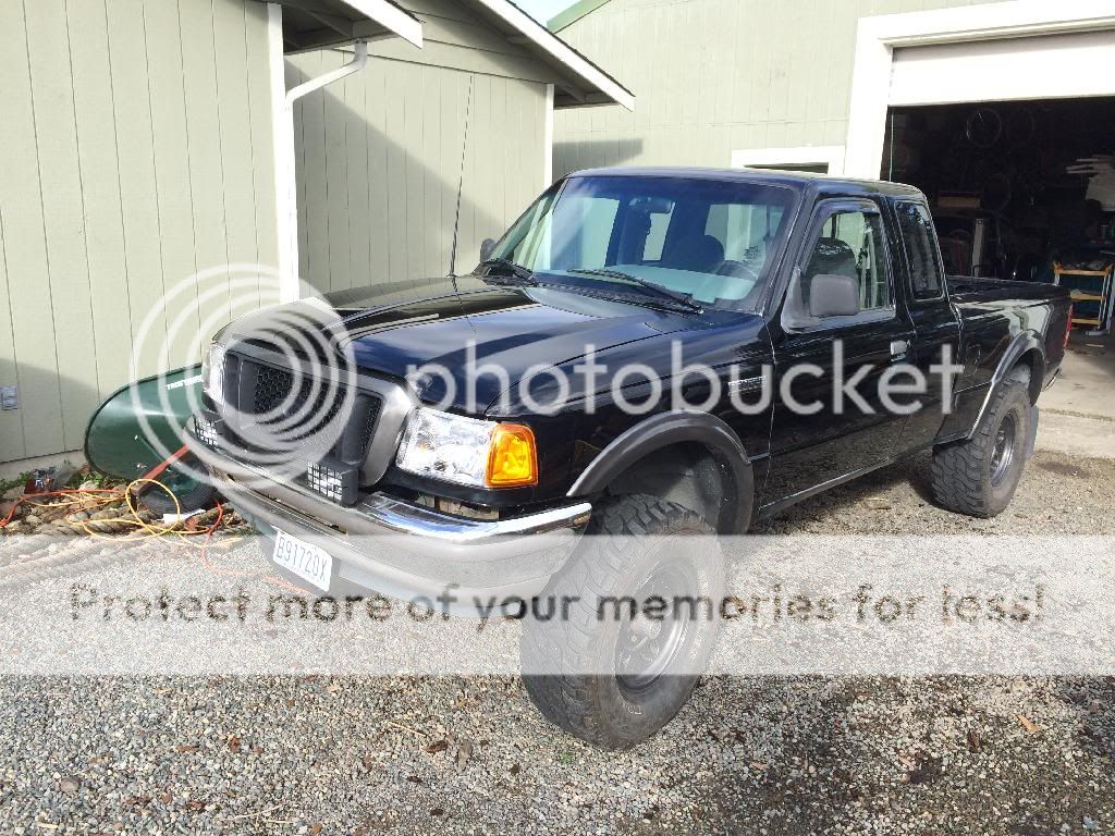

Nice swap! For what it's worth, the factory 93-97 bumper WILL work with a nose swap like this.
I just put a 2004+ nose on my 94, and used the factory bumper. I doesn't match perfectly, but close enough to not look too out of place, because the bumper does have a dropped area right where the grille happens to be.
It could be moved up more too, if it weren't for the off-road light brackets, and my lazyness.

Bumper lines up fairly good actually.
Did you swap core supports to go to the newer clip or did you just modify the header panel?
I used the 93-97 core support, because I didn't feel like messing with the radiator, condenser shrouds, and body mounts.
All I did was remove about a 3/8"x 2" flang from the fender by the core support (right infront of the top fender bolts) because the older core support is just a tiny bit either too long, or too tall, compared to the 98+ trucks.
Then for the hood latch, it had to be moved to the left about an inch, and up about 1/4". All I did was use a piece of thick sheet metal, and bolt it to the old holes, then use 2 J-clips to bolt the new latch to it. (I used a latch from a 98, I'm not sure if they changed after that)
As for the header, I just modified the exhisting mounting brackets.
I also had to take a sledge hammer, and hit the coresupport at the edge of the headlight access hole to make room for the new headlight location.
I should have taken more pictures of the swap... Maybe I'll do that and post a thread. It really wasn't very difficult of a swap.
After looking at the tech library, there's already a write up. About the only thing I see that I did differently, was the hood latch mounting.
And the lower fender brackets (L shaped pieces), you DO NOT need new ones. Mine worked just fine. I'm pretty sure they ARE different, but close enough to work.

Maybe snap a few pictures of the way you did it for reference. Your swap came out super clean from what I can tell
