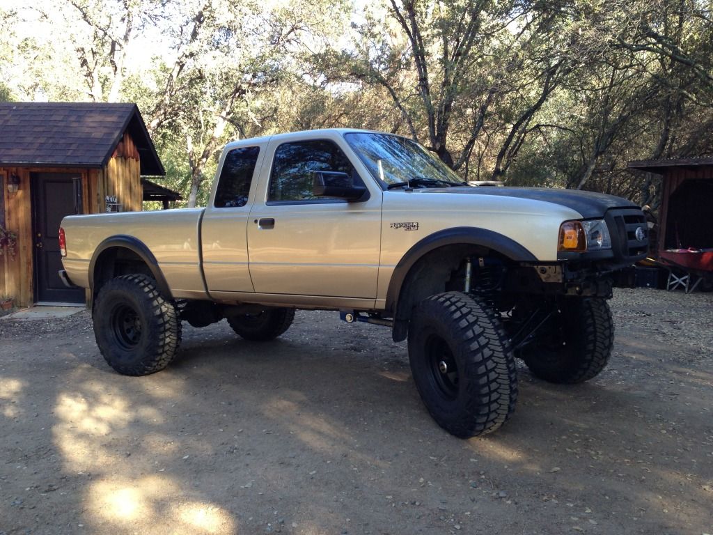

Ever wanted a newer Ranger cab, with the swing out rear doors on a twin I-beam equipped frame? After all it is much easier to swap in a solid axle on the earlier frames since they were already set up for coils than the torsion bar Rangers. Best of both worlds!
Disclaimer: The Ranger Station.com, The Ranger Station.com Staff, nor the original poster are responsible for you doing this modification to your vehicle. By doing this modification and following this how-to you, the installer, take full responsibility if anything is damaged or messed up. If you have questions, feel free to PM the original poster or ask in the appropriate section of The Ranger Station.com forums
This is a detailed how-to on swapping cabs. It is no easy task. However, no one part of the swap is overly difficult, it does take a considerable amount of work (especially the way I did it, which was the hard way and I'll get to why that is in a bit). I had somewhere in the realm of 55-70 hours into this swap. Working mostly in the evenings after work and school. I took 3 days off for the final swap and button up. I worked about 10 hrs each of those days. I am not the fastest worker but I cataloged and took many pictures and labeled most nuts/bolts & parts. So it could be done faster.
I chose to swap on a newer cab for a few reasons: swing out rear doors, bragging rights, and the ability to change the front clip to the 2004 or newer style headlights and grille.

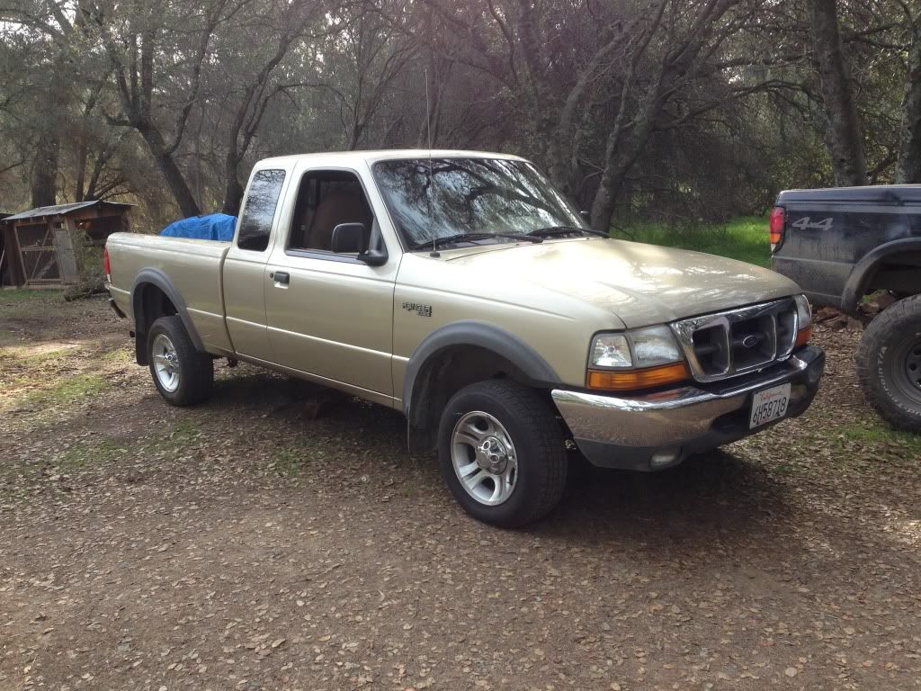

I chose a donor Ranger that was very similarly equipped to my then current 1996 Mazda B-4000. I bought a beater 2000 Ranger with straight sheet metal and decent interior. It had the 4.0L V6, automatic tranny, and electric shift t-case. It wasn't identical though so that is why this particular swap was difficult. I had to retain the interior electrical harnesses and dash harness (but didn't want to swap dashes since then my interior would be two tone beige and grey). I recommend getting a donor truck with the same color interior. That would have save a lot of time and headache.
Donor truck:

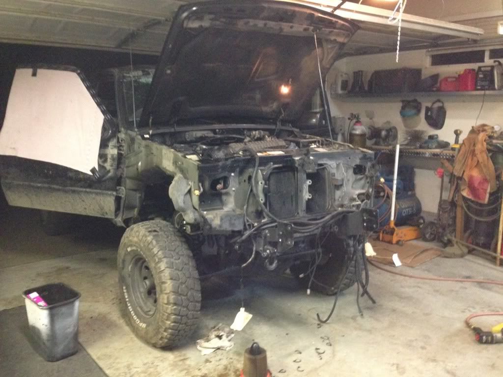

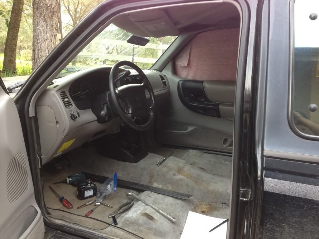

First step, strip the Mazda interior, then the front clip:
Putting a 1998+ Cab on a 1993-1997 frame
Basically, I had to remove everything from the interior of the Mazda. This would not be required if swapping cabs that where of similar generation. But since I was retaining the 1996 drivetrain, I had to swap the interior electrical harnesses also (three total).I also took the doors off to reduce weight.
Once that is done, move to the motor bay and un-hook, un-bolt, and remove anything attached to the cab, firewall or interior so that the cab can be lifted off. This can all be done without losing any brake fuild, just un-bolt the master cylinder from the firewall and zip tie it up on top of the motor.
The A/C however is a different story. While I suppose it is possible, I chose to un-hook and have the freon vacuumed out. This was done to get the blower motor assembly and accumulator removed from the engine bay. Would be extremely hard to get the cab off without doing this.
Remove the radiator, condenser, ect. Strip the front fenders and front clip off. Makes everything go a lot smoother this way. Label all nuts and bolts, clips and electrical connections.
Un-bolt cab mounts (6 total, probably rusted and probably seized. Use heat and an impact gun).

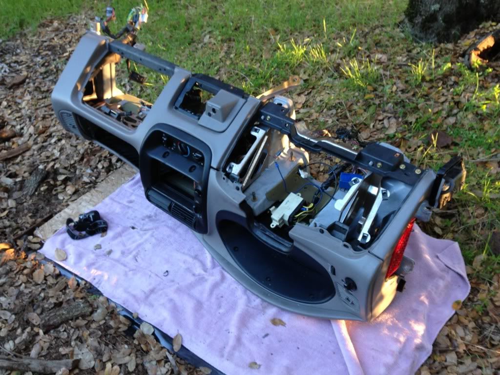

Remove dash. Google search on how to do this, there are some good articles out there. It is quite involved but not very hard, just tedious. I won't cover that here.

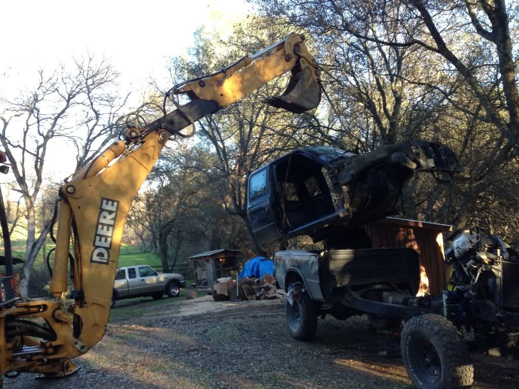

Once the cab is stripped. Double check all cab to frame connections (and 3-4 groundstraps).

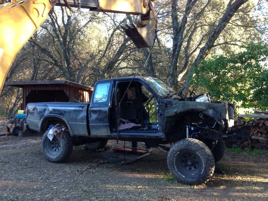

Remove cab (heavy equipment makes quick work of this):
Once the cab is off you can remove the bed at anytime (or before, up to you). Now is a really good time to do spark plugs/wires, oil change, steam cleaning, painting, body mounts, freeze plugs and/or tranny/t-case fluid changes. I highly recommend doing all that you can while you have the access. You won't ever have that amount of access again most likely!!!

Now set dashboards side by side and swap the dash harness...not hard just tedious and take your time. Take a few pictures to aid your memory of where all the bundles and clips go.

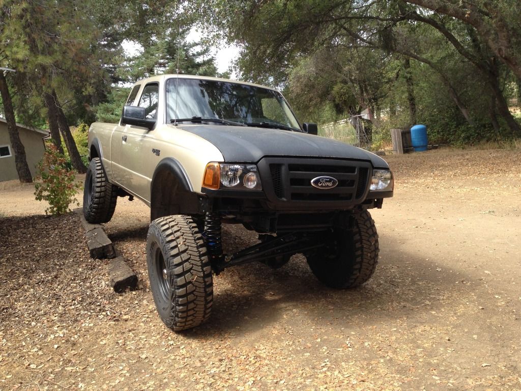

Congratulations and go enjoy a beer( or many!), that was a lot of work! Enjoy your new Franken Ranger, and get a solid axle under it (will be much easier than the hell you just endured!!!)!!!
