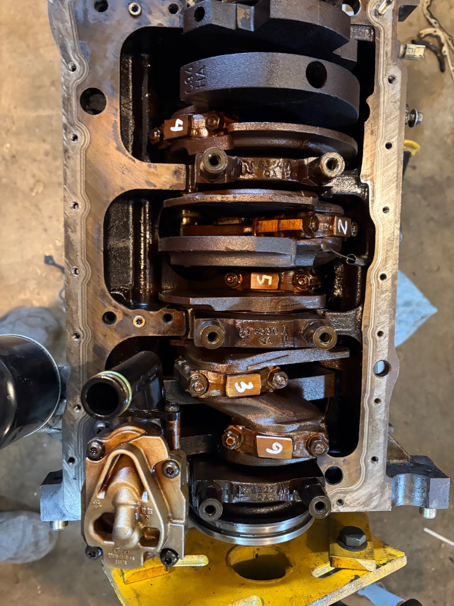

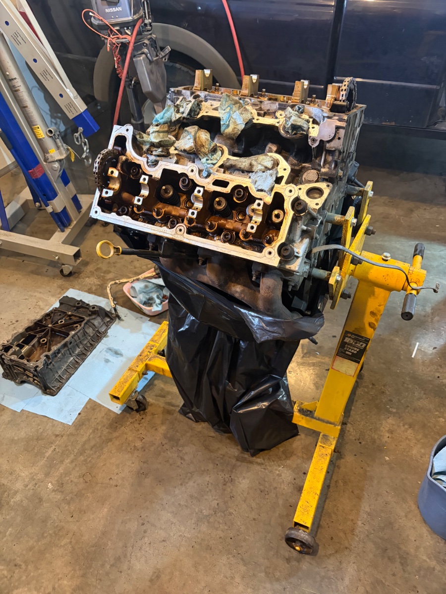

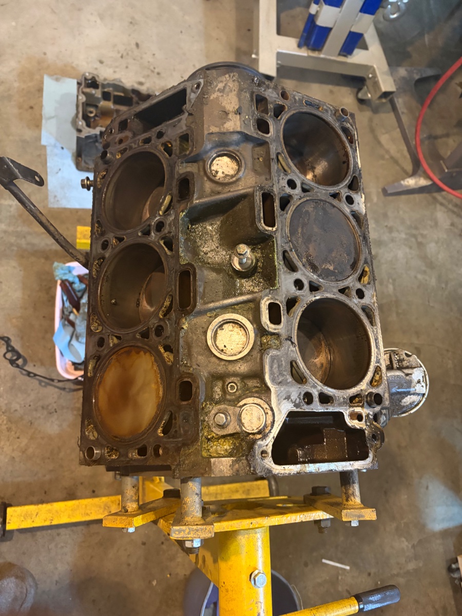

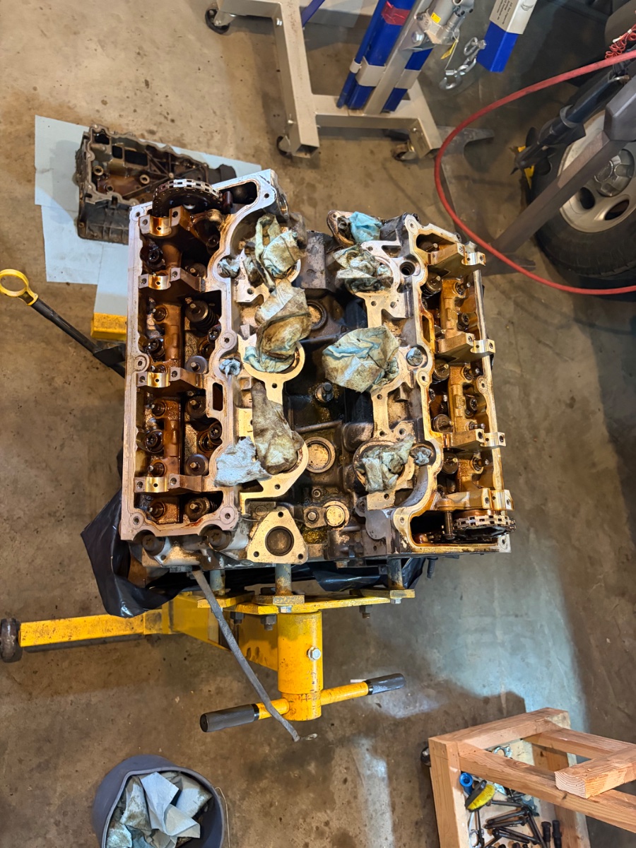

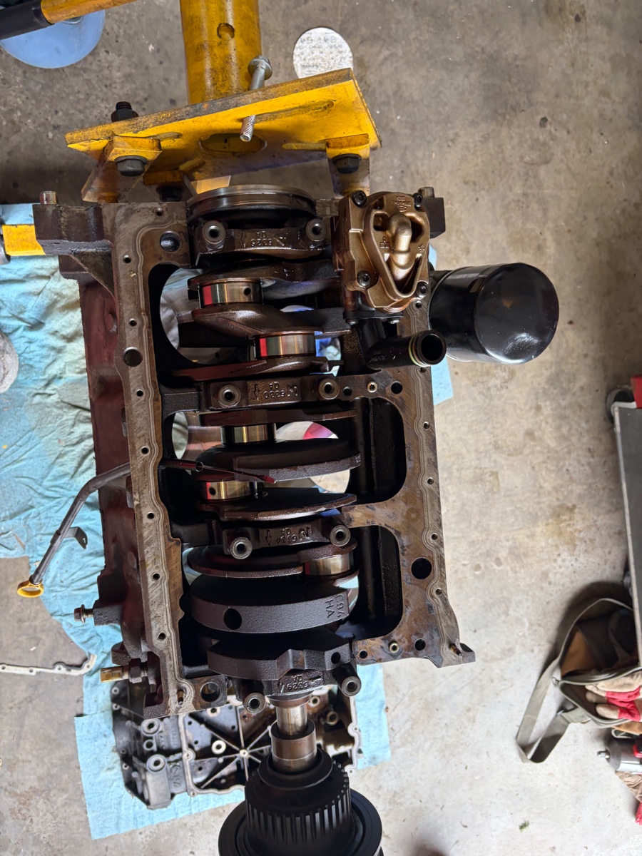

Got back from Anchorage and went fishing, my buddy and I got two cohos and 17 dungee crab. And it was a nice day out on the water. Got back to the ranger today, and I’ve got her almost all stripped down. I did a leak down test once the roller followers were off and three jugs were great and 3 jugs were bad and leaking thru the intake. (Not all on the same side). The timing kits inside were still on but had obviously started to fail. Pulled good chunks of plastic out. I’ll take the heads off tomorrow and decide how to proceed with the valves. I learned a few things from the first time around too, like stretching a garbage bag around the engine when I flip it over fluids runoff into it and not onto the floor.

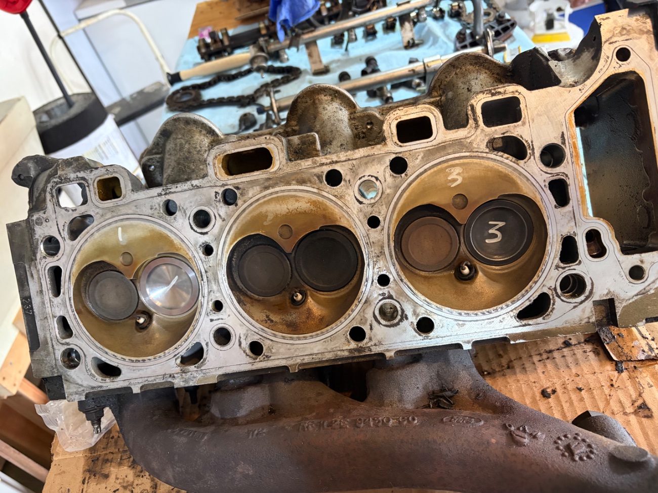

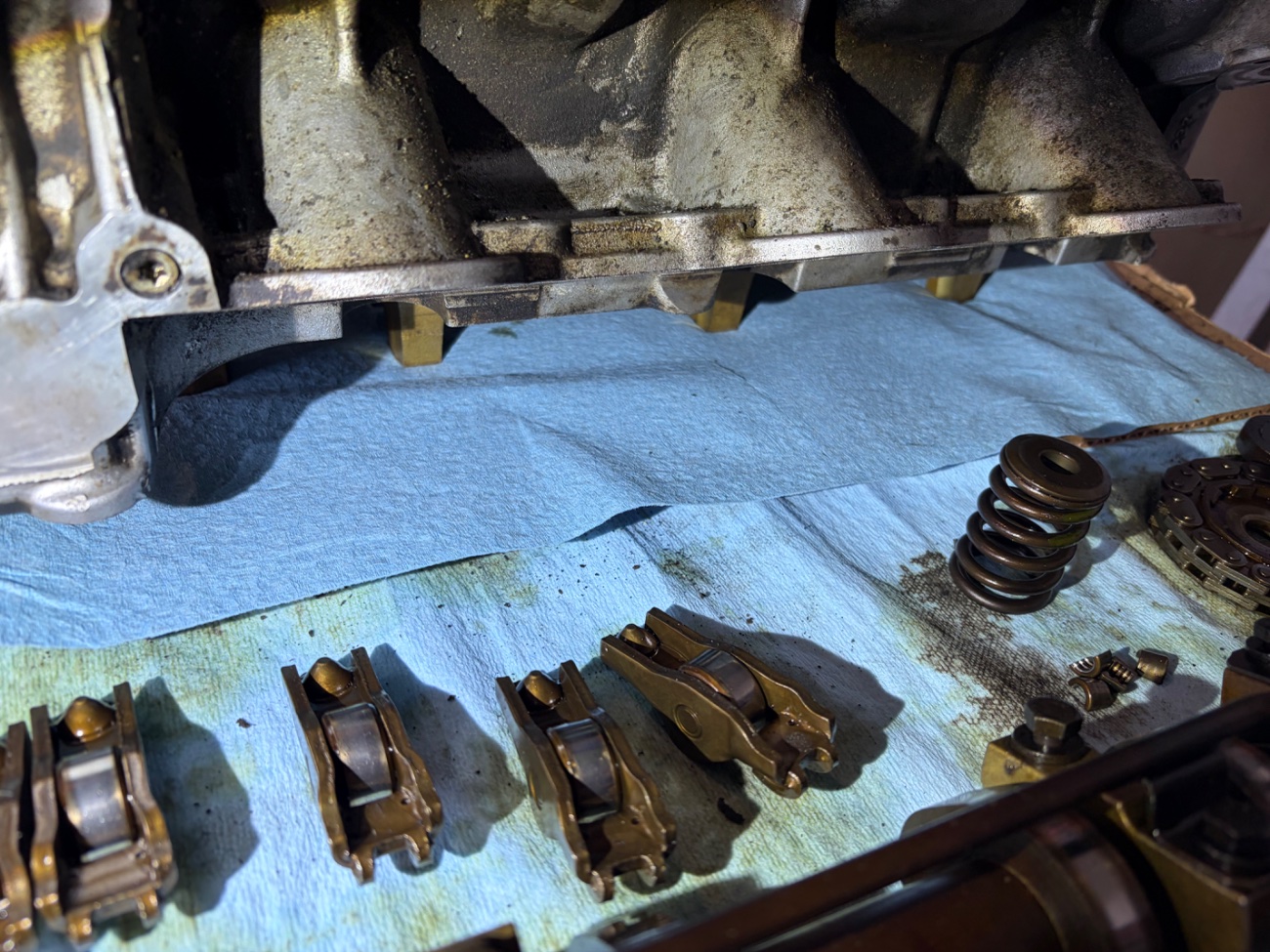

Decided to go back out tonite bc I wanted to redo the Leakdown and recheck bc it didn’t seem like the amount of air coming from the intake ports would account for how bad the cylinder was leaking. And yea upon further investigation I could hear air hissing from the crankcase as well… so looks like rings are on the menu now, and if I’m doing rings might as well put new pistons in as well.

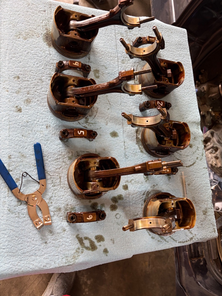

So I thought more about it and I’m just gonna go with new rings. The pistons look good, they weren’t contacted by any valves, and then I won’t have to rebalance anything. So I ordered up some parts and now get to clean, label, and wait.

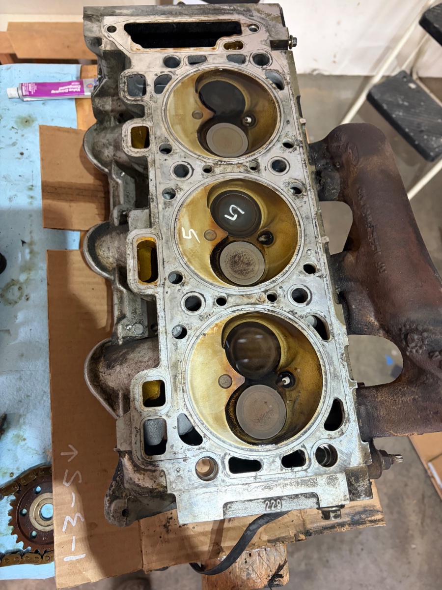

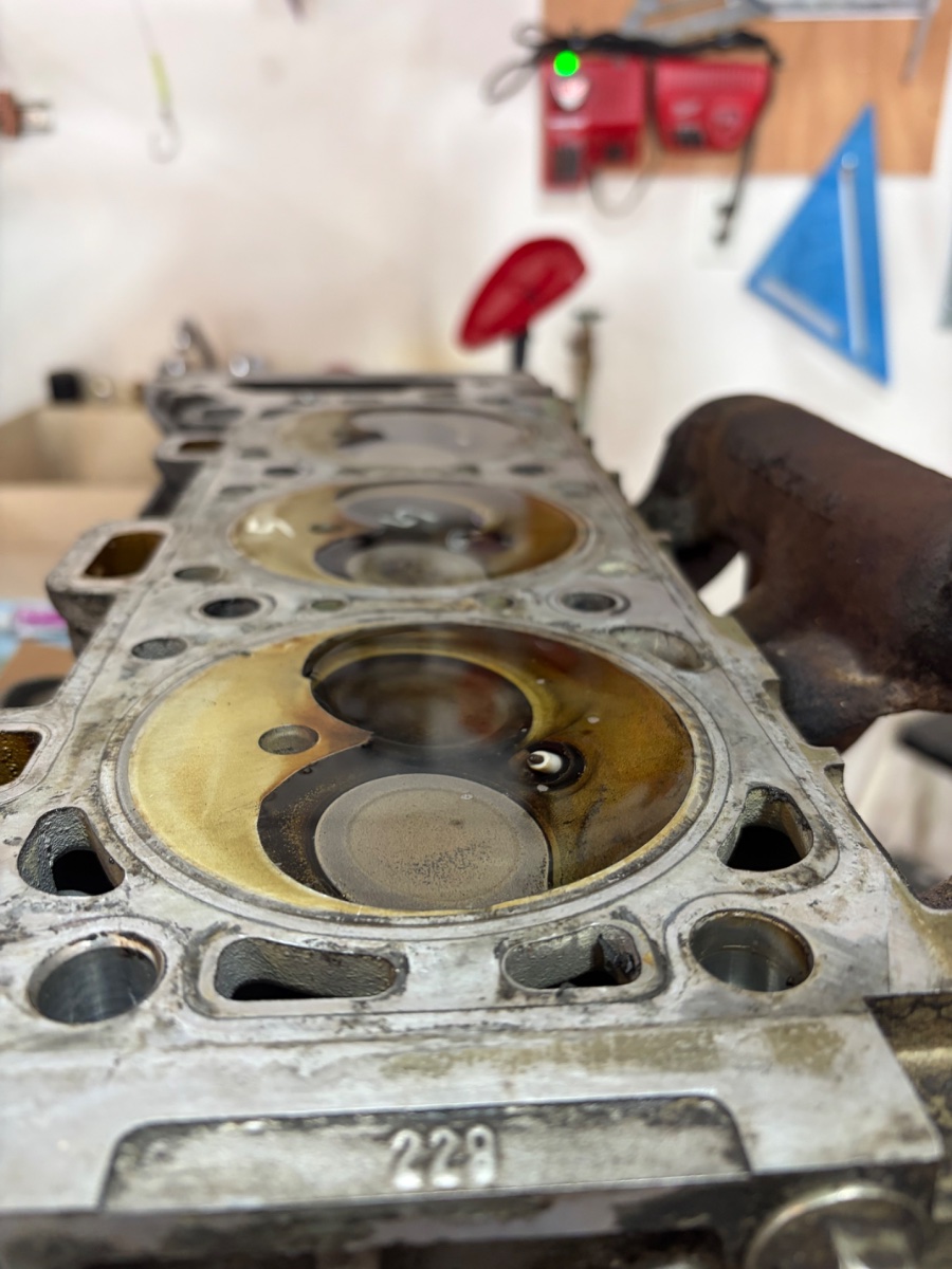

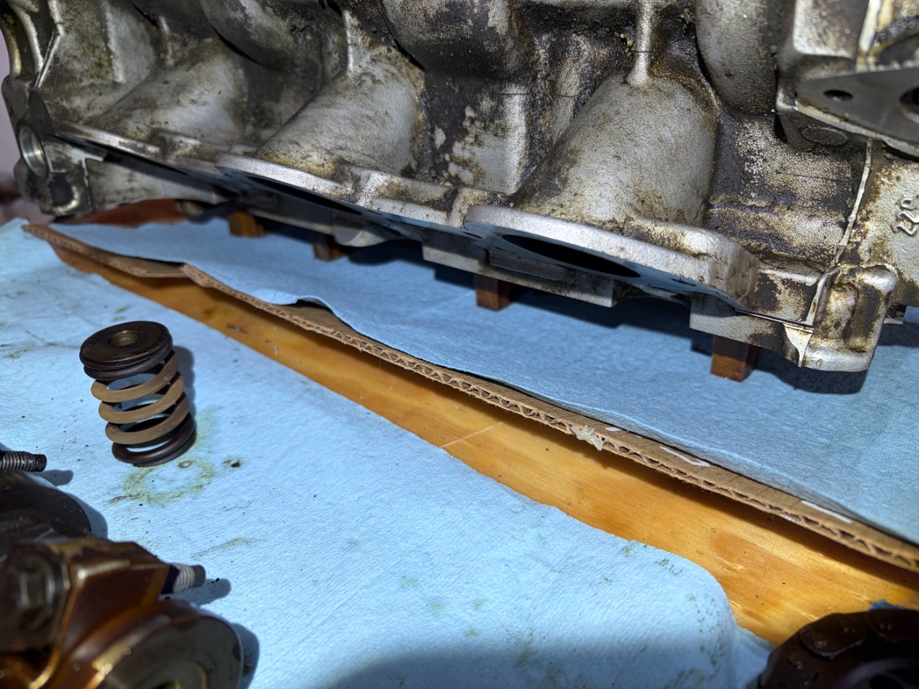

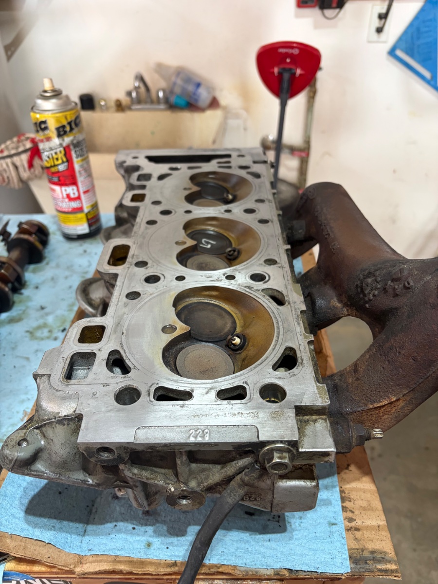

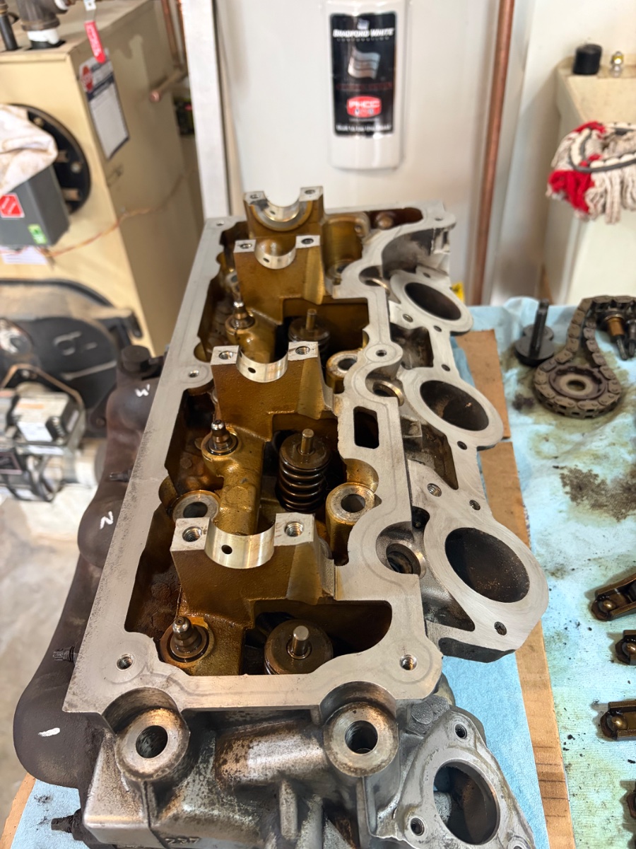

Started cleaning up the heads and lapping the leaking intake valves today. When I did the leak down test, 2-4-6 came back at 0%, which I would have thought was user error if 1-3-5 hasn’t come back bad, like 60-80%. So hearing air from the crankcase and intake on 1-3-5 I decided rings for all pistons and I’d try to lap the intake valves to an acceptable spot. I gotta be honest, I didn’t think I could get the valves there, I could see light around parts when shining a light in there. But I figured I’d try. I did the old tube on a screwdriver trick to start them out, and finished them by hand. Can’t see light anymore and doing a water test now. 1-3 leaked some after about 15min, 5 is holding strong and I’m gonna check it again in an hour. I’ll hit 1-3 again at least by hand and re test.

They all leaked some, I think. The towels I put under the fuel injector port all were damp. I mean they looked pretty damp, but the water levels didn’t look to have gone down. I think I’ll dry them out really well and re test them again before I do any more lapping.

Did a little more lapping, cleaned the valves and seats off really good. And 30 min no leaks. Nice I’m gonna call it good.

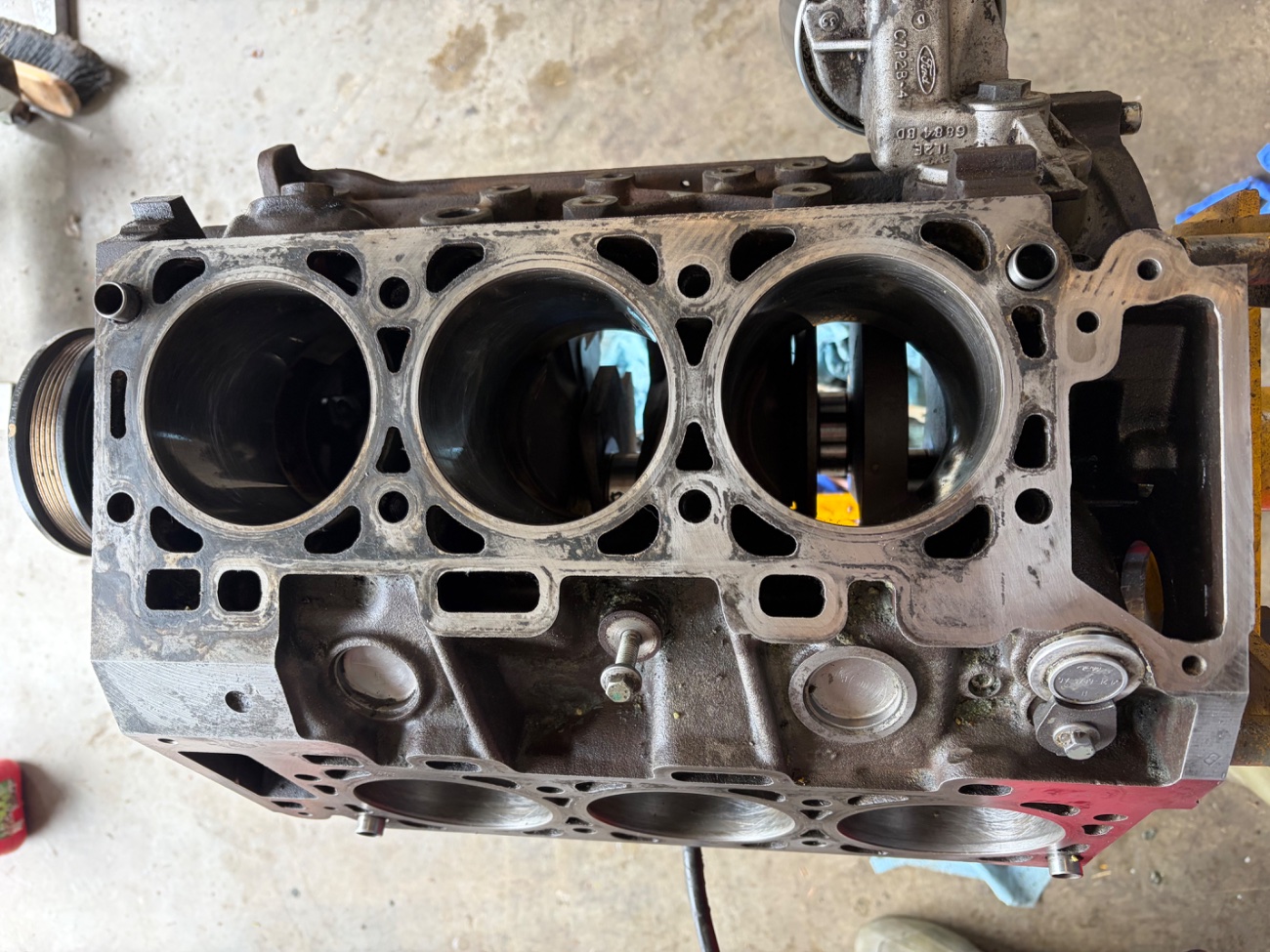

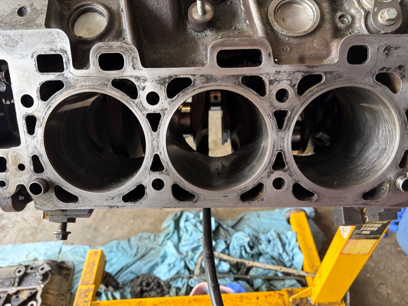

pistons are out, rings are off, got the new rings in the mail yesterday while I was out fishing. Honed the cylinders, cleaned them up real good; got some new oil wiped on ‘em. Taking a break bc I’m making good pro and it’s going smoother and easier than I expected so I’m gonna slow down and make sure I’m not screwing something up lol. Gotta pick up some more red and green scotch brite pads to clean some crustiness off the ring seats and such before installing new stuff.

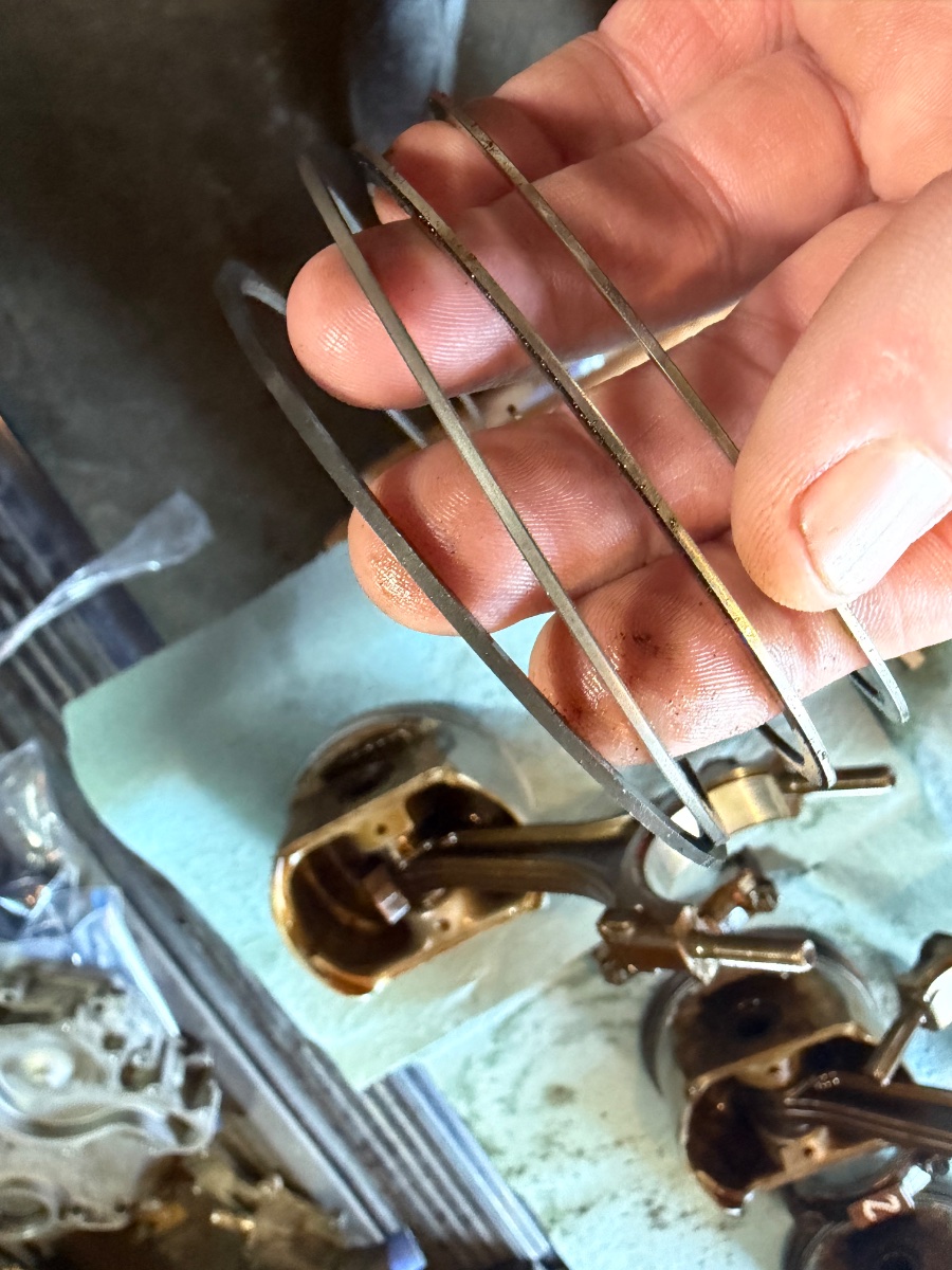

So I cleaned up the pistons real good. Tried to install the new Mahle ring set, but they are all too thick. Like noticeably thicker than the set that came off; even the oil ring. They wouldn’t fit in the grooves and I wasn’t about to force them. So I emailed summit to return them and I’m shopping for a new ring set.
  • Pulling the SOHC for inspection
It was my fault, I should have pulled and measured the rings before ordering new ones and trusting their fitment. Well I’ve now measured and ordered the correct size. Guess I’ll have to wait a few days to put it back together. Guess I can always clean more 😂

New rings should be here today, new con rod bolts and nuts in a few days. I cleaned out the piston ring grooves today, then took the con rod bolts and nuts off and weighed them. All 6 piston sets weighed the same 2.2 ounces so I just have to make sure the new ones all weigh the same when grouped by piston.
