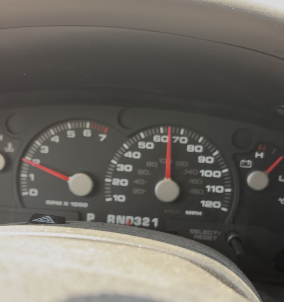

Should have a spare 4.0 next week. Went to look at an explorer today that the lady selling it calls “the shitbox” lol. It was aptly named as it had damage all over, and someone tried to steal it and Hotwire it (I guess they didn’t know about PATS). But the engine has under 70k on it and looks really clean. She said it had tranny issues and told me that if I wanted it I could just have it, we would have signed the title over to me there but neither of us had a pen. So I’ll tow it home next week and eventually pull the motor to have a spare incase something goes wrong with mine. Otherwise I’m just waiting on parts :)
Got a lot of parts in today and also picked up an 04 explorer for free with the 4.0. Only 57k miles, runs like a champ. Lady said it had transmission issues but it seemed fine as I drove it home. Had to Hotwire it as someone tried to steal it at one point but they didn’t have the key so yay PATS.

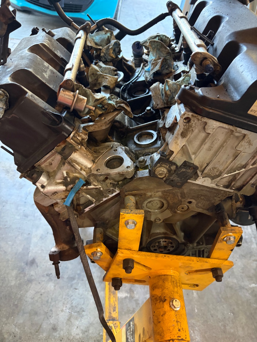

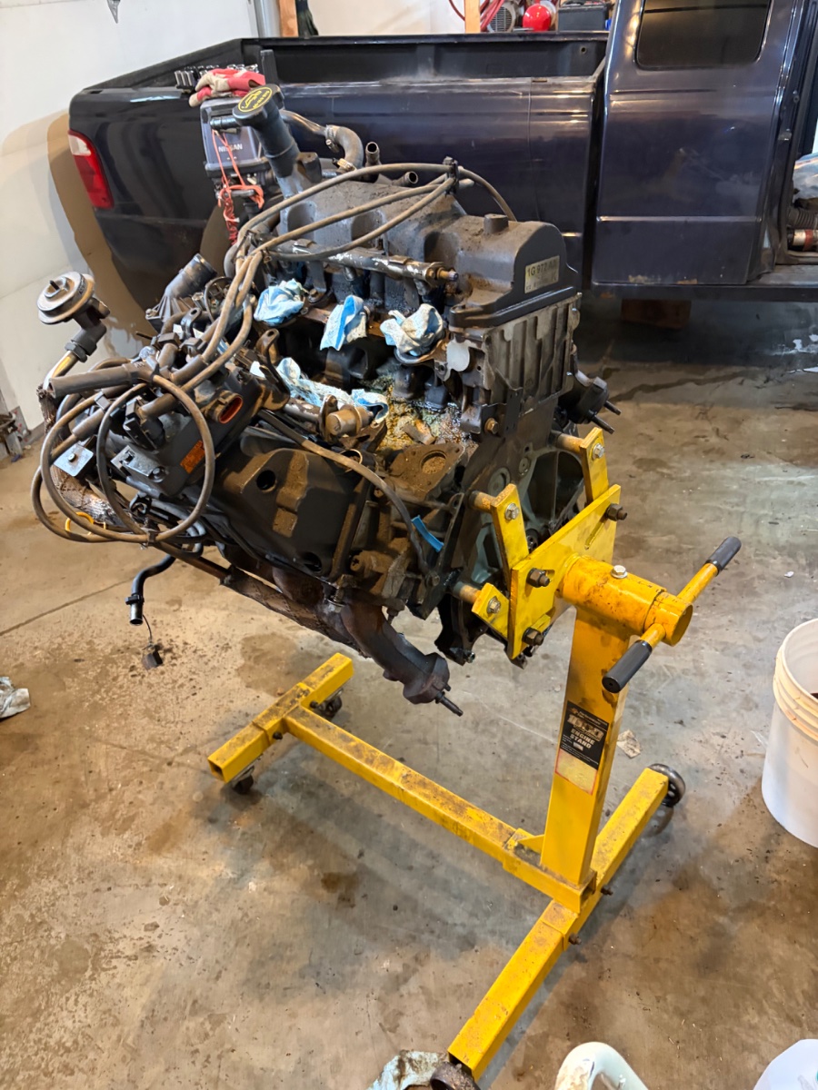

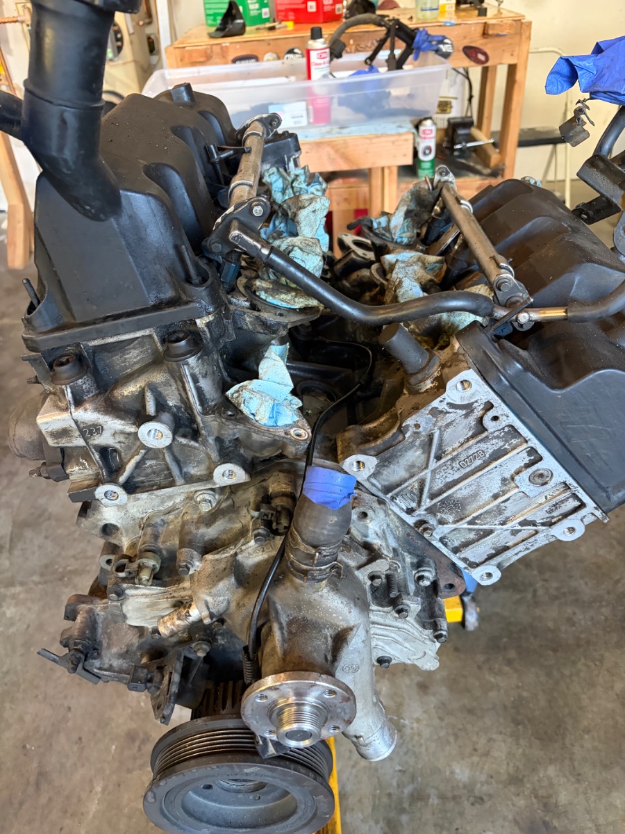

all my parts are in but an exhaust stud broke off in one head and I couldn’t get it out, tried drilling but wobbled a little off center; was gonna over drill and re tap, but…. A 2002 ranger with a cracked frame and a good 4.0 popped up and I picked it up for $200, so I brought that home today. Going to pull its engine and use it, I’ll use that timing kit on it and clean it up good. My wife asked if I was done collecting broken down cars for now… lol.
  • Pulling the SOHC for inspection
This one definitely had a coolant leak, it it ran strong so I’ll get that sorted. getting close to pulling this engine. It’s definitely easier the second time lol.

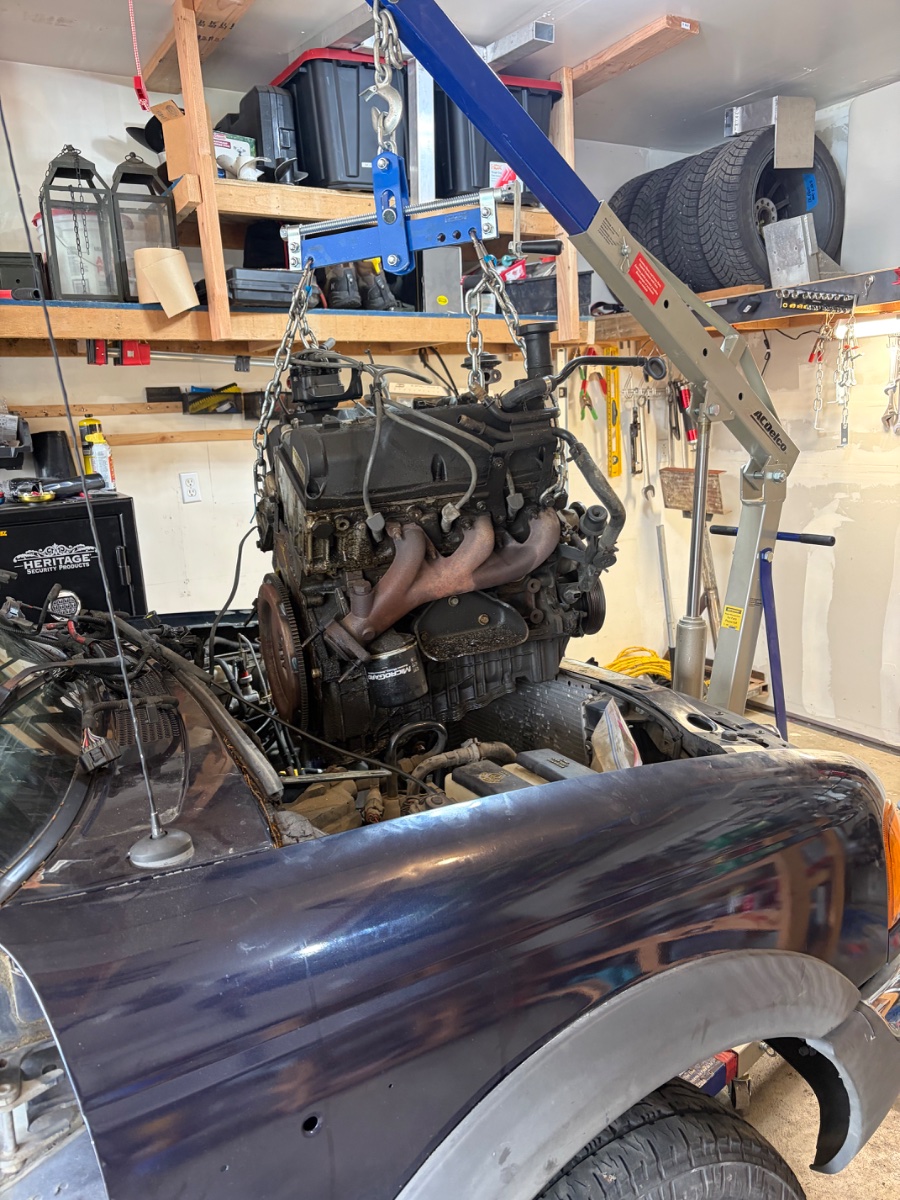

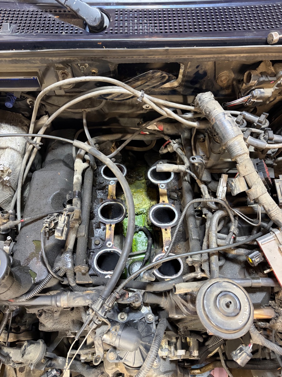

Got the upper bell housing bolt out today. Went through the access hump in the cab. All that’s left is the exhaust nuts and the rest of the bell housing bolts and I should be ready to pull it. Think I’m gonna stop for today and relax. Once this motor is out I’m gonna clean it up and do the timing chains on it then plop it into the other ranger. This guy has a lot of good parts I’m gonna keep in a tote so if I need to replace anything I’ve got something on hand.
Got everything but the motor mounts off, they are giving me some resistance so I’m gonna let em soak in pb blaster until tonight and try again.
Got impatient, went back out and broke them free and pulled the motor. Really going to relax now. lol.

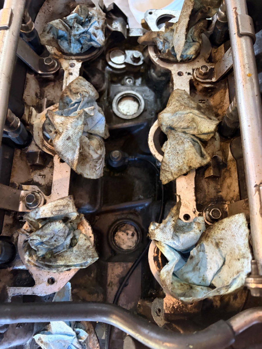

Started cleaning the engine with stuff on as much as I can, it’s one of those jobs where at first it looks 100 times better, then about halfway thru it looks 100 times worse, so you have to keep going. lol. I picked up some new spark plugs today, I don’t know how the 1st motor was running when it thru the chain, the spark plugs didn’t have gaps, they had holes… I should have saved them and took pictures; the ends were so burned back it was nuts. Don’t know how this ones are yet but replacing them is easy enough while it’s out anyway.
I guess one of the benefits of this engine being caked in oil is that there isn’t a spot of rust on it… 😂
I’ve cleaned it up almost as well as I can without disassembling it further. So I’ll probably wait on the valve spring compressor to get here before doing any more.

Ah! So I was doing some reading around here and for whatever reason I ended up finding a thread about fuel injectors; and I noticed one of my engines has the jetronic and the other has the uscar so I’m gonna have to remove the fuel rail anyway and swap the injectors since the connectors won’t work with the other one. No biggie but I could have not ordered that other spring compressor and just went ahead with the project. 😂 oh well I’m gonna wait until the weekend now bc I’m going out of town wed/thur and then hopefully going fishing Friday.
