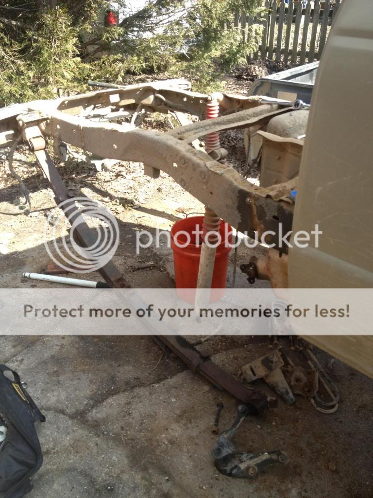

Rear is done wheels are on it I like the hight it's about 8 inches In suspention and I'm keeping the three inch body. I also ripped the front end out today I'm waiting on parts to go any further

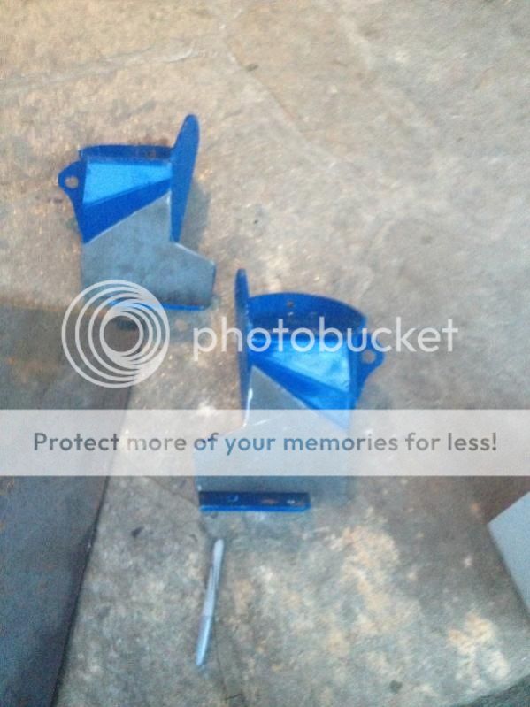

I have the conversion coil buckets from duff and they are really nice. They are designed to go around that stupid bump on the drivers frame rail, and they space out the coils just a little bit. I used the lower HD spring retainers and drilled new holes 3/4 inch over so the coils are almost straight without having to weld huge spacers on the frame rails.

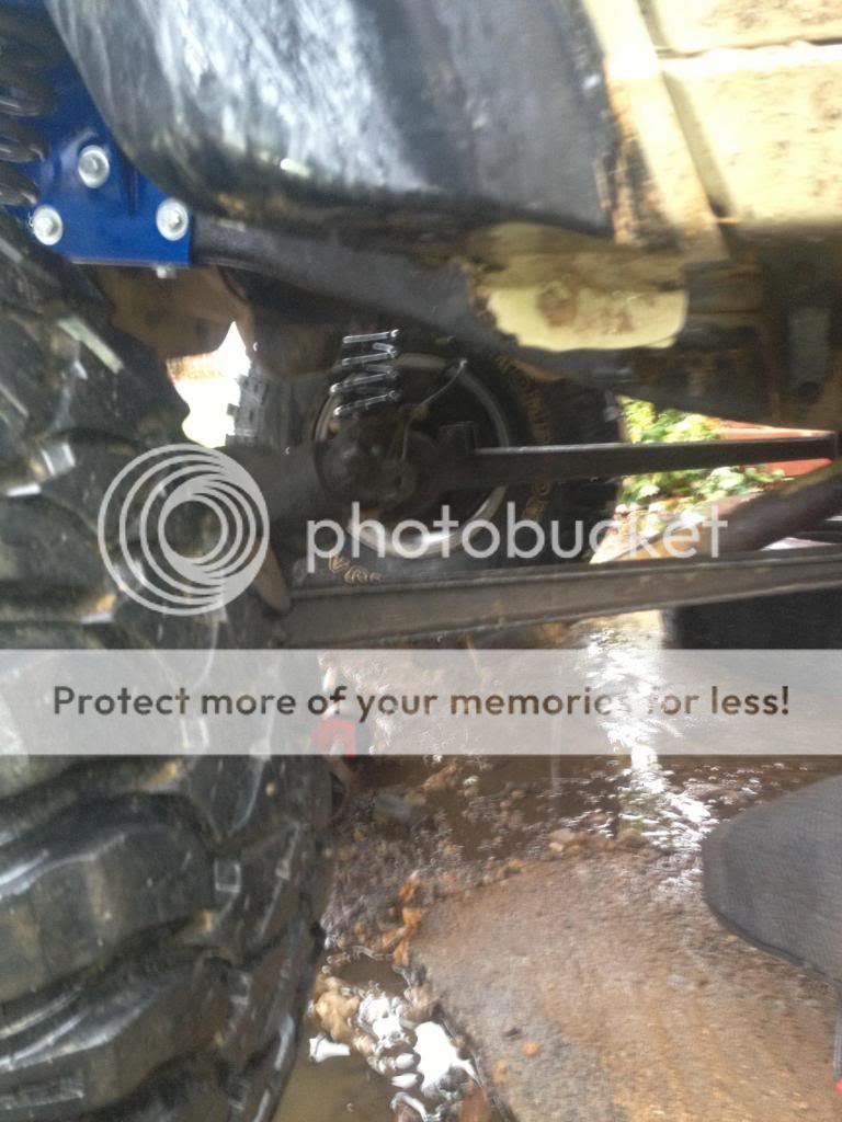

I went ahead and mounted it all up to see how she's sit and it dosnt look like ill have to move them quite two inches but here's my plan.
Weld and bolt a plate on both sides of the frame nothing bigger then 3/8th plate
Move the retainers in about an inch .
She is sitting on the wheels right now and the coils don't go in to much however it looks like the springs are on a bit of an angle
I am running a FW HP 44. My upper buckets are spaced out a bit (built into the duff buckets) and my lower retainers are spaced in 3/4 inch, but I could have gone 1''

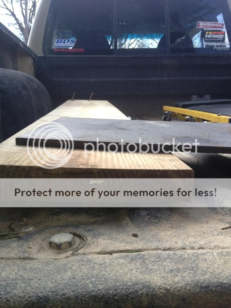

Okay so I picked up some plate to space the buckets I also ordered 7degree c bushings .
Could you possibly post a picture of your bucket and how it's spaced?

I wend ahead and cut the plate out welded it up and drilled holes I will have more pics tomorrow .
