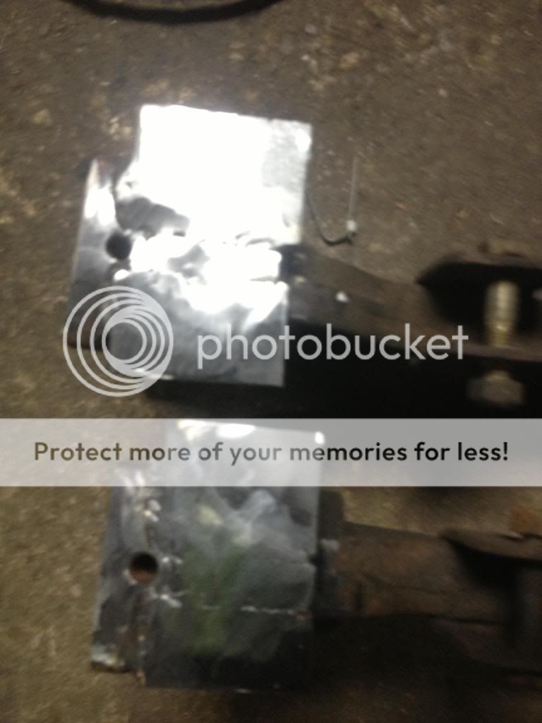

I also made some modifications to the radius arms to get my axle foward a bit (thanks again plum crazy for the idea!) I still need to tap a hole in it tomorrow but that should be easy enough

So sasically I just have to move the radius arm brackets foward a bit and I can mount her up.

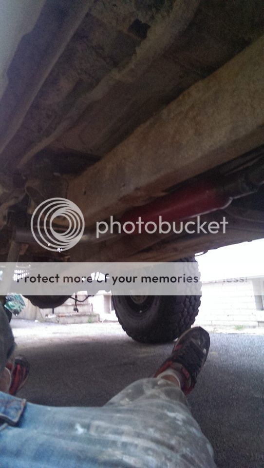

I got some fox 2.0 gas shocks I will have to make a new upper mount for them but currently they are on the truck and work good !

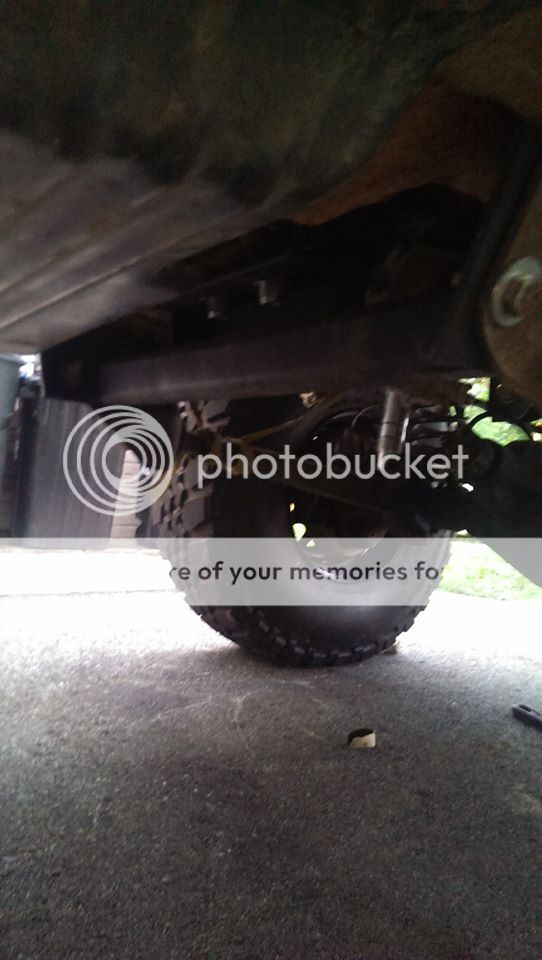

Also made a cross member just copied on I found on here check it out .

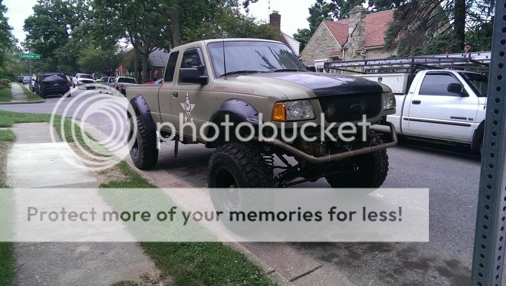

I know I'm tired, but am I seeing things? Is that some sort of militarized Patrick the starfish on your door?
It's a camo metal melitia sticker over a painted on star
