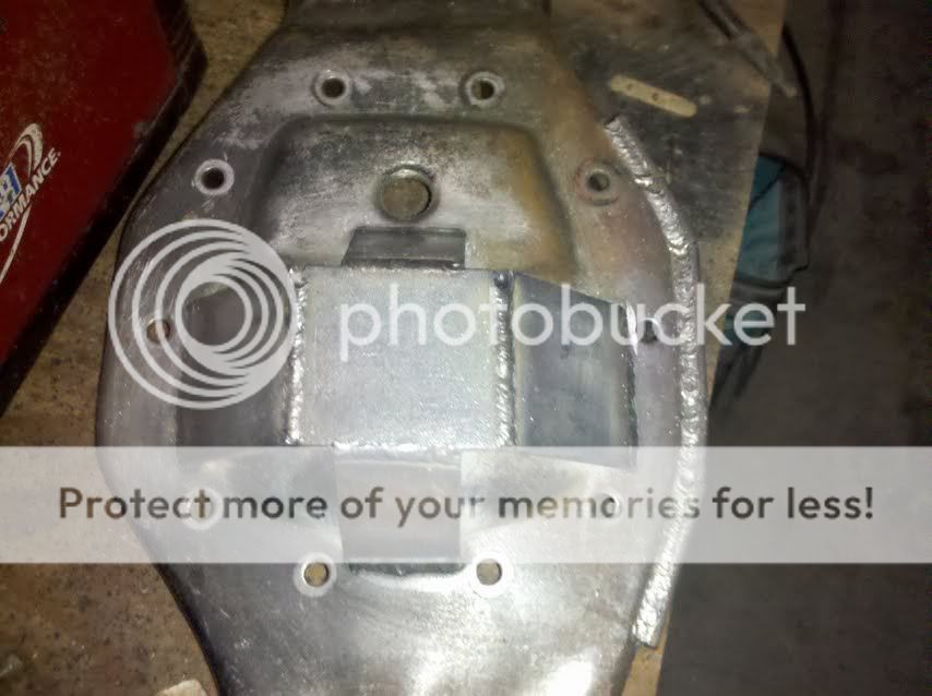

Armor is done!
Just got done with the armor for the D35. All I had to work with, was 3x1/4" hot roll, but I think it turned out pretty good. :icon_hornsup:
