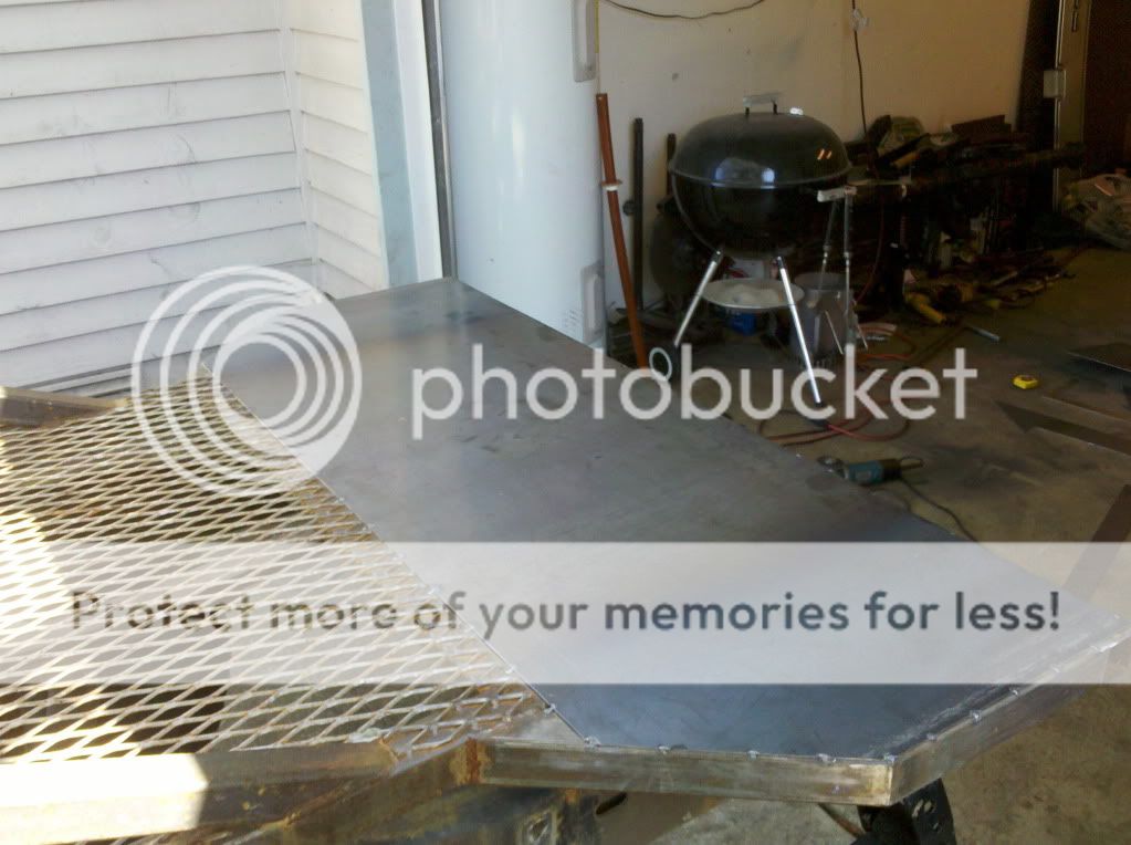

Made some pretty good progress on the bed this weekend. I wasn't able to hook up my reverse lights, and a few other things, but I'm happy with the way it's looking.
The bed before:
with the top piece:

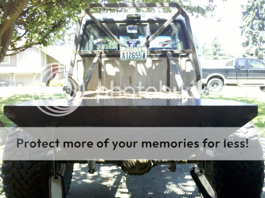

Fabed up this for the rear:
Installed:

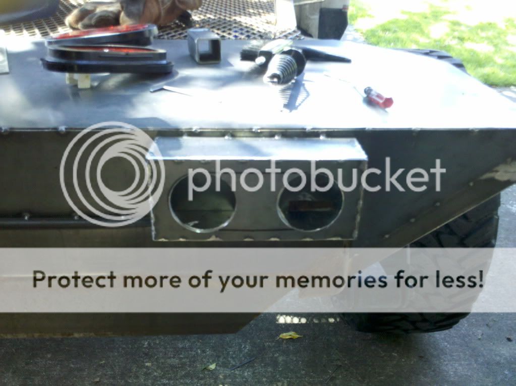

Made boxes for the tail lights:
Used a 2-1/2" Bimetal holesaw bit, and a grinder to make the oval shaped holes:
Lights installed:
Made some removable mud flaps, and installed. I used one mud flap from a big rig, and cup it in half, then shortened it (12x19). I riveted the pieces on to 1x1x18" square tubes that slide over 1/2" cold roll round, that I welded to the frame. I turned out perfect!
I also added some sheet metal to the front bumper. It's not quite done yet, but it's starting to look more like a bumper.

nice work, question though, why the boxes for the tail lights? why not just mount then flush with the back of the bed?
That was my original thought, but I didn't plan it out properly. I didn't quite leave myself enough room between the cross member, and the bed. I tired various things to try and make it work, but it just wasn't happening without a total redesign.
Lessons learned I guess. It worked out though. It made it easier to waterproof the lights. I'm not bummed out about it.
