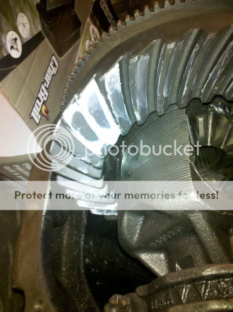

Some new progress (finally). I decided to get off my ass, and do something to the truck, after three months of zero progress. I was starting to feel guilty, and tired of looking at it in the driveway. Anyway, I found a way to get the pinion bearing off the gear, without damaging it, and without a 12 ton press!
I froze the gear/bearing for three hours, went out and got a bearing splitter ($30 at harbor freight), heated up the bearing with a standard torch, applied the bearing separator and BAM! It came off with ease:icon_bounceblue:
After that I sanded the inner diameter of the bearing to slide on and off the pinion, and set up my gears. Today I'm going to buy another bearing, and button it up. Once I get back from vacation (6/20), I'm gona mock it up, weld on my leaf perches, convert it to disc, finish up the bed...... and....I think that's it. It's gona be wheel'n time!
