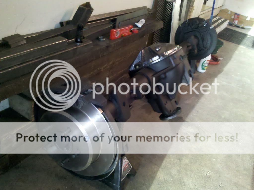

Finished the 8.8 yesterday! I took the day off, because I was going to lose a day of vacation if I didn't. I did the final set on the 5.13's, got the disc brake set up from the junk yard, new rotors/pads, set my pinion angle, welded on my leaf perches, and shock mounts, and finished her off with a good couple coats of black paint.
I decided to go with black, because it was already pretty much black/brown, and scratches won't show up too bad, and also makes for easy touch up.
Pics:
Disc brakes from JY cleaned and painted

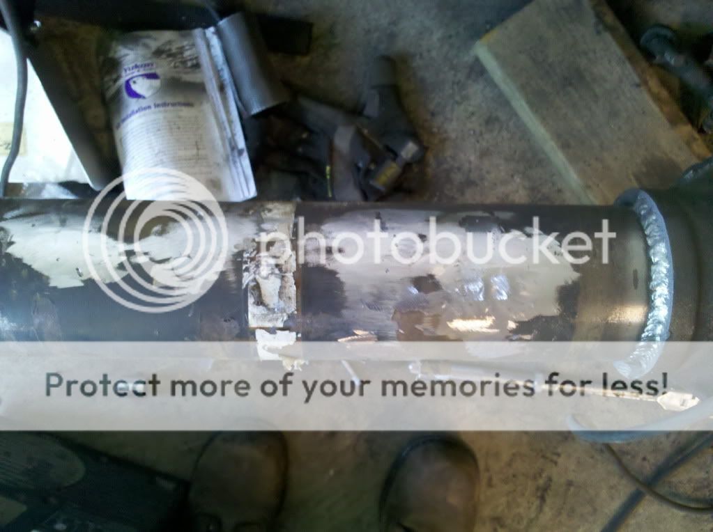

Took the time to clean up the old welds from when I cut off the sway bar mounts, and leaf perches. I also ran the bead of weld from pig to axle tube.
leaf perch welded on

So next weekend I'm going to buy a driveline from a 4.0 extended cab from the JY, pick up some U-bolts, and run the brake lines. I'm excited as all hell to finally be able to drive it with matching gear ratios:icon_bounceblue: It'll be trail bound VERY soon!

so you cut up the old schock tabs and it looks like you reused the leaf spring perches?

Thanks Eddie! You would be correct. I was very careful when cutting the perches so I could reuse them. And I figured why make new shock tabs, when I already have them. I'm going to reconfigure the shocks to go up at an angle like this / \. I think I'll be able to get quite a bit more out of em this way.:icon_thumby:

yeah, that's what i figured. i guess you'll have to fab up a new upper shock mount too?
Yeah, but it's all easy stuff. I have some 3/16" plate that I'll make them out of, and weld em to a cross member I put directly above the axle. I think it'll turn out pretty sweet, once it's all done. Pics to come next weekend! If it works out nicely, and you like the way it looks, I can hook you up with dimensions.
