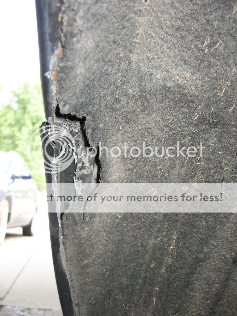

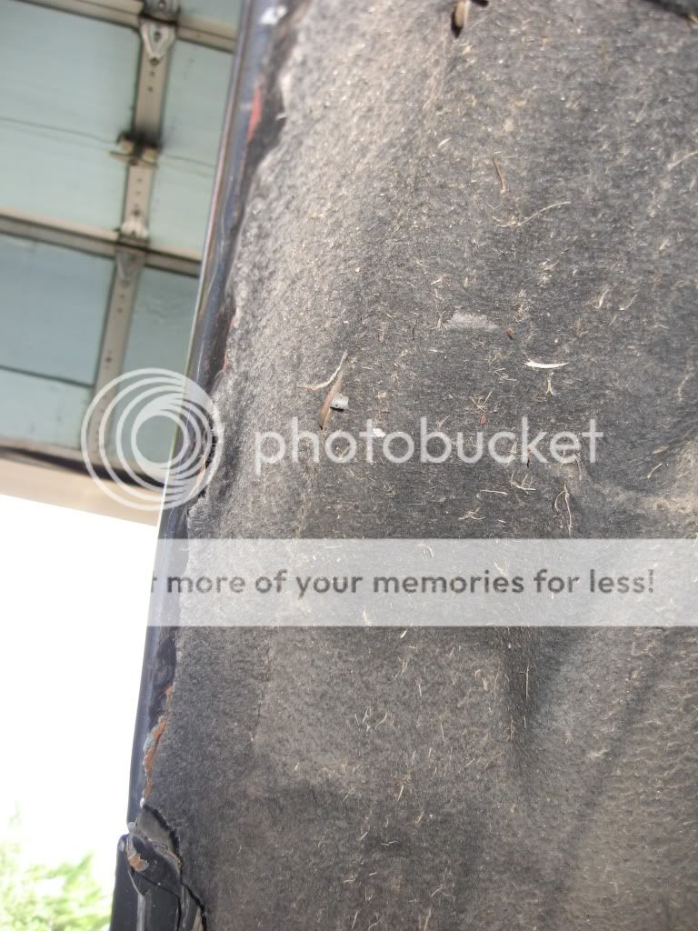

The 18's have been rubbing a bit on turns and large bumps when the trunk is loaded down or we have someone in the back seat. Other wise it's fine. So I pulled the wheel off.
You can see here the bare metal is were the tire has chiped the paint off and the missing plastic off the rear bumper. the carpet insulation stuff I ripped off a week or so ago when I saw the tire was taring into it. I've already hammered a bit with the tire still attached at that same time.

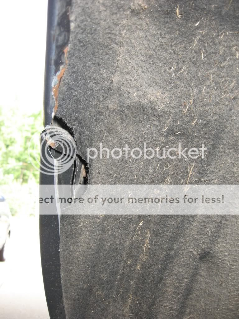

You can see here were I've been hammering the inner lip up to get it out of the way.

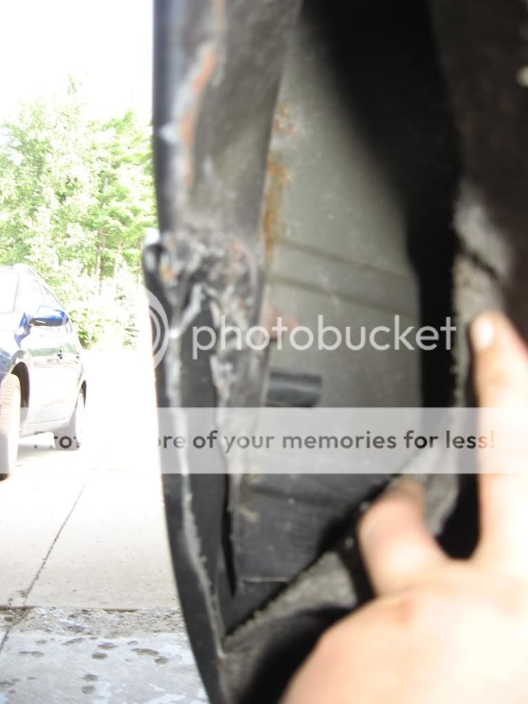

I got the angle grinder out and cut away at the inner lip just behind the rear bumper and I cut away about a quarter inch of the inner bumper. Once I cut some of the inner lip off i took a hammer and bent the sharp edges out of the way.

You can see from the pics above the hammering pushed the bumper out a bit but I was able to realign it with a rubber mallet and a towel. Now it looks like nothing was done from the out side.

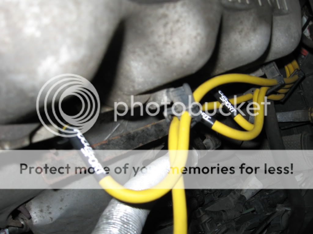

I also got in the new plug wires I ordered through massive. Everyone gave me so much crap for the cheapo wires I used for the tune up I did last month. So I figured I make everyone happy with these. And it'll add a bit more contrast to the bland engine compartment.
Project: SVT Wannabe
Installed!

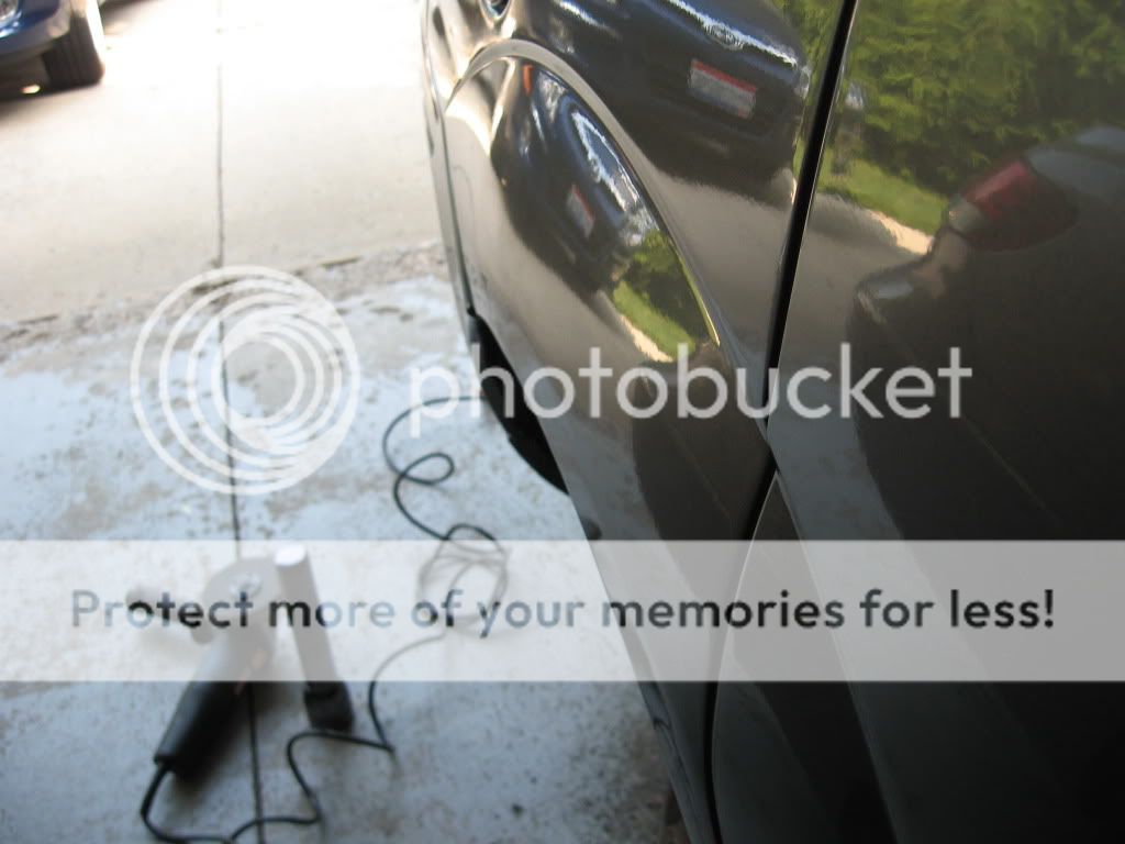

I also tried out some tire shine and cleaned up the wheels a bit.
Going over to my inlaws also gave me a chance to do a before and after shot.

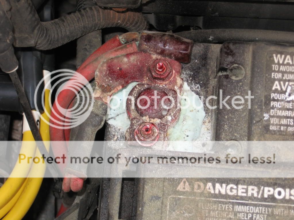

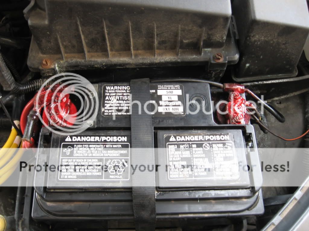

Ok got up and got working on some more preventive maintenance. It Helped a bit but the cables need still need replaced there are so many on both sides it's gonna be a while. I'm gonna half to trace them to see where the go which is gonna involve the removal of things like the air box and so on. I'm just gonna half to deal for now and hope it doesn't get worse. The postive wires looked worse so i'll prolly go with those first. Anyways on with the pics.

What I have been dealing with.

I sprayed cleaned off and wire brushed the terminals, and the connectors. It looks like the factory connectors are cooper too.

I cleaned up all the over splash and greased up everything and reattached all the wires then spayed on the protectant.
