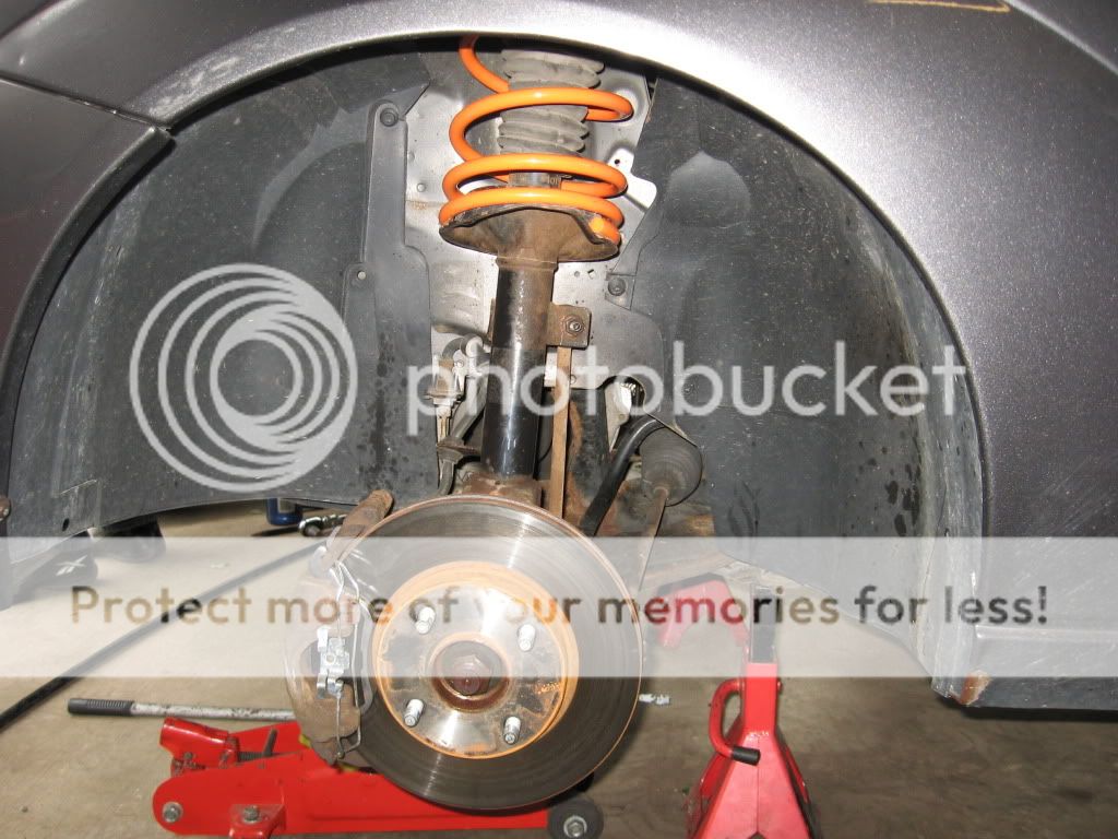

Got the springs in with the help of Jim Oaks, grey_04, black'03Level2, and Jims friend John.
Assembly out.
Grey_04 working on compressing.
All of us wrestling the new spring into place under the shock mont.

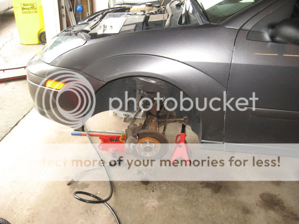

Got the front in and buttoned up.
