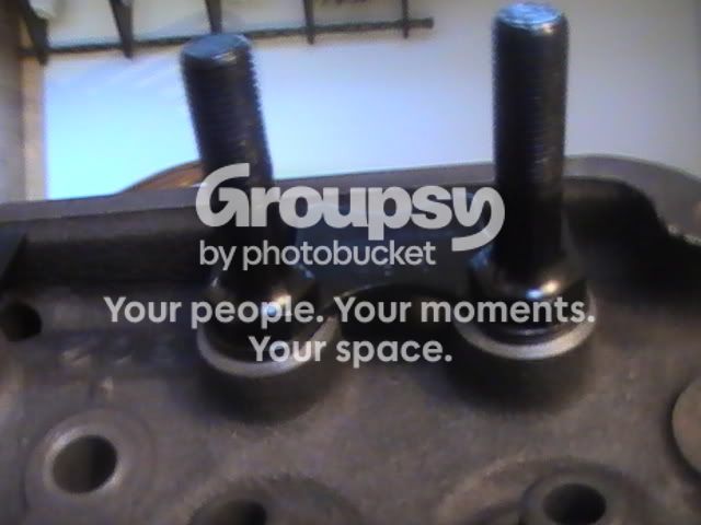

7/16" ARP Rocker Studs...don't worry there's 16 of them

Rocker studs and guideplates in
