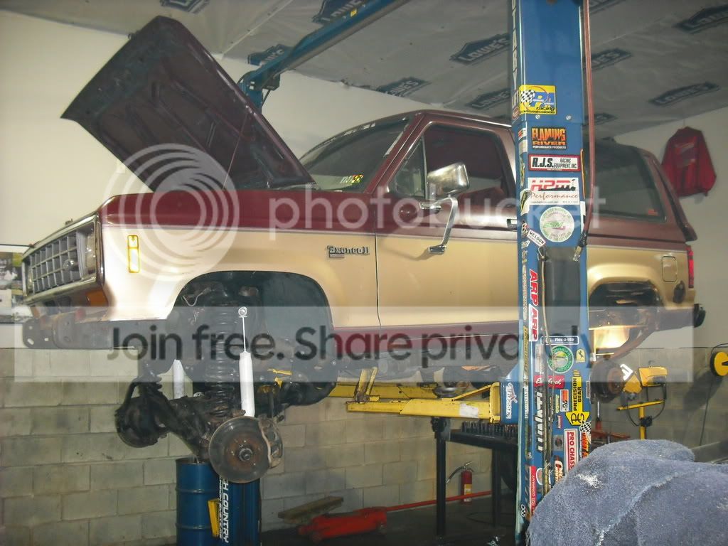

so if ya wana go wheeling in one week and you other off road truck isnt runnin do what i did, find something you can use all the parts you have laying in yard lol.. i had a 6" lift kit for one and bigger rears and tires all around yard...
ended up gettin this 88 bronco II for $231, needed battery and hasnt been started since 2004 lol... i was suprised when the ol 2.9 fired, and afetr clean mice nest out the air box she was cheeeeerrry.
anyway heres some pics of it,
front with 6" kit and used dana 35 with 513s
"custom" bronco 2 leafs with sum cut cherokee leafs and 2" block and 8.8 welded rear with 513 gears
buh-bye junk dana 28 front and 7.5 rear
running 33x10.50x15 boggers and soft 8 wheels
dana 35
looks like its gonna be sick in the trails
Looks bitchin man! Good price too.
Are you gonna do anything with the steering?
nope lettin it go, check out my other threads on my 96 ranger mud bog truck, I s.a.s. that and thats why i had all these drivetrain parts laying around
sweet deal man, looks like a good find
You need the big Skyjacker pitman arm on there, that thing's probably not gonna even be drivable like that :eek:
Looks good otherwise though :icon_thumby:

the pitman arm will be in tomorrow already ordered,
and like i said i bought this for this wheeling trip cuz i dont need to ruin the mud bog ranger.
and for the d rings, they are for strappin to the trailer
