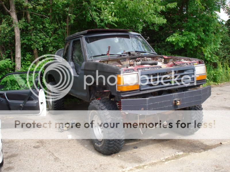

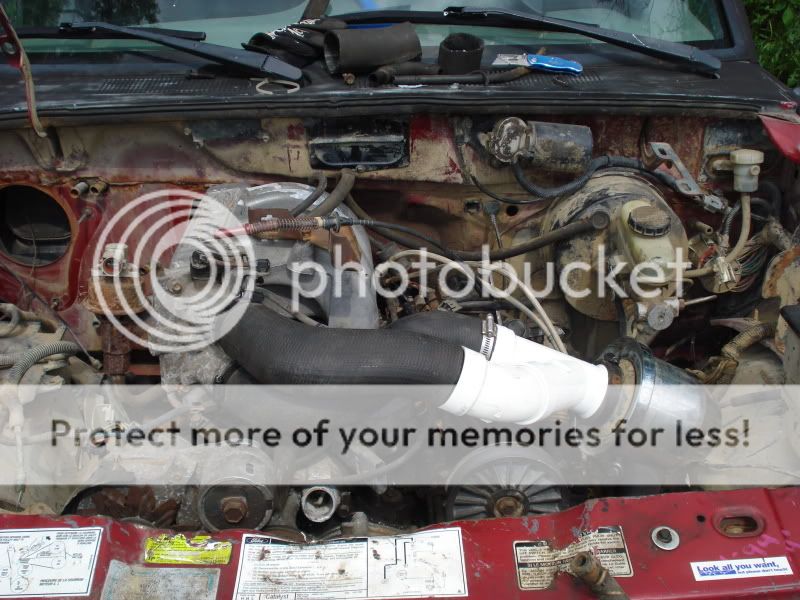

Geeze... It's been awhile since I've updated this... Not much has been done... The winter was a bit to cold and snowy to put much work in on this...
As of now I have the motor sitting in the ranger... still need to drill holes for the motor mounts though.
I have a newer trans. 5 speed this time... M50D out of a F150... Not what I wanted but I got a good price on it...
I will hopefully be updated this a little more often now that I am in MI for work and pretty close to the truck...
Did some work finally...
engine is sitting in where it should be....

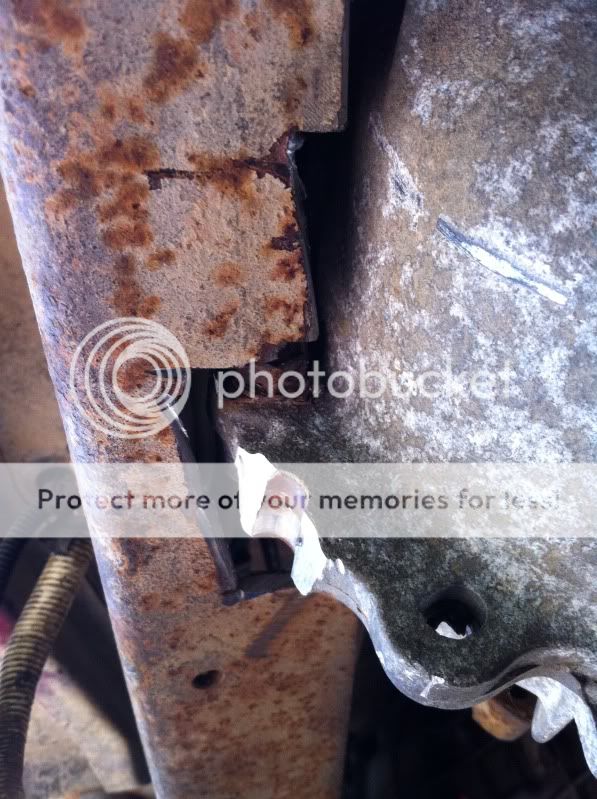

I got the T-case in, That 1356 is one big motherf'er. I ended up "trimming" about an inch and a half by like 4 or 5 inches out of my frame just to fit that thing.

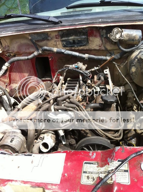

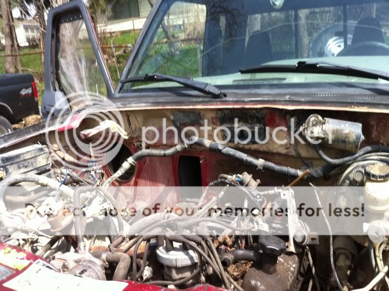

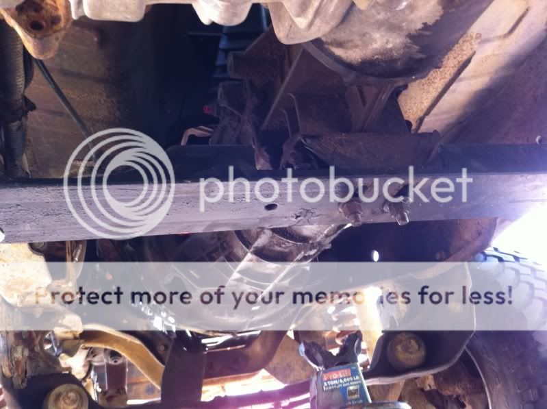

Well I got a couple pictures this weekend, brought my camera and the battery was dead so I have some phone pictures...
I got the trans crossmember in and a picture of my notched frame... I also realized my engine isnt perfectly straight but it should be fine... If it were straight it would require much more frame modifications for the 1356 to fit...

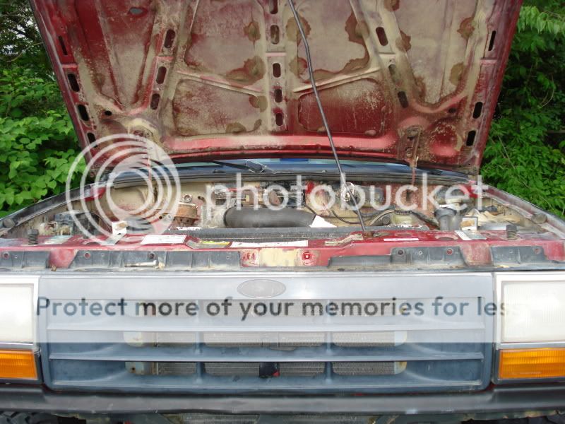

Got some stuff done...
Didnt feel like tackling the major things today like the wiring and drive shafts so I got some of the smaller stuff done..

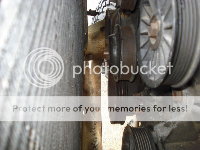

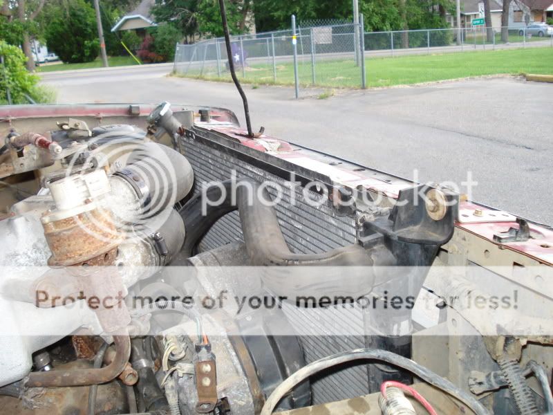

Intake on, Radidator in, Air filter on...
It looks like I am going to need a pusher fan unless i can find a really skinny efan...

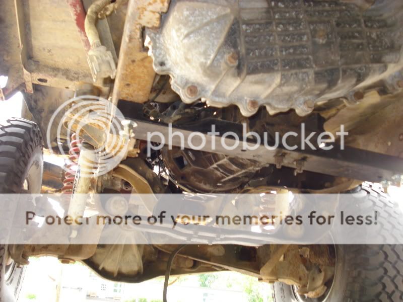

Got a better pic of the underside

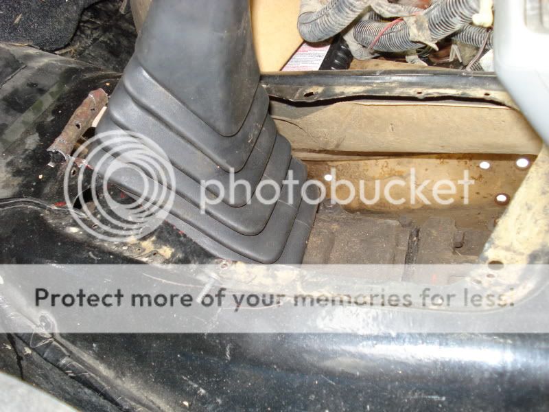

Shifter location
