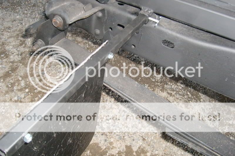

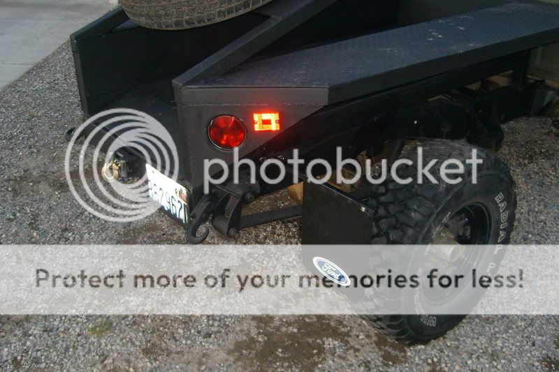

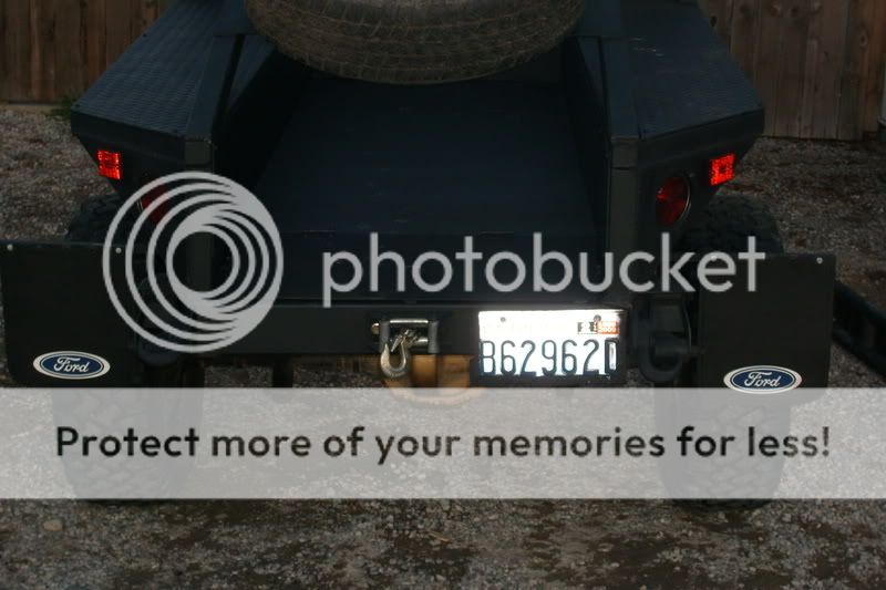

Ok I got my tow hooks and mud flaps on today. The flaps look a little ridic, they're probably too small, but I think it's enough to keep law enforcement happy. And they're removeable so when I hit the trail, one pin and they're off.

I'm not going to have reverse lights on it. And I'm looking to get some sort of cargo net to go across the back end but they're all too big. It's only 30 inches wide. Any suggestions?
could you not buy the net and make it 30" wide? whats the net made of? find someone that can sew?
why not put some 3" spot lights at the back have them for reverse? and have them on a switch.

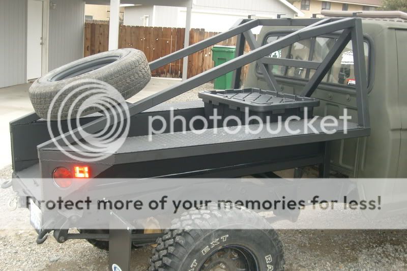

They're kind of hard to see, but up on top of the "roll bar' there are five tabs for lights welded on - four facing forward, one backwards. Eventually, it's going to have a 150W KC light facing backwards. And I don't think reverse lights are required and I didin't feel like cutting another hole in each plate to put another light in.
And for the cargo net, I was thinking that, just cutting it down. Which would work if it doesn't have a logo in the middle of it, which most do (so the logo isn't off to one side..unless I cut shorten it from both sides). But...yeah I might have have to do that. I can't think of anything else
And yeah I'm hoping just by at least putting the effort into putting mud flaps on, law enforcement will be happy. I see a lot of rigs who just don't even bother putting flaps at all. I think/hope it'll be ok.

Got a "toolbox" mounted in the bed today. It's just a very heavy duty tote bolted to the bed in each corner. It's going to hold a second battery for the lights, winch, and other misc electric stuff. It'll also have an isolator that recharges the battery, misc tools, and other stuff.
