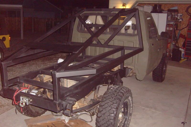

Look like it could use some more triangulation at the front outer corners, to the frame. Also at the back corners.
Yeah, I'm planning on doing the front corners tomorrow.
Here's where she is as of right now. Almost done, going to go buy the sheet metal tomorrow and we should be good to go (minus the front bars under the fenders to the frame).

The bar on the back is for the spare tire. I'm going to be adding the bolts to it tomorrow as well.

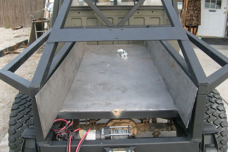

Here's what I got done today, the bed sheet metal ready to be tacked down:
Project: Mr. Bad Motor Scooter - 92 Ranger
The winch will be covered with a plate that will be on a hinge, so it will be covered yet still accessible. On the fenders, instead of using regular plate, I bought some diamond plate. Hopefully I can get it cut to size tomorrow. Monday I don't have school so it should be 100% done by then.

Here's what got finished today - bolted down the bed plate except for the last piece against the cab. Damn the snow is all I have to say. Just randomly snowing.. Anyways, here you go:

The plate on the end near the winch is hinged for access:

nice job!
are you going to put any kind of latch on the winch cover door?
again............really nice job man!
Thanks! I appreciate the compliment. The door is actually pretty heavy, I don't think I'll put a latch on it. The spare is also going to be above it, which will act kind of like a stopper so it can't fly all the way open. But I might put a bolt through it that can have a cotter pin inserted into keep it to keep it shut. But we'll see what happens.
Thanks again for the compliments. This is the first project I've ever done that I really took my time on and everything came out square, like measurements and stuff. Ha
