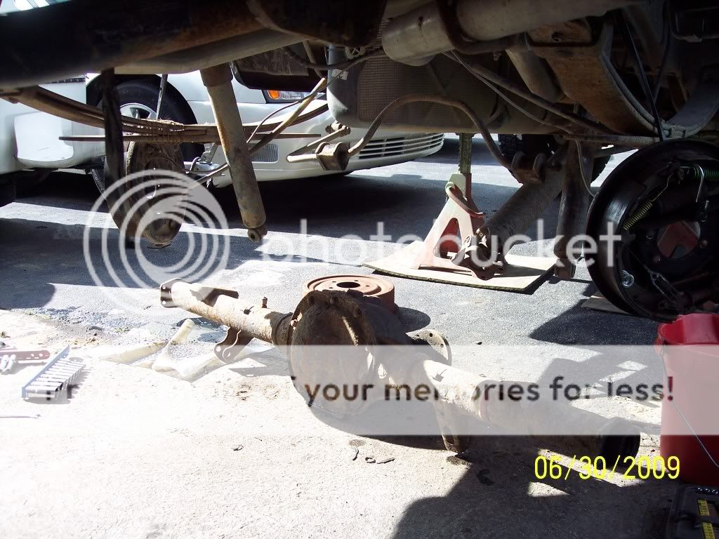

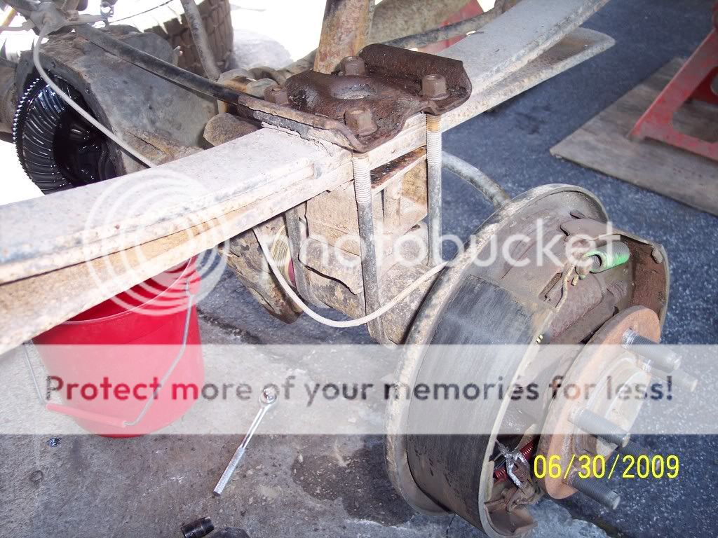

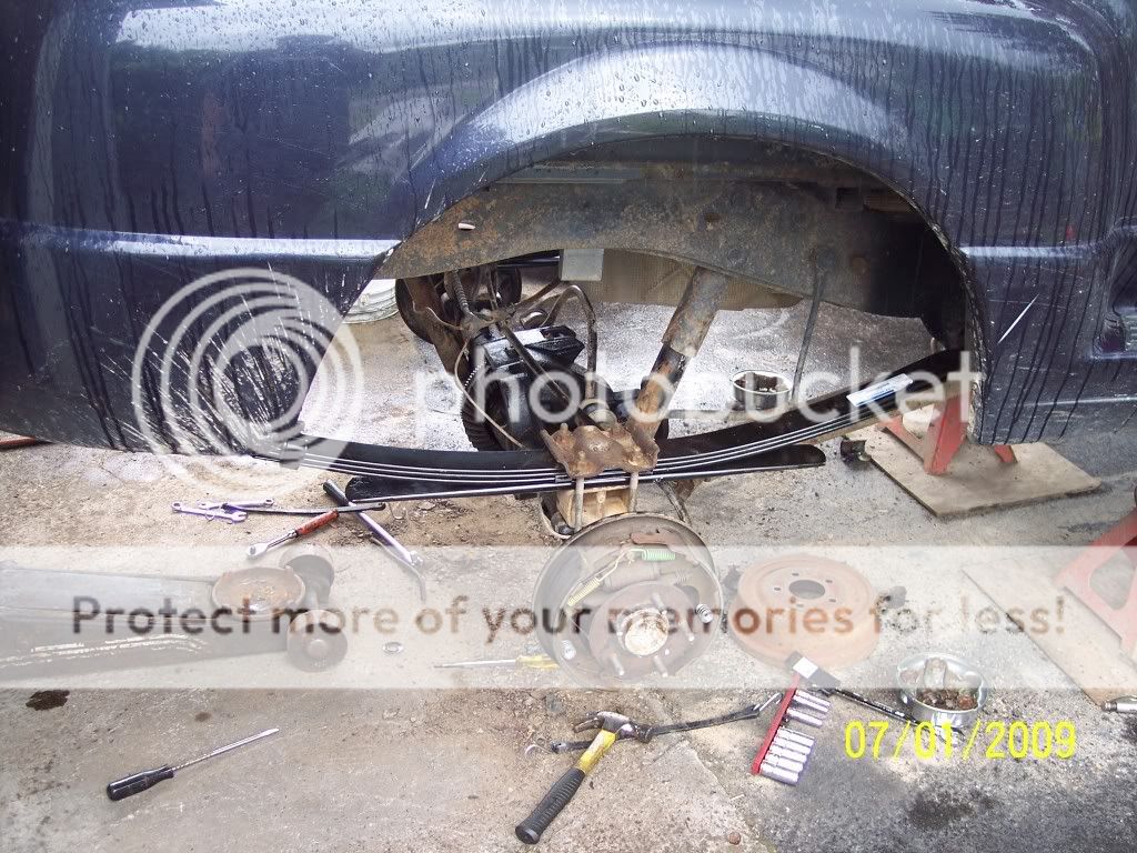

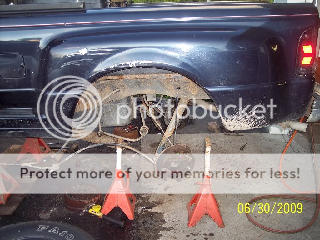

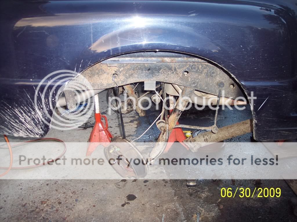

well i spent the last 3 hours pulling my rear axle out , got it out and proceeding to remove the leaf springs , will post more pics up tonight
posted new pics , i installed my first shackle mount and belltech shackle and..............i have to remove my exhaust i think , it looks like when i put everything back in it will hit , if anyone has the 6400 shackles installed , can you please post a pic of what the look like when they are in

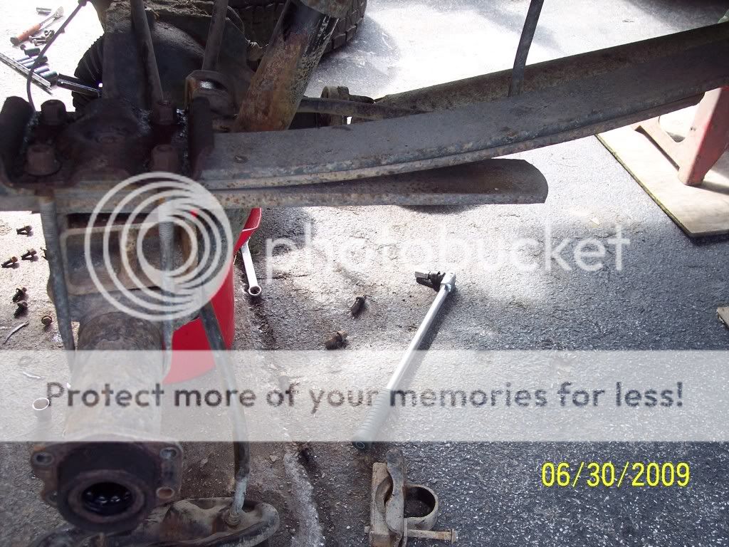

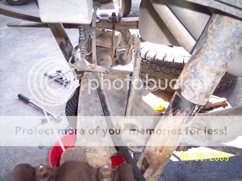

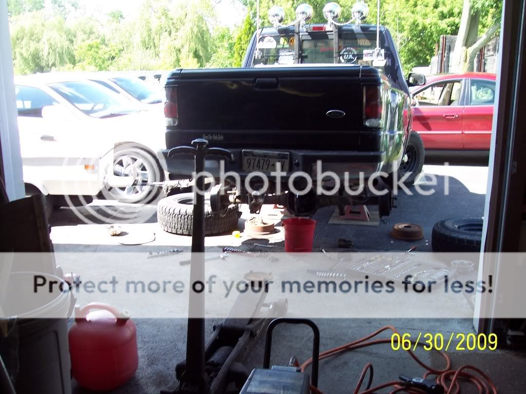

disconnecting everything

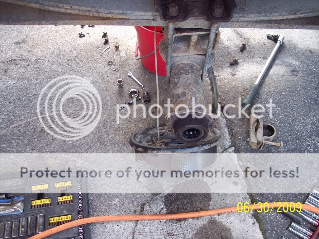

axle out

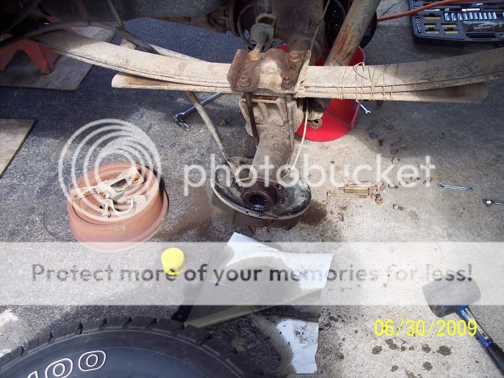

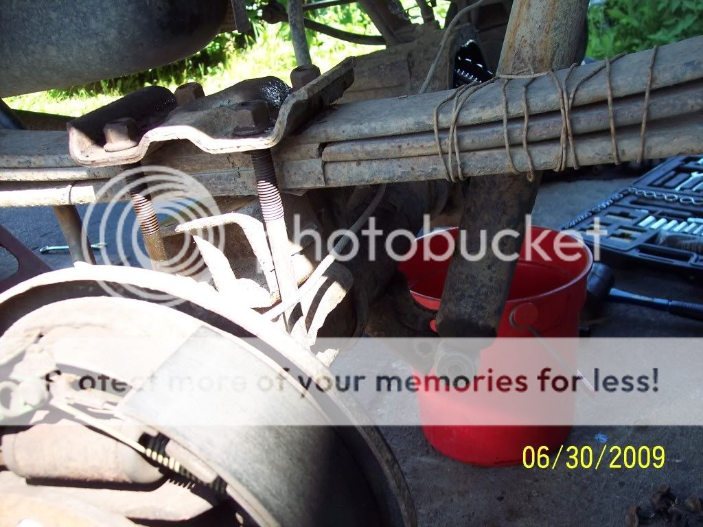

count the leaves

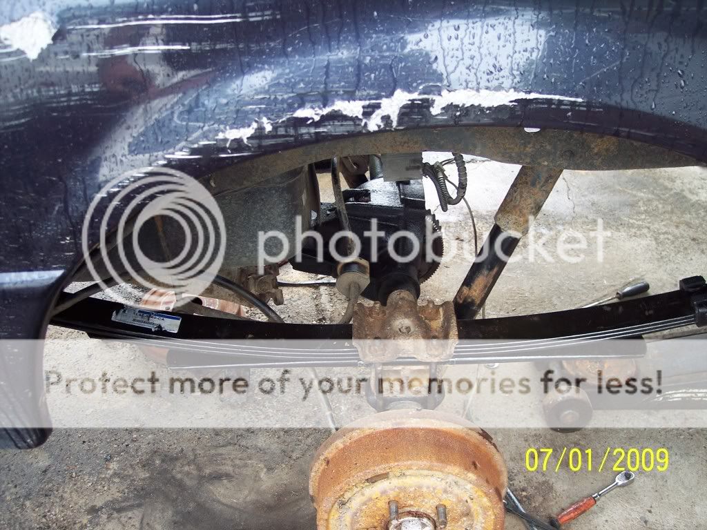

driver side leaf and rear axle

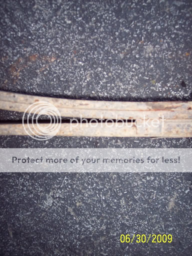

broken shackle , explains why the driver side rear was sagging

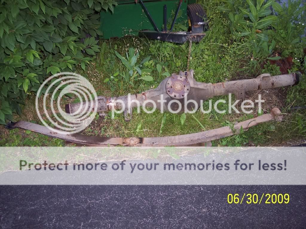

all out

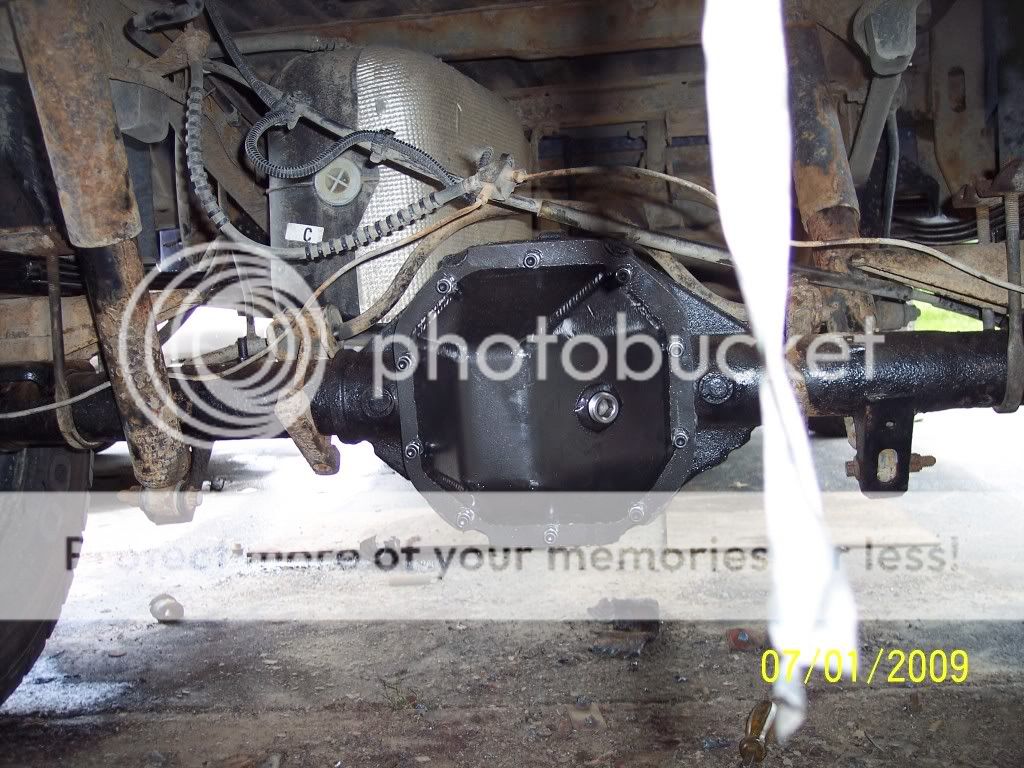

the differential

well i got it all together today , took it for a spin , engaged the 4wd and guess what.................the truck started jerking and bucking and the tires were screeching against the pavement , the guy sold me an axle with the wrong F***ING gears , so now i have 3.73's in the front and something like 3.08's in the back :annoyed: :mad: :temper: :flipoff: :pissedoff: :bawling: , so now i have to buy a 3.73 ring and pinion for my rear axle , gonna try to get some of my money back to help offset the cost of the gears
