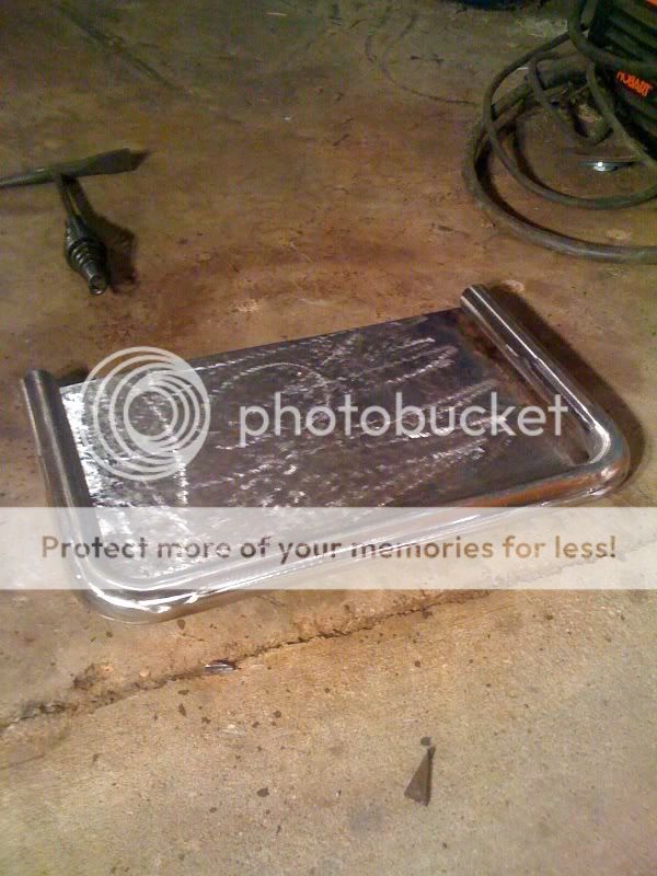

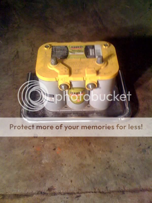

heres my battery tray i made, i also have a polished optima mount that will bolt down to this after powder coat

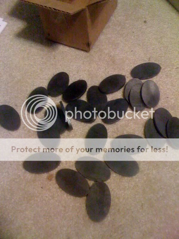

3/16" shear loqad gussets to weld over the 2x3 joints, had them made into the ford logo

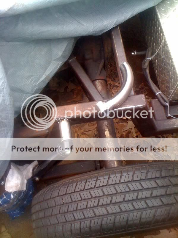

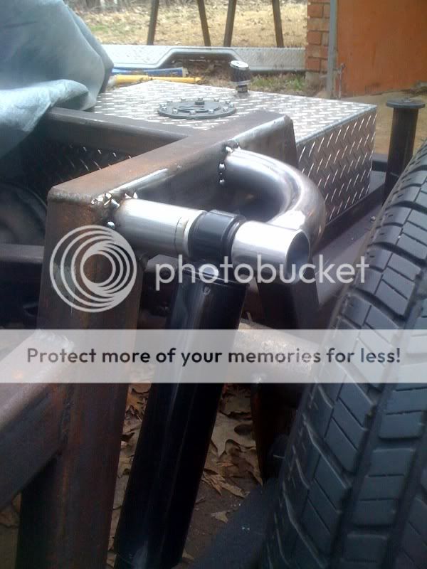

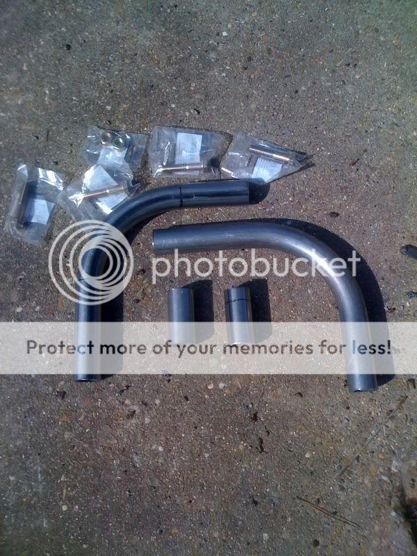

bent tubes do make me some slick shock mounts.
and this is what i turned it into :D
now the shock is straight!
i like it, i think it looks ALOT better. now i just need someone to give me a 100% for sure measurement on a 215/35R18 tire on a 7" wheel. i have 1.5" of clearance right there. :(

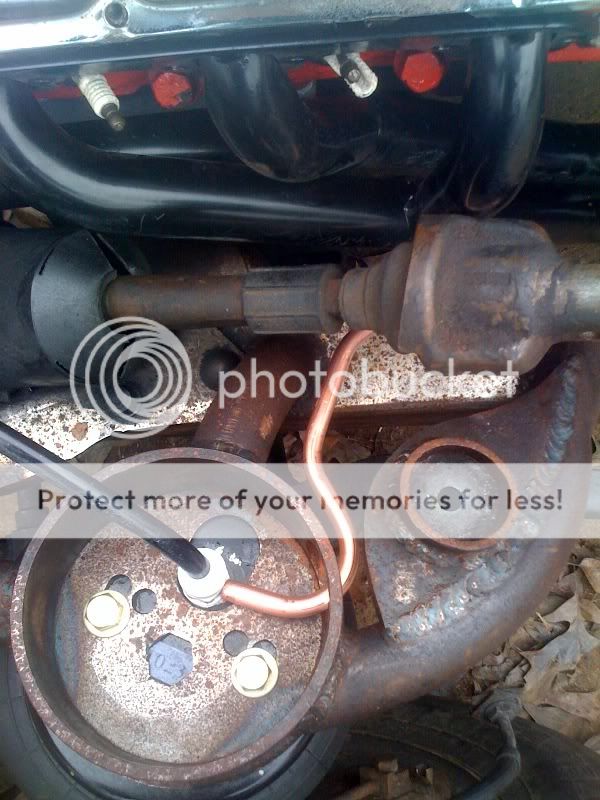

Is it common to use soft copper for hard lines? I have heard when copper (any thing from copper tubing to solid wire) is used in a automotive application it becomes very brittle due to the vibrations, so it cracks really easy. It happens fast enough that most experienced electricians and plumbers dont carry bulk rolls of copper tubing or wire in there vans because it will crack/break when you try to unroll it.

I would guess that is why the old car makers stop useing it and went to brass for brake lines and fuel lines, been a long time sence I seen a old car (early 1900) use copper lines.

I may be wrong but i think the copper is just for mock-up and he was going with all stainless lines and fittings?
correct. the copper is easier to bend, im using it for practice/mockup cause its ohhh idk, about $9 CHEAPER a ft? lmao
some do run copper. this is the rolled copper and not the straight pieces. the rolled is stronger but copper is brittle. its fine just as long as you clamp it to the frame enough. but it tarnishes, and doesnt look good after a while. so thats why with the Stainless Steel itll ALWAYS look good and last forever! lol, but idk wanna mess up some SS tube, cause its not cheap and NOT easy to obtain
