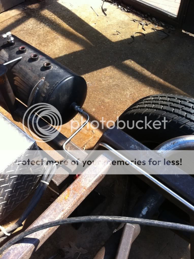

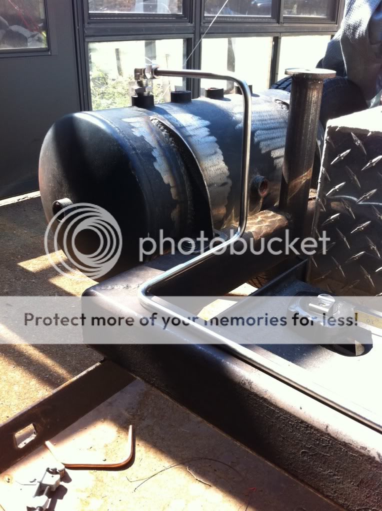

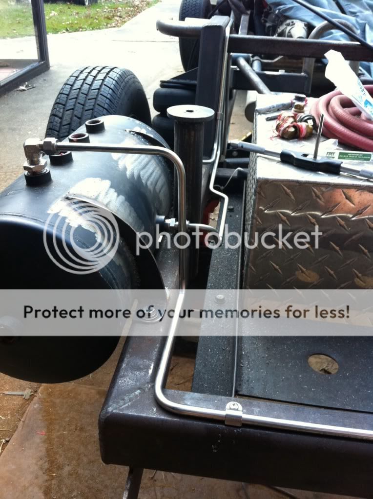

i started bending my stainless steel airlines...

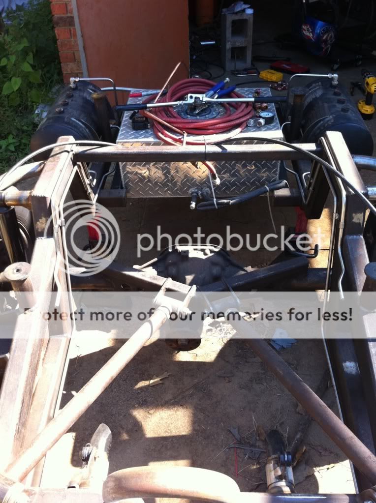

looks all messy and junky but you can see that both side are done

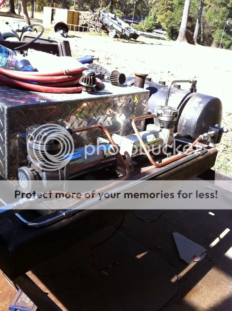

right now im trying to figure out how i want to tube in the compressors (i mock it up with copper tube before i bend it in SS)

I would use the flexible leader hose that comes with the compressor because of the vibrations.
well im going to put a clamp on the frame for that tube, but ive seen alot of compressors hardlined, but ill give it a shot, it wont be hard to change out later
Dang, That is some fine work, I like the way you mounted the air tanks.
