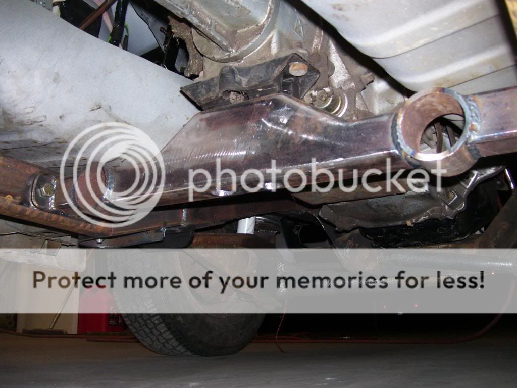

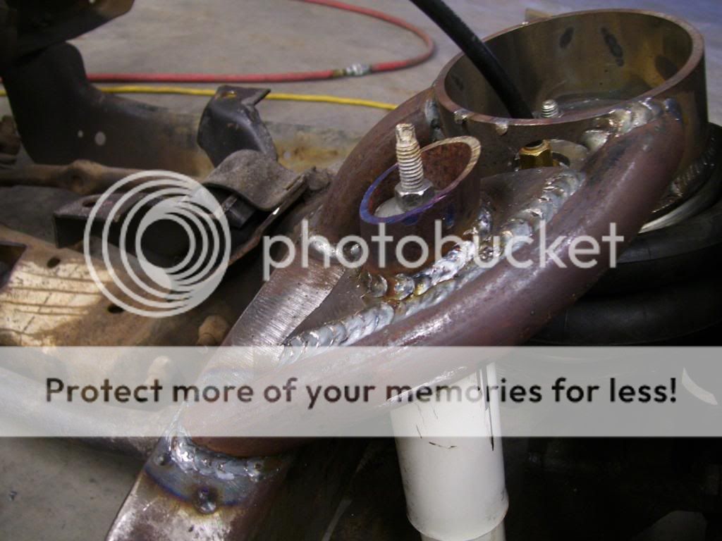

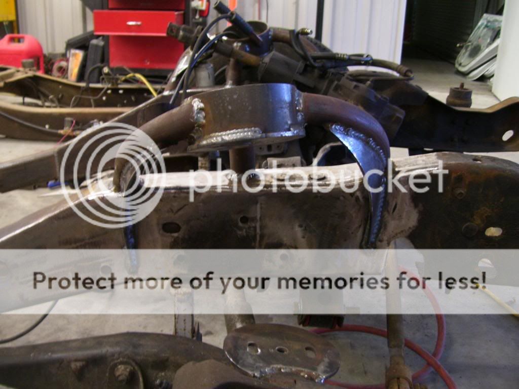

no its just been COMPLETELY re-done!
from the engine crossmember back, 2x3x1/4" steel, all new body mounts, new triangulated 4-link, motor is in, new tranny crossmember, new solid motor mounts, and i have SN95 FEAD and SN95 rear discs to put on
