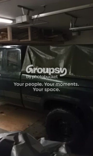

I go to a small school somewhat on the outskirts of Gresham, Oregon. So I've always had the biggest truck (hard to believe huh?) so I would always hear kids at school be like "He's the kid with the lifted truck" and stuff like that. And for a while I just left my truck how it was. But I never got the feeling it was rugged enough (probably because I don't have a Dana 44 yet...) Then I heard that one of my friends was selling a soft top made out of an old canvas army tent cover. I immediately called him up and bought it off of him for a whopping 80 bucks.
Finally my truck was complete for the time being... Or was it?

Nice truck! I like that canopy top. That about doin it to move so we have some place to sleep or store stuff when it rains.any better pics of it?
Here's some more pics of the canopy:
There are two velcro "hiding spots". One on the outside
(You can see the wood two ba furr frame that the canopy is made out of)
And one on the inside.
The headboard is made of ply wood or whatever that stuff is called.
The canopy is held by c claps that go under the bed rail.
I got it for camping, and when me and my buddies go up in the woods. It leaks a little if I leave it out in pouring rain all day. It's made out of a canvas army tent water proof cover.
