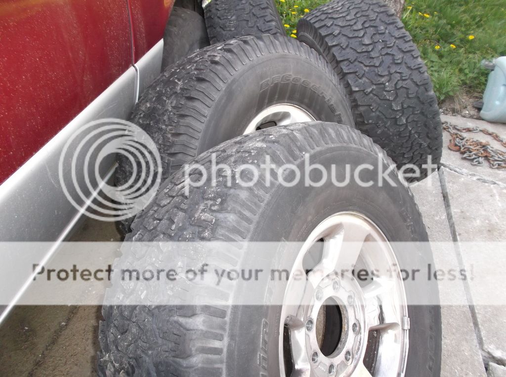

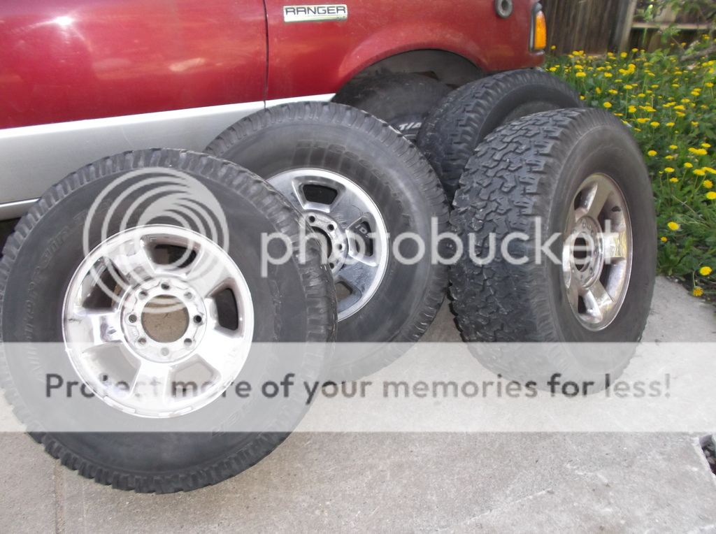

315-75R17 BFG AT's on 2001 Dodge wheels:
Some tread left:

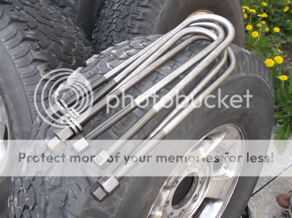

And the U bolts from Dendoff spring:

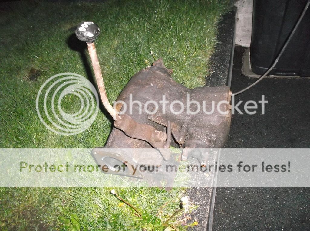

Edit. Should be picking up a NP 205 this weekend for $50. Bulletproof transfer case? Check.
$50?! Nice score! I just threw a seals and gasket set at my 205. Be puttin the drivetrain in soon :D

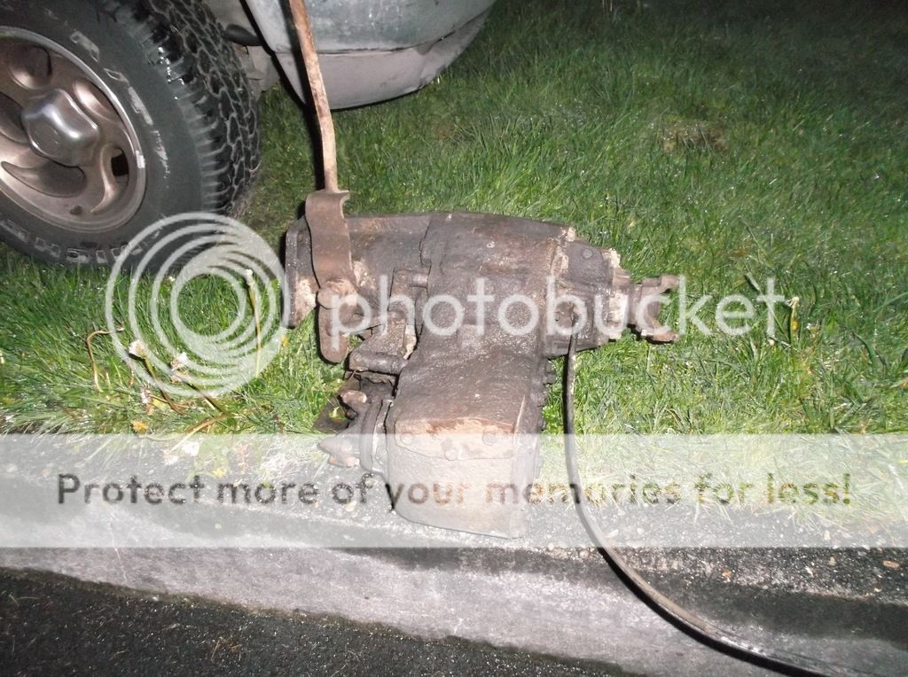

Guy just delivered it! Its greasy as hell but its all there.
Looks like he torched the front U bolts off. That might be a pain but other than that its all good. :icon_thumby:
Greasy is better than rusty! Lol. Whats that tail shaft housing from on it?
It was off of a T-18 4 speed. 75 F150. I'm not too sure what I'll need yet.
If the weather holds off a bit today I'll degrease it before I do much else.

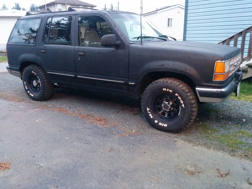

you want a 351 into er? I want to put one in my 92 explorer, after puttin my current big windsor in my ranger of course lol. i'm all about the big windsors :headbang:
this is my slpoder with new tires rims and center caps
Don't get me wrong, I like the 5.0 in my sploder. But I don't love the sploder. My dd >
