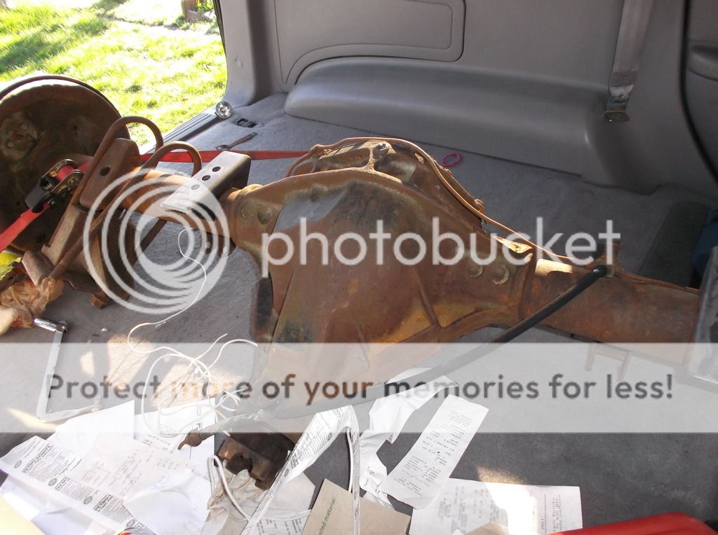

Damn. I was excited by this. A Dana 60 HD. Then I ran the BOM.

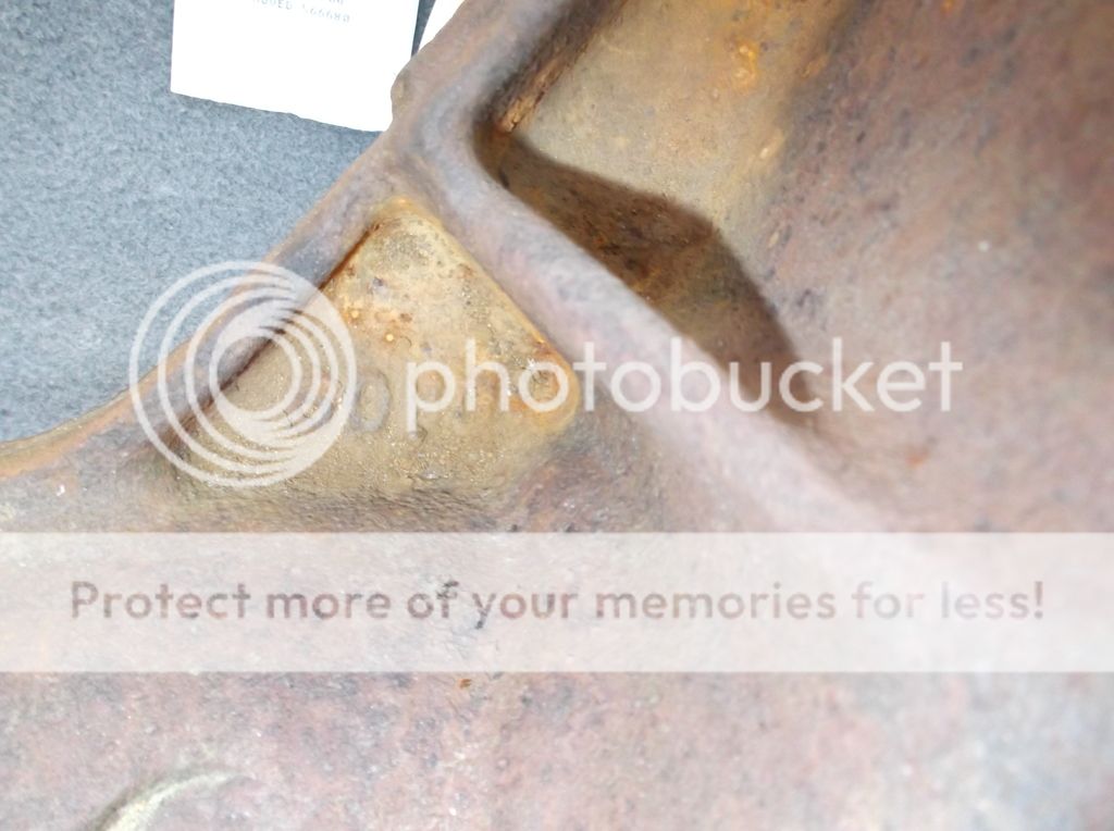

603382.
DANA 60 REAR
Year 1973
Make FORD
Model F250 3/4 Ton 4X4 Pick-up w/ Full-Float Axle
Number of axle splines: 16 FULL
16 splines isn't sexy. Even if I couldn't break it, its just not supported. It has, according to the tag, 4.10s in it. Guessing open.
But I'm planning 5.38s and lockers.
I'm gonna do some research to see if there are shafts that interchange. 30 spline are fine, 35's are better. I can at least get stuff for those.

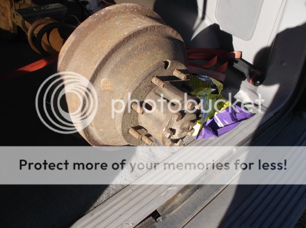

One more pic: The end.
Nevermind the garbage in the sploder. I live in there. The odometer says so.
Decided to weld that biatch up, order the thick ring gear and runner til she blows. It ain't a street truck anymore so on road manners aren't all important.

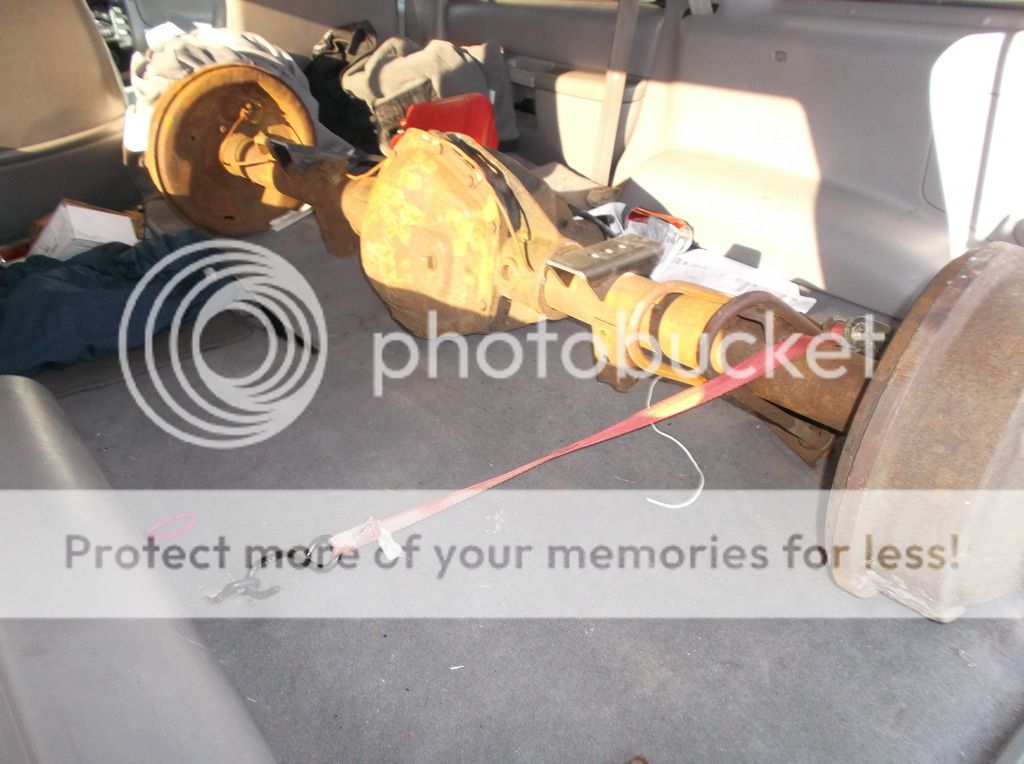

So the front axle is 70.5" wms to wms. The rear is not quite 64.
I'm thinking I'll need spacers on the rear...
:dunno:
That's a big difference. What were they each out of?
Rear is a 73 - 75 1/2 Ford F250 Dana 60 HD Full float.
Front is a Dodge 2000 or 2001, 2500 or 3500 (same BOM both years, 3/4 & 1 ton models) Dana 60 LP CAD.
I'm leaning towards 2" spacers on the back at the moment.
These are both Dana 60's people throw away. One for being coarse (16) spline - the other for being CAD (central axle disconnect, long side is a 2 piece axle with a sliding sleeve) and low pinion.
Right now, D60HP fronts run +/- $1000 in rebuildable shape locally. That CAD LP axle was $200. The cad delete chromo axles run $225 (US) each. (http://eastcoastgearsupply.com/i-19358763-dana-60-00-02-dodge-35-spline-longside-cad-delete.html) (http://eastcoastgearsupply.com/i-19359664-dana-60-00-02-dodge-35-spline-shortside-cad-delete.html)
I think this is a good tradeoff. I end up with a D60 with chromos for less than a used D60HP. Still left side drop too.
I've read that the '00-01 (and 02 without CAD) were the strongest D60's built until the Super Duty axles '05 and later came out.
