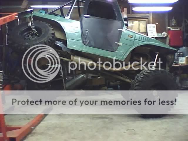

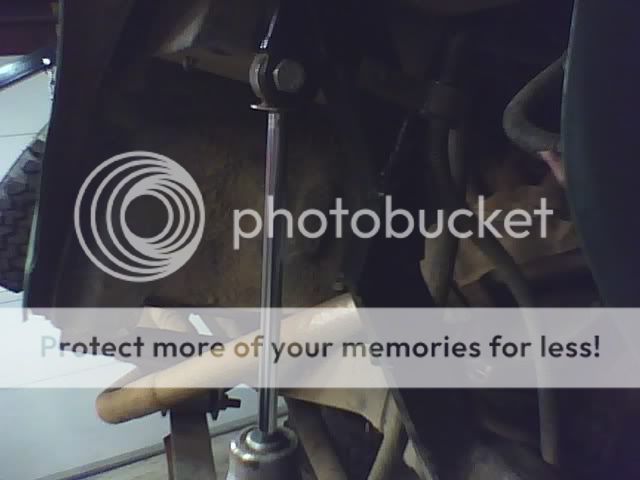

I got the drivers side mount extended today, and also lopped off the bumper just outside of the front shackle hangers, and recapped the ends.

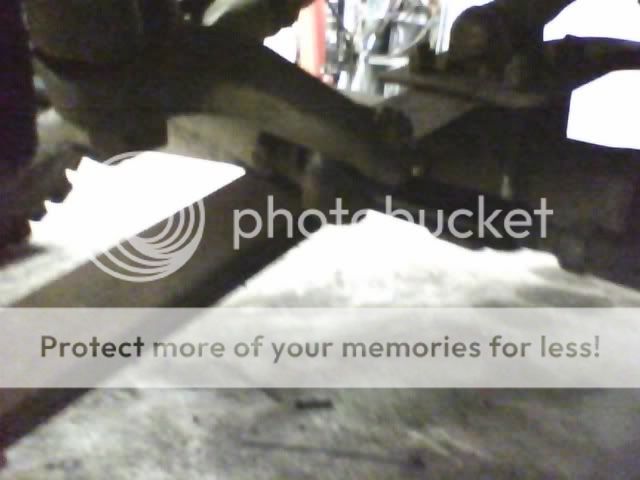

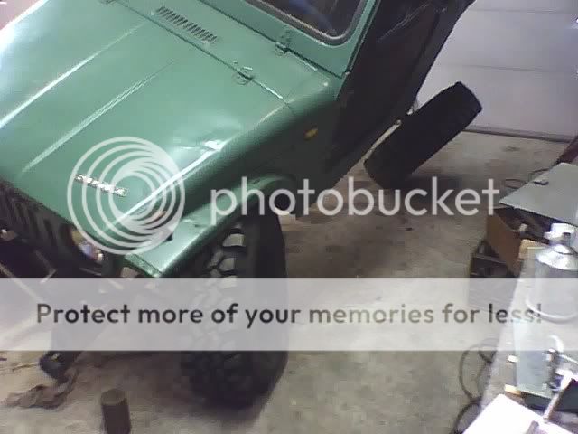

It was raining, so I did a little "garage wheeling" and flexed it out. I came up with another setback with the newfound flex. When the tires are turned to the drivers side, the draglink hits the spring at full stuff. I will be adding some bumpstops to keep this from happening, but I might also get a pitman arm with less drop to it.
The reworked shockmount

Full stuff

Draglink to spring interferance

41 inches of air under the back tire.

HAHAHAHAHA, im glad im not the only one that plans to be testing flex that way LOL
Holy crap dude, that thing is flexy! Maybe I'll see that on the trails sometime...
Yeah, looks like there is a small amout of flex there, looks good! :icon_thumby:

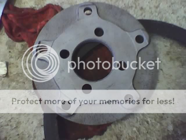

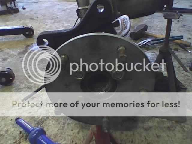

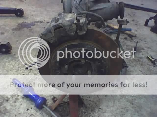

Next up is the rear disc conversion, I picked up a front axle and basically got 3 rears for free, plus another spare front longside shaft. So when I got them home, I tore down the front completely, set aside the caliper brackets, calipers, and rotors, and now I just need to get a set of the rear drums machined down into discs, which will bolt to the axle shafts, put the front studs in (longer), and the rotors will slide over those. I'll mock everything up on one of the spare rears, then when it's all ready, I'll install them on the existing rear housing.

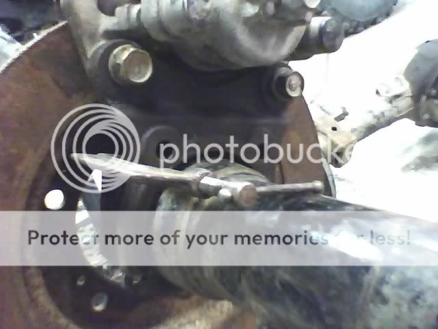

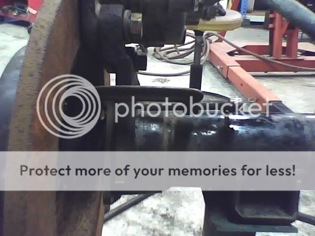

The rear disc conversion is coming right along. I got the rear drums turned down into adapter plates and got one side all mocked up. I just need to get two of the old backing plates cut down into bearing retainers, and it will be all set to move over to the zuk. I've been mocking everything up on a spare rearend, and once all the parts are made, I can swap it all over the the rearend thats on the zuk, and weld on the brackets. Then I can get the rotors turned at work, and pick up some new pads. Here's a few pics for your viewing pleasure.

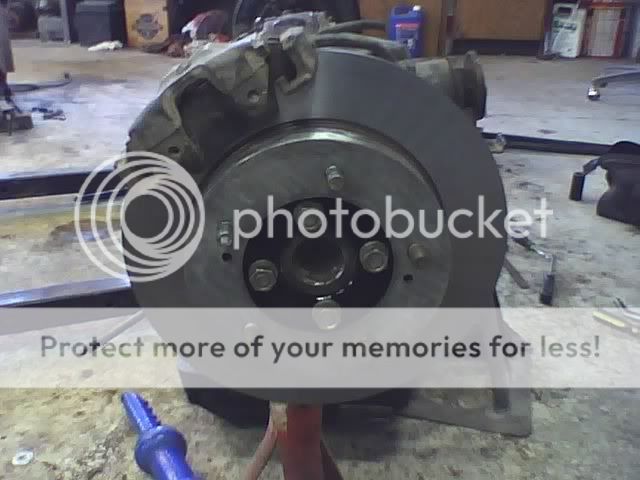

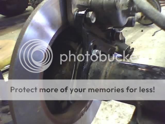

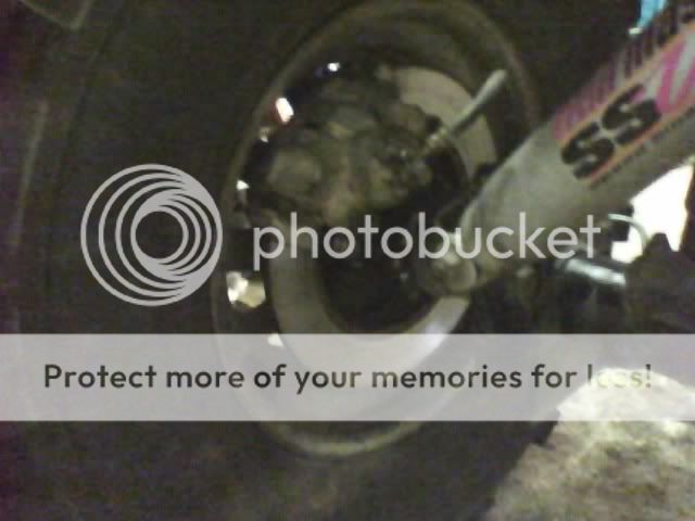

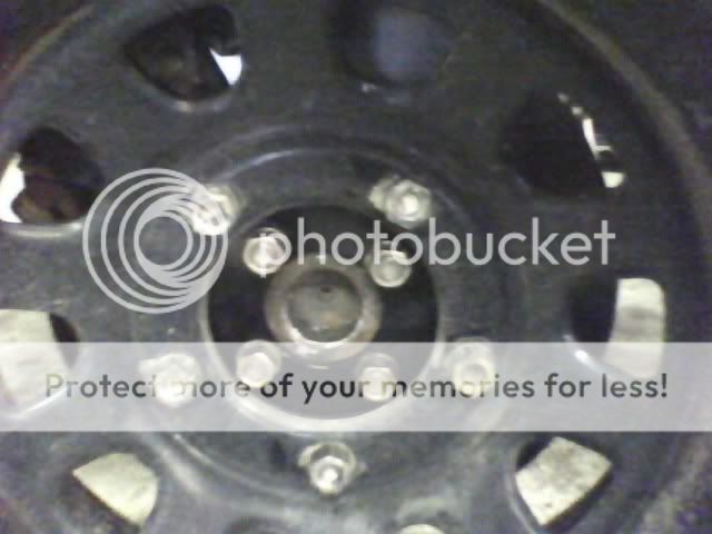

Well, I got the rear discs done tonight. Got them all installed, and bled, but I think I need to bleed them out a little more. Heres some pics.
Project Fordzuki
Project Fordzuki
Project Fordzuki
Project Fordzuki
