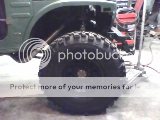

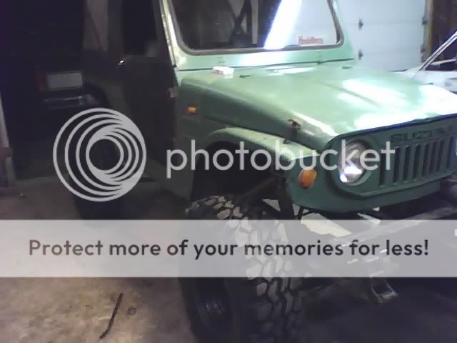

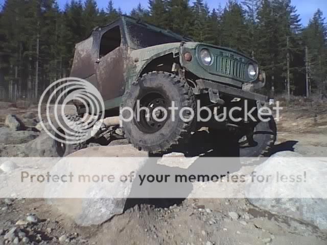

hey, you decided to poke your head in over here huh? Well, here's some pics of the new shoes.
The first night I mounted them up, 34x10.50x15 LTBs on 15x8 black rockcrawlers with 2.5 BS

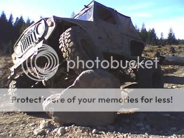

And trying them out down at Tahuya last sunday.

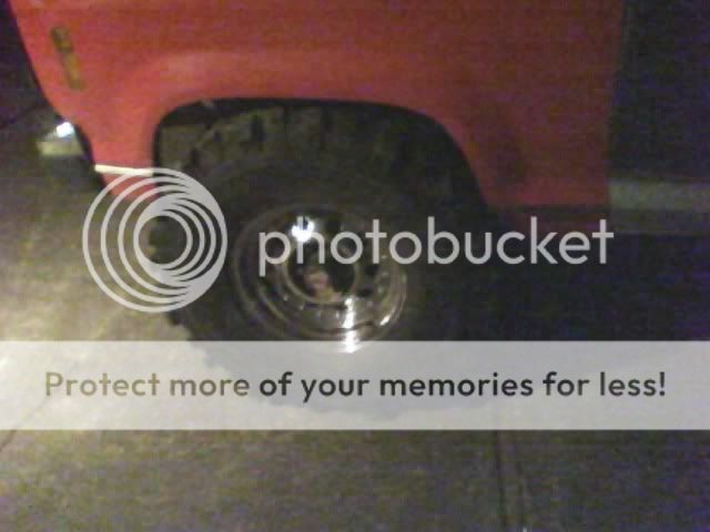

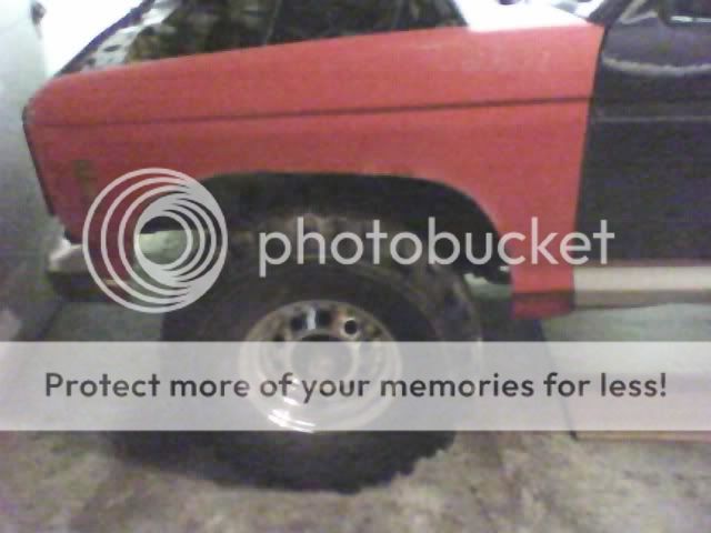

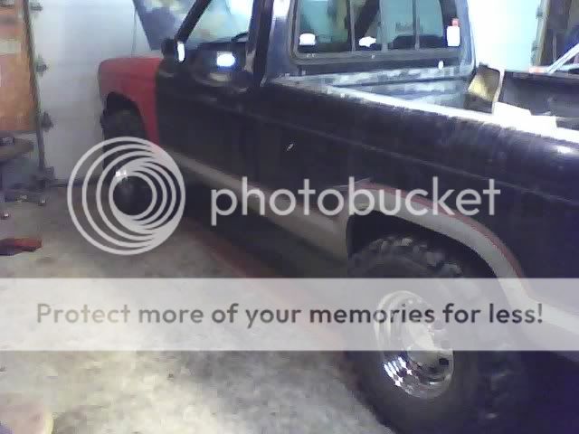

And the old 33x12.50x15 tsls got a new home on my dads ranger, still have to do some "minor fender trimming" to the bedsides.
Stock height, no lift
"Minor fender trimming"

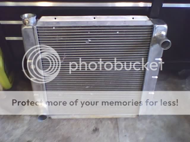

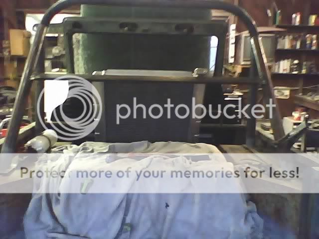

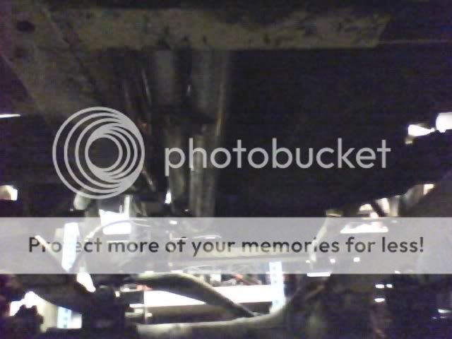

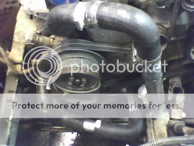

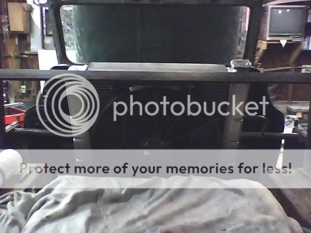

Well, the latest project on Fordzuki was to address the cooling system. It did fine most of the time, running around on the trails up at Evans Creek, but out on the logging roads and at Tahuya, it would get a little warm from time to time. My guess was the Datsun radiator I had in it had a few clogged tubes, so I started looking around for something aluminum, and came up with a good one at the 4x4 swapmeet, a 19x22" Northern aluminum racing radiator for a little less than half price, and still in new condition. When I picked it up, I thought I could do a little more plasma massaging to the front sheetmetal and fit it in there, but to no avail. It was too wide to fit between the framerails, and because of this, stood about 3 inches too tall to get the hood shut. So this made the decision I had been thinking about for awhile now, and that was remote mounting the radiator in the back. This solved two problems, one being keeping the motor cool, and the second being not having a heater. So I basically started by welding in a crossbar between the rollbar for the top mount, and bolting in a crossbar between the rear wheeltubs for the bottom mount. I got the radiator mounted up, and started dreaming up the plumbing for it.
For plumbing, I went down to the parts store, and got 2 ten foot sticks of 1.5" exhaust tubing, 4 random radiator hoses with a bunch of bends in them, 24 hose clamps, and an adapter from 1.5" to 1.25" for the upper hose on the motor. For the smaller degree bends, I used the pipe bender, and for anything over a 15 degree bend, I cut bends out of the radiator hoses, and clamped the pieces together. When all was routed and clamped, I took some 3/16" by 1" steel strap, and cut pieces to both attach the 2 tubes together, and to attach the both tubes to the frame. After double checking all the clamps, I vaccumed the system with my air evacuator, and checked that it held vaccum. It held 25 psi, so I then filled the system, and it took almost 5 gallons of 50/50 mix to fill it up. I mounted my 16" e-fan up as a puller, and wired it back to the original relay I had for the front fan. With the fan not running, the temp gets up to about 165 degrees after running at 2500 rpm for about 15-20 minutes. With the fan running at all times, I can't get the temp guage to register, which it starts out at 100 degrees. So this definately will keep the thing cool during even the hottest summer months, and when I get a little more time, I'm going to wire up a thermostatic switch to control the fan.

I got my thermostat switch for the fan wired in today, and it seems to work pretty well, though the band seems to be a little wide on it, turning on at 170 and turning off at 130. I might have to play around with it a little more on the first trail test, which should be next weekend, more than likely up at Elbe hills.
