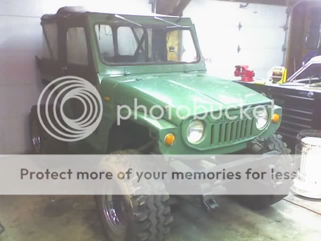

Got a grill in it finally. Took some horse trading with a guy from New Mexico to find one, but I finally got it.
Project Fordzuki
That is sweet

Great looking truck, nice work.
This thing has turned out to be a BEAST! Nice work, and awesome job keeping it looking somewhat stock on the outside. I like the fart-cannon idea. They don't take up much for space, even though they are kinda irritating on a little ricer car.
Thanks, I'm thinking about cutting the coffee can off, for one it's helaciously loud, but doesn't sound anything like a honda, and two, it's not FS aproved, as it's a straight through design. For the winter months it's not bad, but when it starts getting dryer out, I'm sure I'd have the FS on my arse about it.
