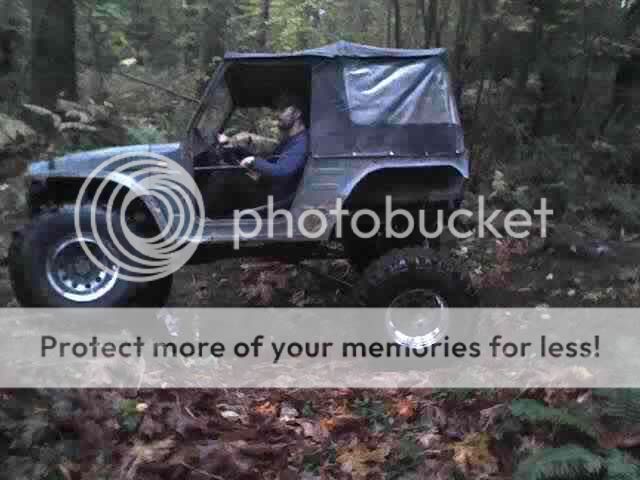

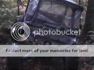

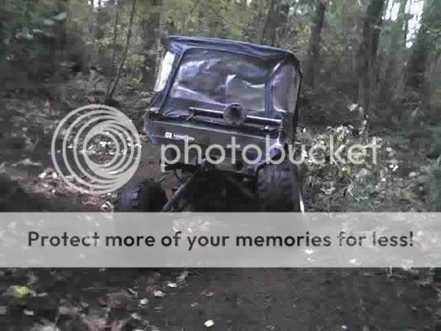

Here's some wheeling pics from last saturday, plus a couple short vids.
Thanks man! Your ride is looking good. Where you located? That area looks familiar. If you're in Central Oregon, wanna do some wheeling sometime?
I'm up in washington, near Tacoma. The wheeling pics are from a buddies back woods, we dug out a couple trails and mudholes back there, and use it for sort of a test area.
