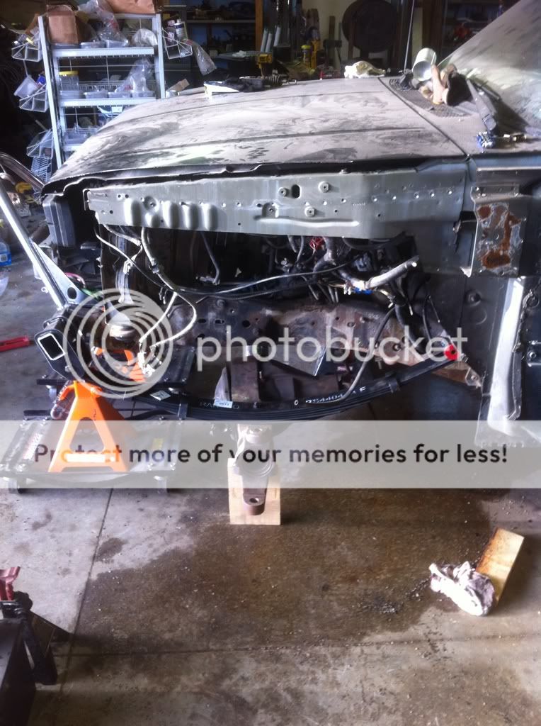

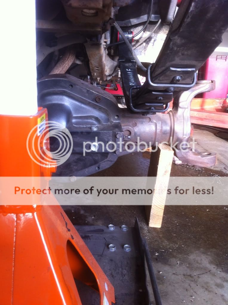

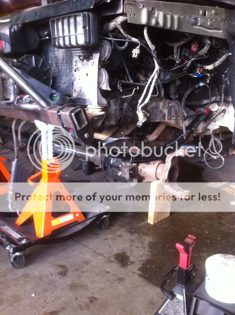

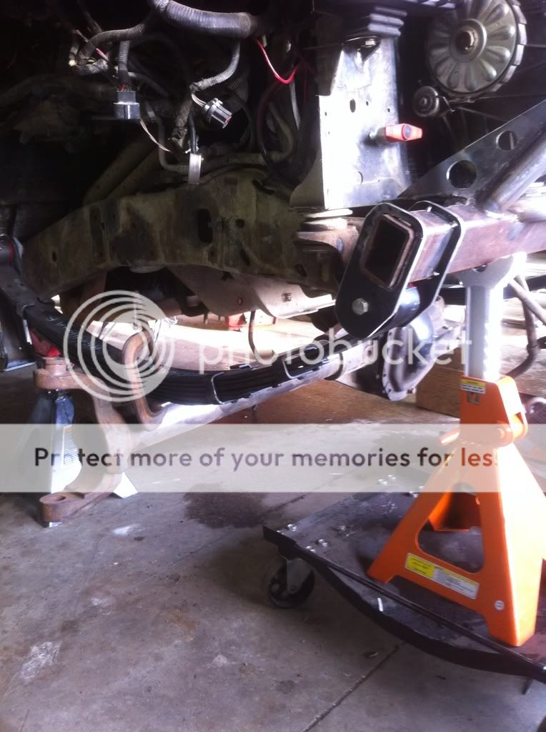

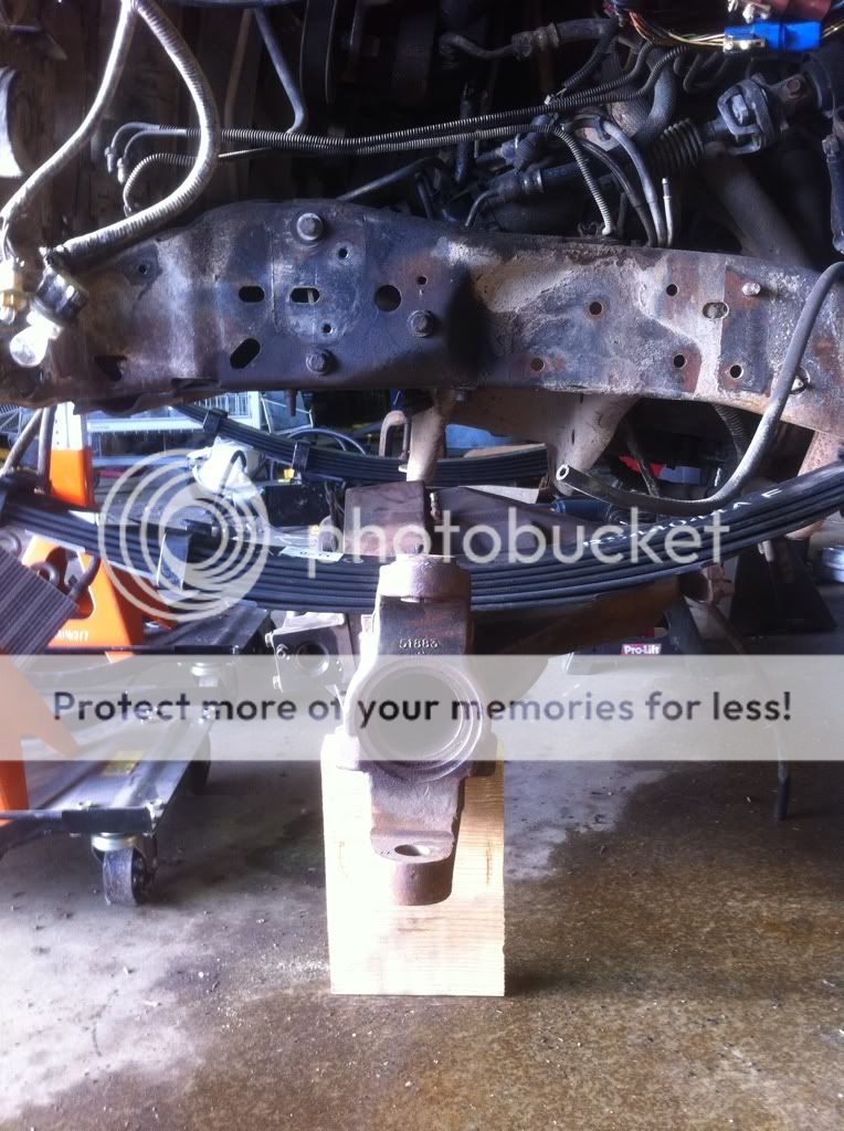

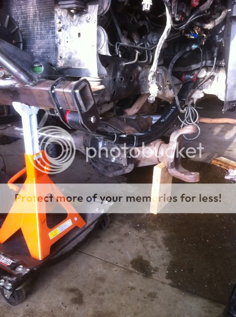

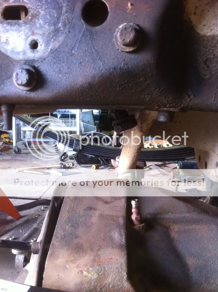

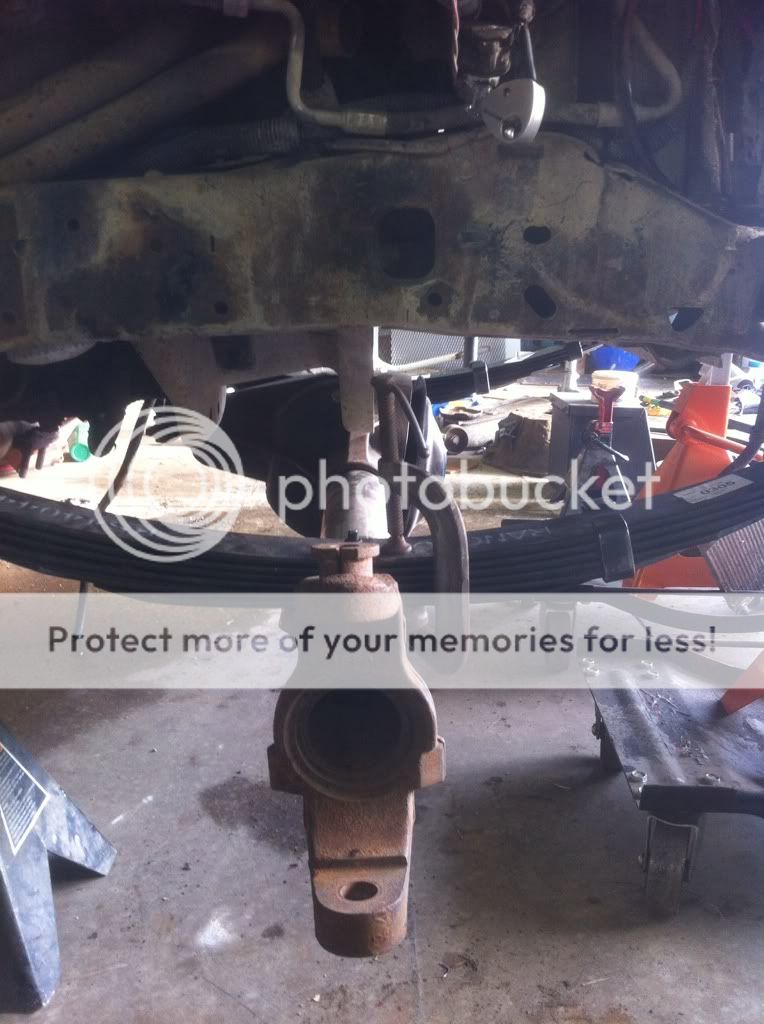

I'm out here right now working on the front spring hangers.
Oh and I got some seat time in the truck making some noises and banging some gears playing with shifter location and height.
I think this will be just about where it ends up.

Things are going to be tight, the SD 60 is going to make it a pain in the ass. But I'll figure it out.
Wheelbase is going to a lot longer then I expected, looks like at a minimum 123"-125".
Looks like you moved it forward quite a bit. How much did it go, 6 inches? Mine ended up at 5 inches forward. I'm sitting at 131" right now, but I haven't moved the rear up yet....
SVT
You'll like the approach, but turns are gonna suck. I didn't move mine. I think Greg moved his like an inch or two, but I plan to push the rear back.
Front is 5.5 forward, rear is going to end up around 6" back
My front is 2" forward but 111" WB. Went wheeling with 2 126" WB 4 door toyotas a few weeks ago and they didn't have any problems.
mine is 4" forward....making me 130".....
but, as soon as I pick up my doubler I am going to make both front and rear driveshafts the same length so I only need 1 spare.....so I will soon see how much I can shorten mine.....
