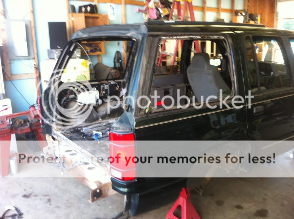

i got the rest of the back area ready to cut, getting ancy about cutting it but i need to do some searching and figure out all my cut lines first. the least body work the better.
will get some pics up after dinner.

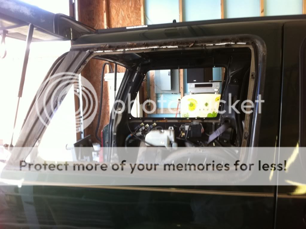

whats not pictured is i stripped all the wiring out of the back and got it out of the way and also pulled the roof rails so i can cut.
need to do a little reasearch to see where the roof needs to get cut and i have a few idea's for the bed rails.

Whats the plans for the fuel tank??
SVT
Lol gotta stay away from the beer when the plasma is ready to go :thefinger: didn't you see the ranger? Sheet metal just seems to disappear :D
Thinking about a fuel cell or some other tank under the back.
Jon, you may want to throw the back seat in to make sure you have clearance for it....
gonna look good:icon_thumby:
