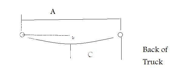

I got those measurments for you on the wagoneer leafs:
All measurments are approximate...
A = 46.5" (Distance Eye to eye with the trucks weight on them)
b = ~1.5" (Distance between the top of the leaf, to the Eye to Eye centerline).
C = 23.25" (Rear eye to pin, the pin is pretty much dead center of the leaf pack).
These leafs are sitting nearly flat, there is a slight arch to them still and I don't really expect them to flatten out any more than what they are currently.
For grins, I checked the stock 7 leaf pack, and those too have the pin in the center.

thanks, that knocks out the waggies for me. i need something around 22" from the pin to front eye so i can pull my hangers back and up where they dont hang out so much.
looks like its the yota leafs then....now to find a set

No problem. You've probably looked at the Yota's more than I have, but will they be able to hold up enough weight? Those yota's tend to be faril light (4k or less), so I'd worry about flattening out those leafs.
It may be a non issue, but probably something you want to make sure of before slapping down the cash on a set.
im not sure, nmb2 seems to run them with some success. if i have to im not against running a bastard pack to make it work.
from looking at the link you posted the 44044's are the perfect dimensions but its hard to shell out that much coin for some.
Rancho 44044: 2.5in lift 76-92Wagoneer 7 leafs,
About 8in lift if used on an XJ front SOA.
76-92 Wagoneer Rancho 44044 47.00 22.9" 20.8" 2.50" SUA
300#sq/in
Free Arch: 8.45" @ pin
1.68in leaf pack thickness, 10.13in from pad to eye height.
Eye to eye (not following the spring): 43.64
Eye to eye (following arch): about 48in
2.5in of lift over stock YJ leafs.
