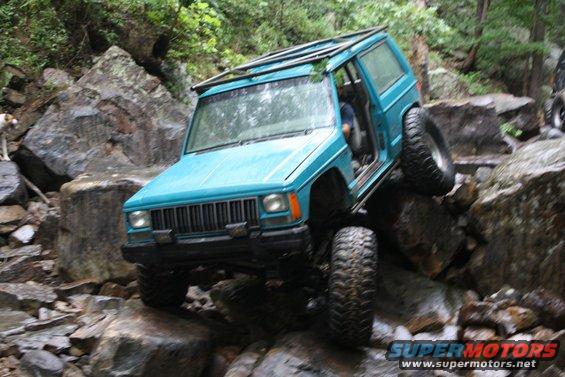

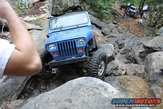

Just on that obstacle alone he inverted his shackles probably 6 times. He carries a big pry bar in his jeep so someone can pop them back over every time it happens.
I even remember him making a funny face because both of them ended up inverting over (that was fun to fix up on Blacksheep)

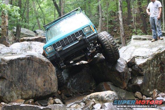

crap I forgot about this guy too. Front shackles.

Hard to see in this pic, but you can't even see a glimmer of the leaf bolt on the pass side, and the shackle is clearly not in the position it should be. Leaf completely bent into a 90* and then actually broke IIRC.
project family wheeler. chop top 1 ton explorer.
and yes I understand that is a straight vertical 40"+ rock and a lot of load on a leaf spring, but it would not affect a rear shackled setup.
Same obstacle.
