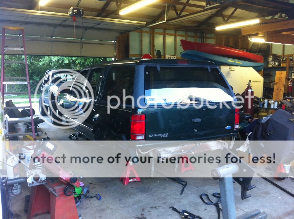

Good news, the expo is in the garage. Wasn't an easy process and I deffinantly rigged it togather to say the least lol. But it's in there now that's all that matters.
Will be starting on the top next week.

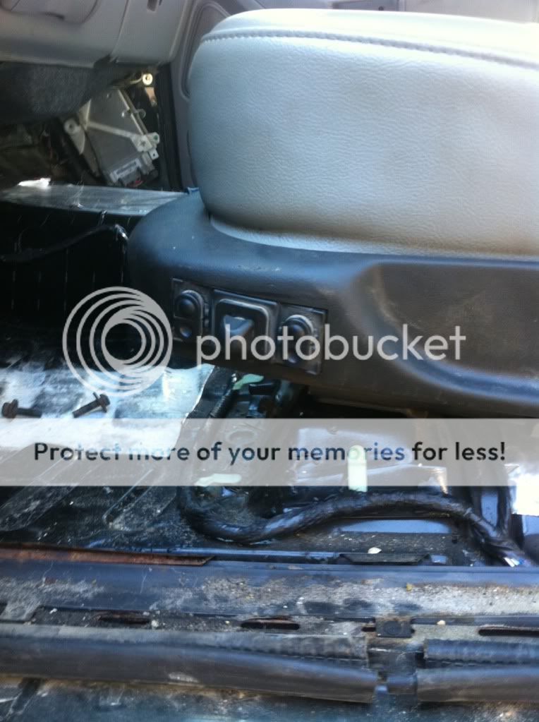

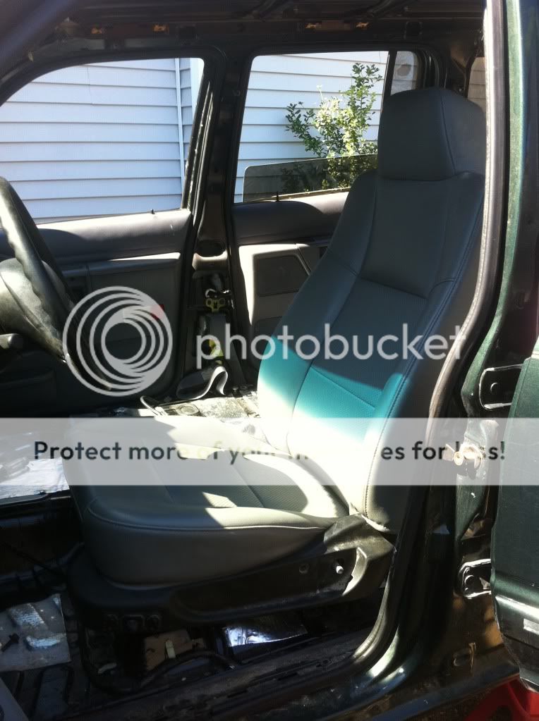

alright, first i finished the driver seat, gotta have something to throw in so i can make motor sounds and pretend to grab gears...

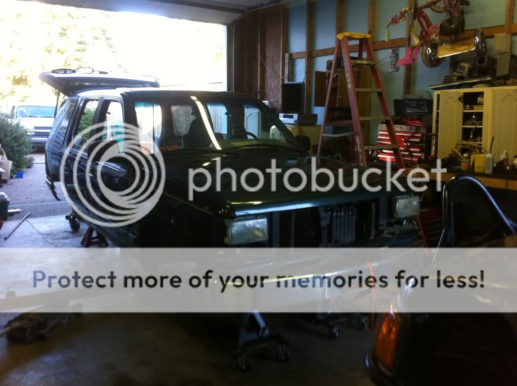

and then i got ancy and decided i was getting this bitch inside.

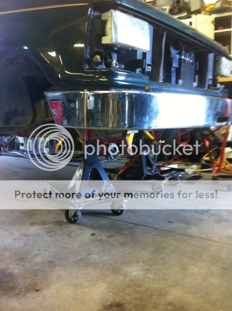

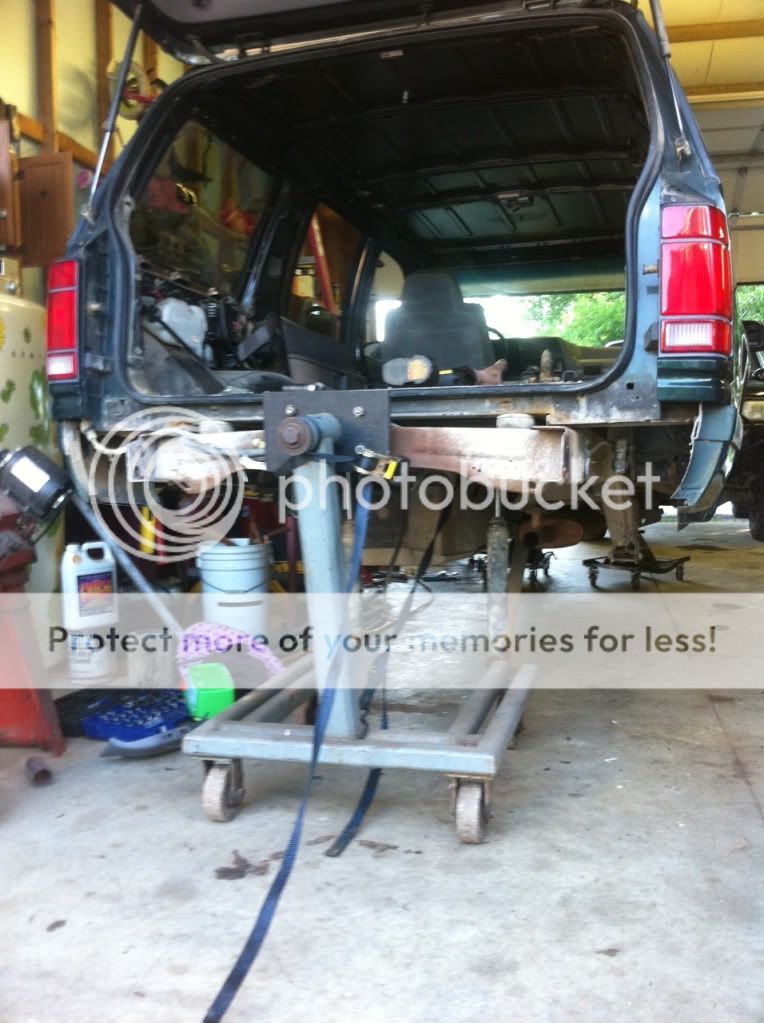

got the car skates under the front and strapped them down then the rear all i could find that was big enough to set the weight on was my dads old massive engine stand. used to hold fully dressed big blocks for months on end so i knew it was stout enough to hold the weight. jacked it up slid it under strapped it in and hooked the winch up.

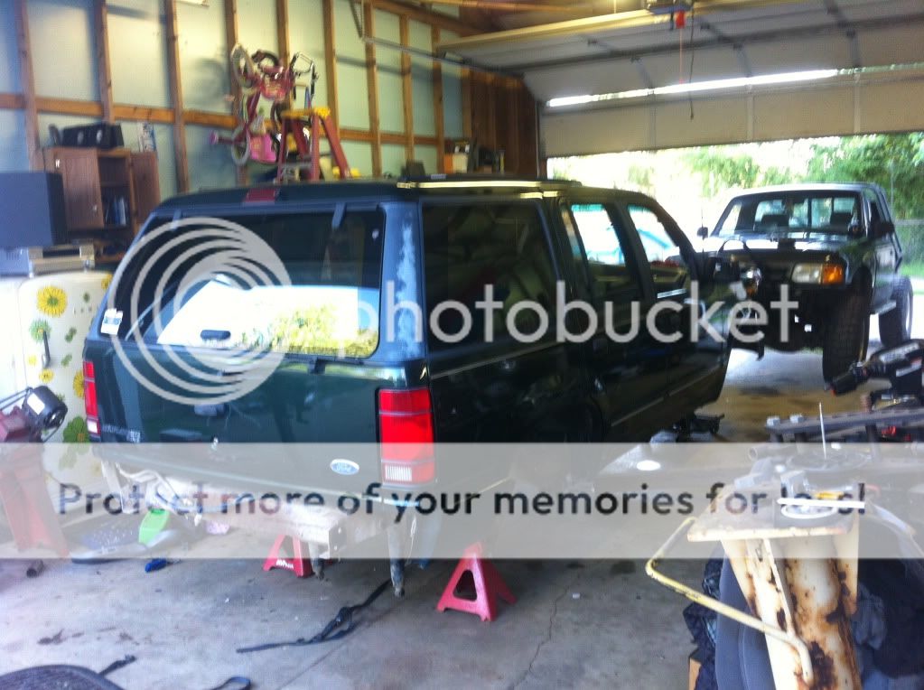

rolled right in without problems.
